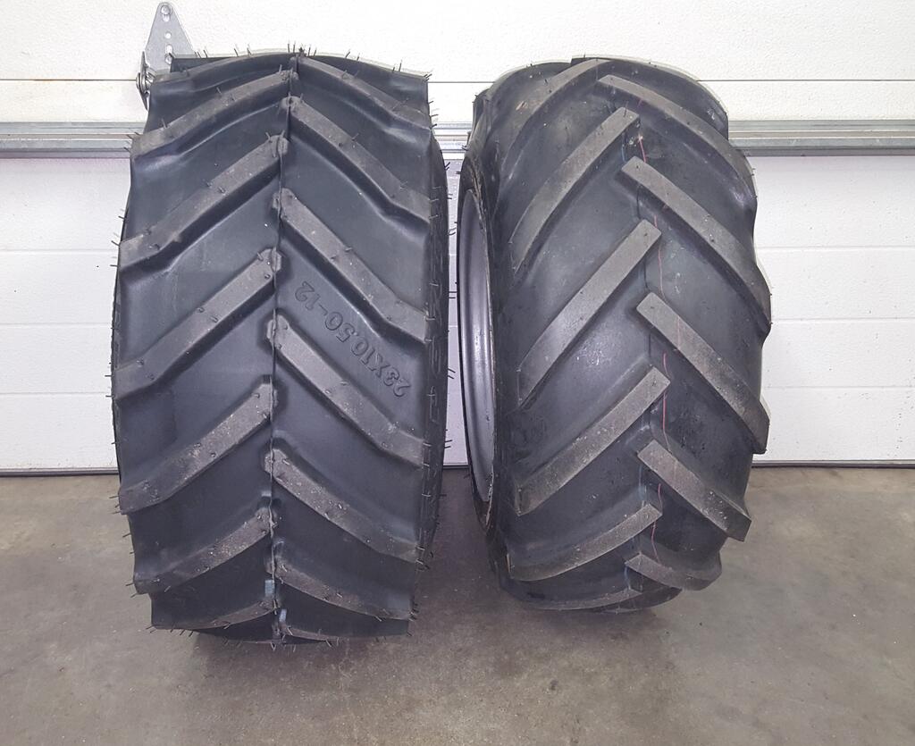

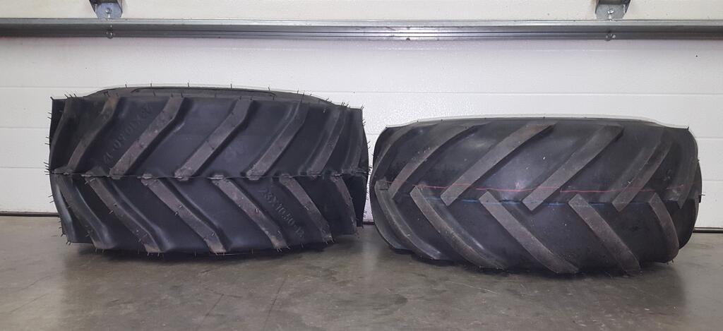

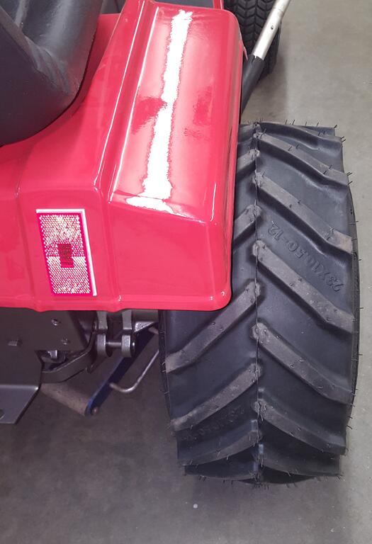

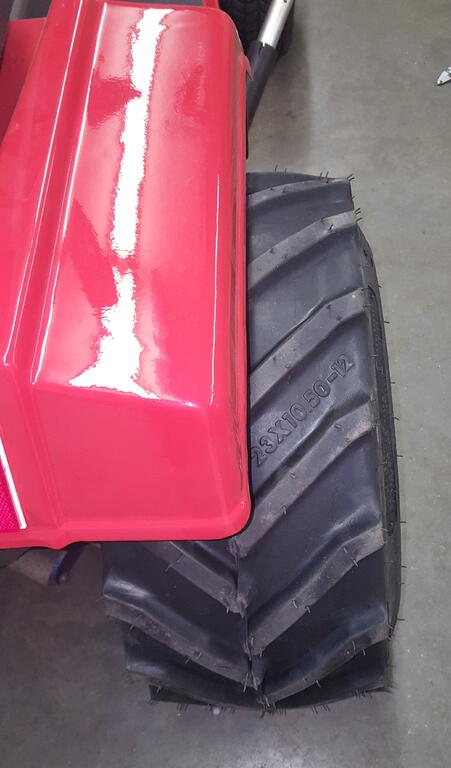

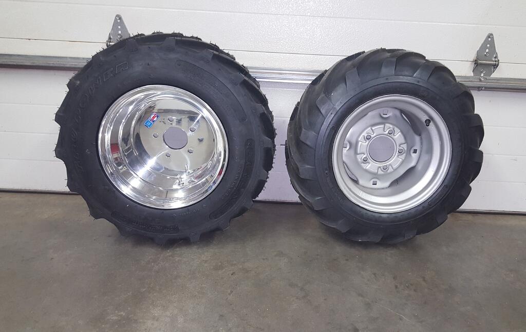

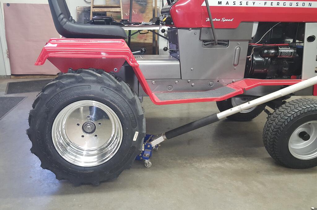

Gregor 4,847 #1 Posted April 1, 2021 We compared 2 14 HP tractors. So let's compare 2 tires. The tire on the left Carlisle Tru Power 23X10.50-12 $125 Tire on the right Deestone Super Extra Grip 23X10.50-12 $90 Supposedly the same size. It's my understanding, the numbers mean this; 23, Height of tire. 10.50, Width of tire. 12, Wheel size If I am wrong, please correct me. I often am. The tire on the left, is 23" high. Right, 22 1/2". Not a big difference. The width of tire on the left is, 11". Right, 9.5". Big difference I don't know the actual measurement of the rims. The tire on the left is more what I was expecting, when I ordered the tires on the right. But it is what it is. Now I know. Of course I had to set one of the aluminum wheels up next to the Massey.As you can see, I have plenty of room for a 26" tire. With the tire on, using the 4" back set, it sticks out too far for my liking. Turn it around, 8" back set. Much better, and there is plenty of clearance. On both sides even. The center hub on the Massey, is larger than the Wheel Horse, and larger than what's in the rim. A 1/4" or 1/2" spacer on each lug bolt would take care of that. Personally, I would have thought tire sizing would have been more standardized. If a tire says it's 23X10.50-12, That tire should be, 23X10.50-12 2 2 Share this post Link to post Share on other sites
pfrederi 20,234 #2 Posted April 1, 2021 It has been frequently mentioned on here Deestones run small!!! 1 Share this post Link to post Share on other sites
c-series don 11,797 #3 Posted April 2, 2021 I have Carlisle 23x10.50 12’s and then bought the other brand for another tractor and the difference was unbelievable, the tractor sat low in the rear. They are still on there but I wish I had spent the additional money and got another set of Carlisle tires Share this post Link to post Share on other sites
cschannuth 3,821 #4 Posted April 2, 2021 I use 10.50 Deestones on 7” wide wheels and 10.50 Carlyle’s on 8.5” 520 wheels. 1 Share this post Link to post Share on other sites

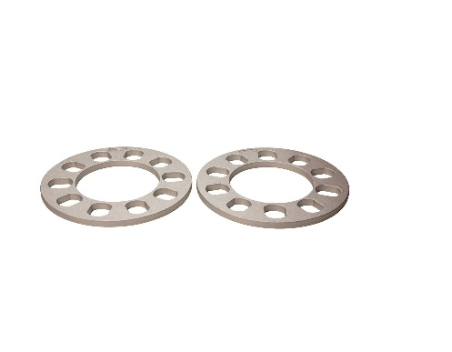

8ntruck 8,754 #6 Posted April 2, 2021 If you are going to use spacers, you should use a spacer that supports the whole mounting surface of the wheel, not just the area around the studs. You are more likely to have cracks start in the mounting surface around the bolt holes with small spacers around the studs - espically in aluminum wheels. 2 1 Share this post Link to post Share on other sites
Gregor 4,847 #7 Posted April 2, 2021 9 hours ago, pfrederi said: It has been frequently mentioned on here Deestones run small!!! This is what happens when you come to the party late. 3 Share this post Link to post Share on other sites
Gregor 4,847 #8 Posted April 2, 2021 Speaking of wheel spacers, again. The center hub on my Massey is 3 1/4" The center hole in the wheels, is smaller. Obviously, I need wheel spacers. I have been advised ,more than once, not to use individual spacers on each lug bolt, due to cracking of the wheel. I can see that happening. Would these spacers cause the same problem you think? Share this post Link to post Share on other sites
