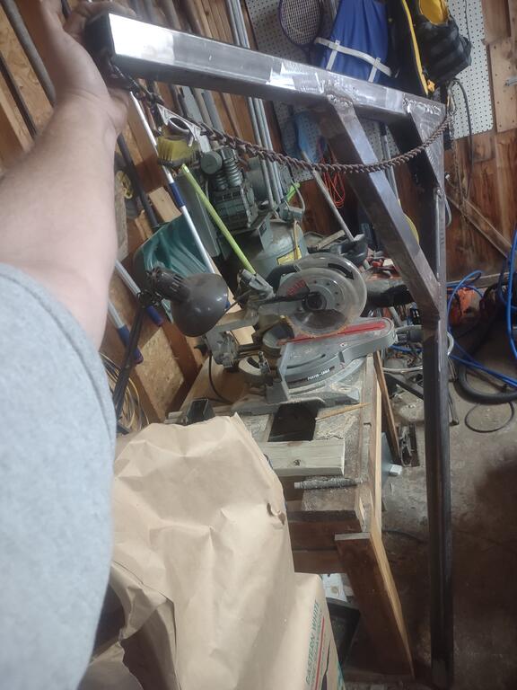

ebinmaine 80,088 #81 Posted November 1, 2022 2 hours ago, SylvanLakeWH said: Uhm... Completion pics? I tested this once using the chain that's through the top. Works excellent, though heavy. 1 Share this post Link to post Share on other sites

ebinmaine 80,088 #83 Posted January 25, 2023 6 hours ago, OutdoorEnvy said: @ebinmaine how’s this project coming Eric? Or did it get a different thread and I missed it? There are lots of great ideas in this thread though. It’s been a fun read. Much appreciated 👍 I haven't used it as a lift or pull rig since late November/early December. Some notes: As stated in the previous post of mine it is heavy. That's good for strengthness but is a bit challenging to handle of course. If I built another one I'd go thinner walls. I believe once I get the winch and cable/strap holders on it'll work great. One other possible thought is to add alternative pull options like welded on chain hooks. The hitch it's been in will need to be moved from the Cinnamon Horse 74 C160 to another tractor that has a standard height front end. Cinnamon's lifted front makes the crane tilt back too far. I'll be making up another hitch for that tractor too, accounting for the tilt. 1 Share this post Link to post Share on other sites

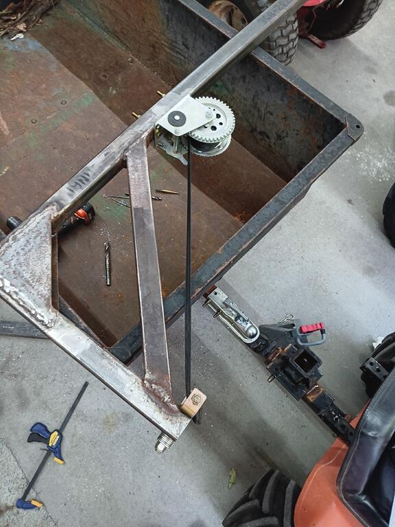

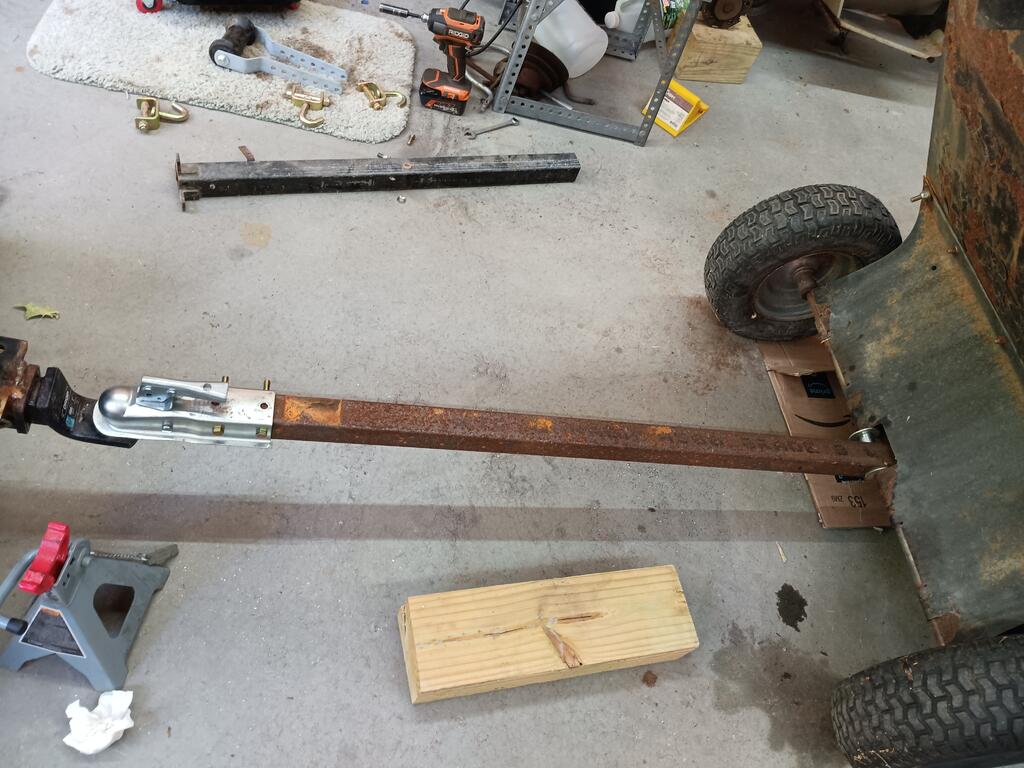

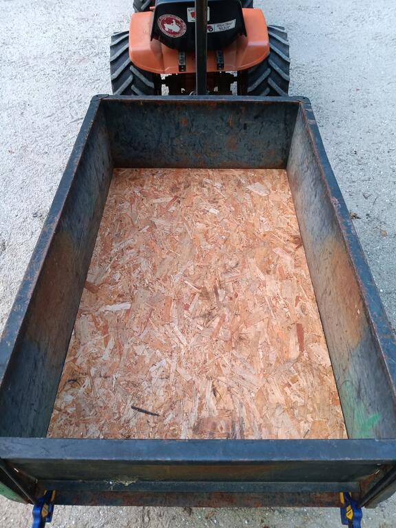

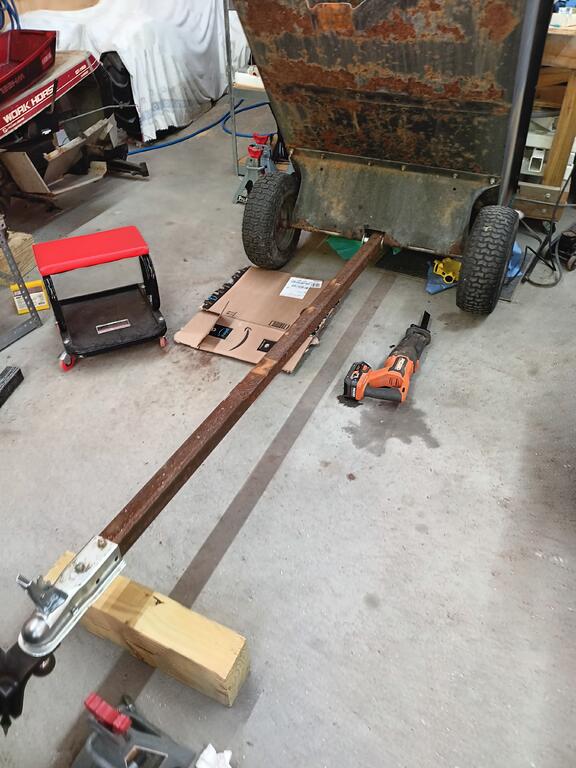

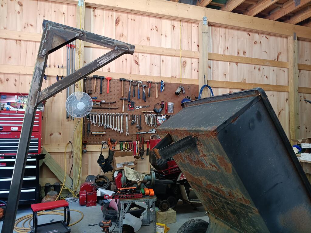

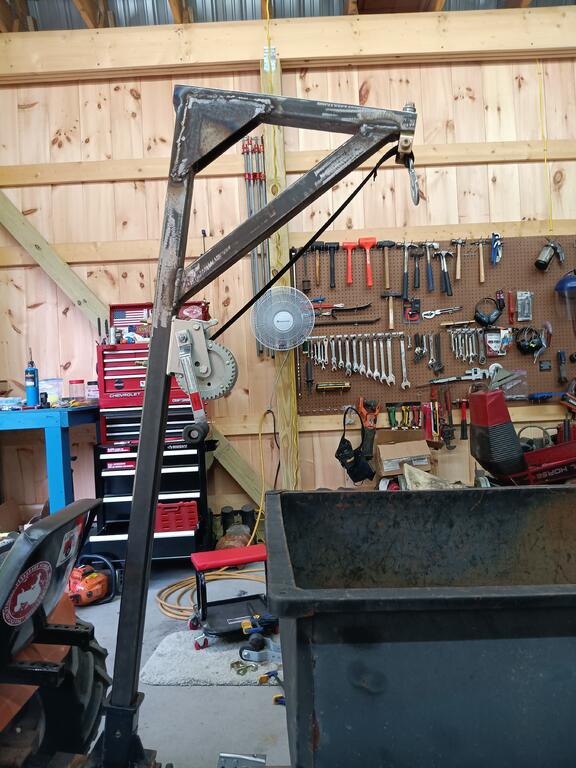

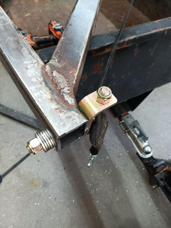

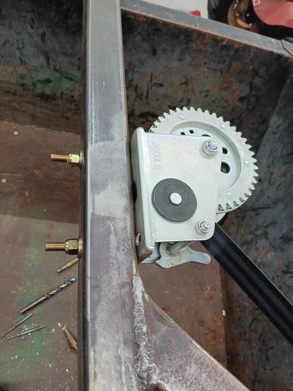

ebinmaine 80,088 #84 Posted September 15, 2024 @OutdoorEnvy and the rest o' youzz folks. I have an UPDATE!! We have an 18 cu yd load of 1 1/2" crushed stone being delivered soon. I figure the Wally Digger Backhoe is a great tool for LOADING yard trailers. We need a way to UNLOAD them. So..... Back to this crane project!! I started out with chopping almost 16" off the end of the crane. Didn't need it. It also added a LOT to the leverage of the whole hitch in a serious downward twist. I'll compensate more for that with a vehicle scissor jack. I'd added a long tube frame to the trailer years ago. Forget now why. May have been because I was thinking about putting the crane on the trailer back then. May have been because I didn't want to chop the tube until I knew what I was doing with this build. Anyway, I shortened that up by over two feet. Before: After: This got the crane and trailer nose about 28" closer together. Next thing was to finish adding the lift mechanism to the crane. Here's the winch: And the lift belt holder: The whole setup: Last for today I found a piece of scrap/leftover 1/2" square edge Advantech. That's going to be bolted to the floor of the trailer. Partially for a great reduction in noise level when filling with stone. Partially for a huge difference in added strength. Next on the list is to add a piece of 3" angle iron to the front as my lifting point. That'll be bolted through the Advantech, the metal floor, the front cargo box support, and the lifting chain(s).. 2 10 Share this post Link to post Share on other sites

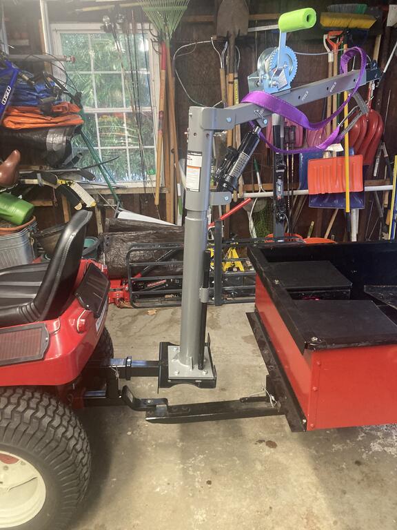

SylvanLakeWH 32,006 #87 Posted September 16, 2024 Very similar to mine... Works like a charm... 4 Share this post Link to post Share on other sites

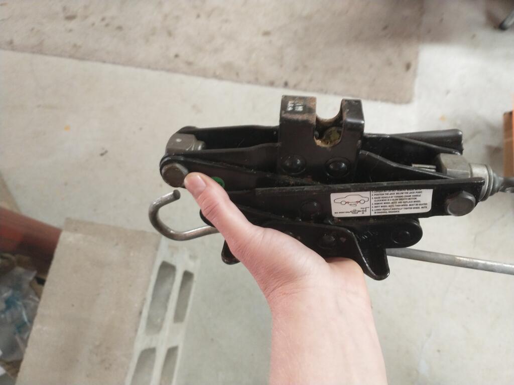

ebinmaine 80,088 #91 Posted September 23, 2024 Here's the scissor jack I want to try. I'm hoping to hose clamp it to the bottom somehow. Share this post Link to post Share on other sites
SylvanLakeWH 32,006 #92 Posted September 23, 2024 47 minutes ago, ebinmaine said: Here's the scissor jack I want to try. I'm hoping to hose clamp it to the bottom somehow. I'd think bolts / weld would be more stable? 1 Share this post Link to post Share on other sites
ebinmaine 80,088 #93 Posted September 23, 2024 6 minutes ago, SylvanLakeWH said: I'd think bolts / weld would be more stable? Definitely agreed but I don't know where I would put them yet and also not sure if this is going to be a permanent solution. I don't think it'll really go anywhere because the tractor will be locked in place and I never dump anything unless I'm on level ground. 2 Share this post Link to post Share on other sites
ranger 1,860 #94 Posted September 23, 2024 2 hours ago, ebinmaine said: Here's the scissor jack I want to try. I'm hoping to hose clamp it to the bottom somehow. Try to angle the foot so the base is slightly further rearward than the top. This helps to stabilise the setup. If you mount it truly vertical, as the load is taken up the foot can sink in the ground and end up not providing much support! 1 Share this post Link to post Share on other sites
ebinmaine 80,088 #95 Posted September 23, 2024 2 minutes ago, ranger said: Try to angle the foot so the base is slightly further rearward than the top. This helps to stabilise the setup. If you mount it truly vertical, as the load is taken up the foot can sink in the ground and end up not providing much support! I've also considered adding to the base to increase its size. With the current crane being angled as it is I may have to take whatever I can get until a more appropriate hitch is built. Share this post Link to post Share on other sites

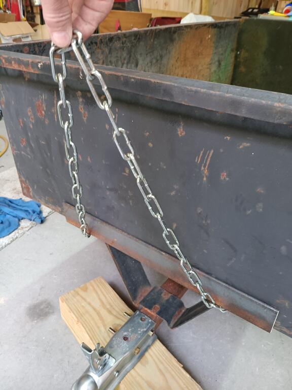

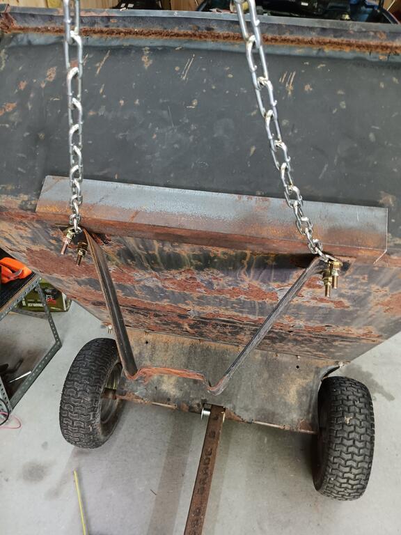

ebinmaine 80,088 #96 Posted September 28, 2024 I got the angle iron on and front stand back on. Also mounted a chain through the front bolts. I'll experiment with the chain length. I left it long on purpose. 3 Share this post Link to post Share on other sites
