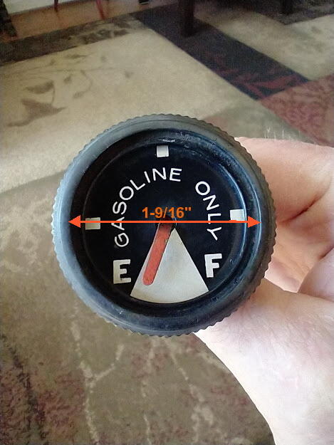

rmaynard 17,195 #1 Posted March 30, 2021 Looking for a source for a replacement lens for my Kelch gas cap. This is from my 1967 REO lawn skiff with Tecumseh V60 engine. Glen Pettit has larger ones, but this is 1-9/16" in diameter. Share this post Link to post Share on other sites

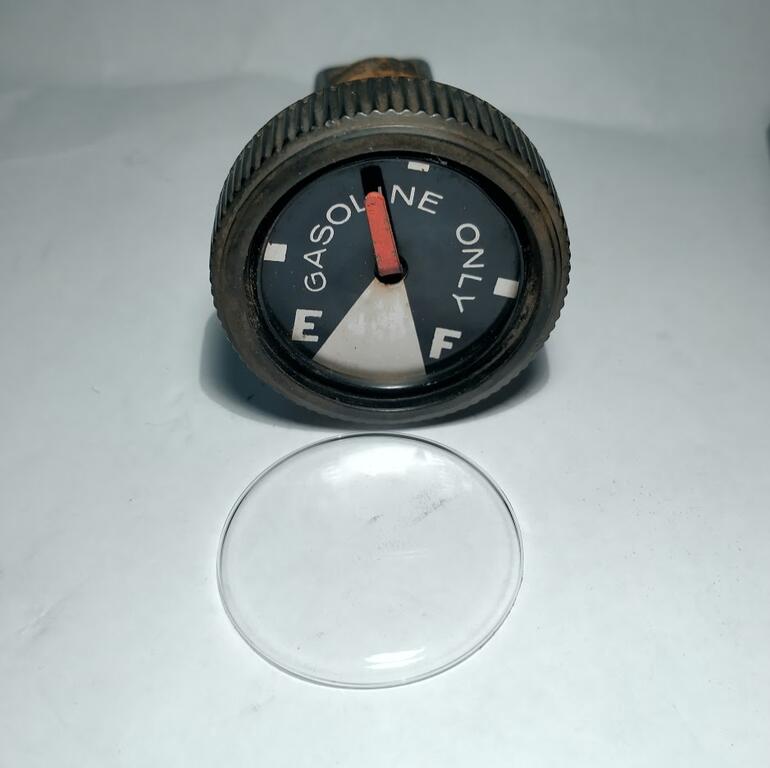

rmaynard 17,195 #4 Posted April 13, 2021 Since I did not find exactly what I was looking for, I decided to think outside of the box. Here is what I found. Upon further detailed examination, I determined that the inside diameter of the top of the cap (under the lip) was not 1-9/16". It is 41mm, I found an acrylic, domed, 40.9mm pocket watch lens. All that I need to determine is whether I need to drill a small hole in it to act as a vent. Problem solved. 2 Share this post Link to post Share on other sites
