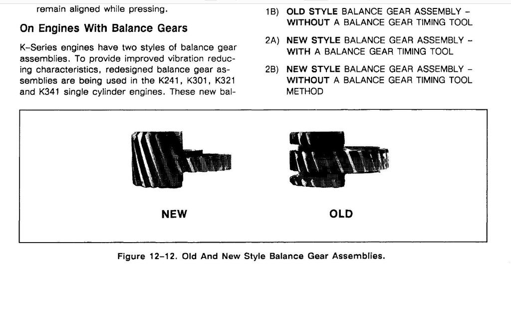

pfrederi 19,440 #1 Posted March 30, 2021 There are a lot of posts about balance gears in Kohler singles. I think it is time we tried to gather some solid data not just internet rumors about balance gear failures. There is no doubt some fail. Question is what ones. Kohler had two styles of balance gears old and new. Recent reports on here of failures appear to be the old style. The new style was also used in Magnum singles, but I haven't see many comments about failure there. So if you had a failure or knocking noise what engine was it in and was it old or new.... . 4 3 Share this post Link to post Share on other sites
roadapples 6,985 #2 Posted March 30, 2021 Does this give any serial numbers or year of which one has what.... Share this post Link to post Share on other sites
pfrederi 19,440 #3 Posted March 30, 2021 Since they may have been upgraded you have to look at the picture or at least have the spec number 1 Share this post Link to post Share on other sites

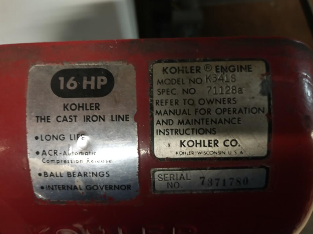

squonk 45,048 #11 Posted March 31, 2021 Here is the tag off of the engine I'm working on. Share this post Link to post Share on other sites

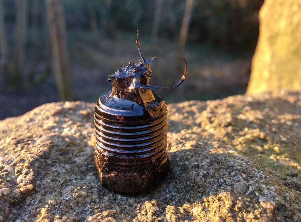

meadowfield 2,950 #12 Posted March 31, 2021 when I rebuilt my magnum 16 - which stored most of the crankcase oil on top of the piston and in the exhaust, I removed the balance gears. The needle bearings in them collapsed as I pulled it apart and some of the sharp swarf on the drain plug was no doubt some of the outer edge of the small torrington bearings. Engine still runs fine - I've no doubt the gears would have failed as the bearings gave up! 1 Share this post Link to post Share on other sites
pfrederi 19,440 #13 Posted March 31, 2021 5 minutes ago, meadowfield said: when I rebuilt my magnum 16 - which stored most of the crankcase oil on top of the piston and in the exhaust, I removed the balance gears. The needle bearings in them collapsed as I pulled it apart and some of the sharp swarf on the drain plug was no doubt some of the outer edge of the small torrington bearings. Engine still runs fine - I've no doubt the gears would have failed as the bearings gave up! According to the manual the new style balance gears had uncaged needle bearings. You are warned that they may drop out as you remove the bearing. They nicely tell you there are 27 needles in each bearing so you can make sure you found them all... Share this post Link to post Share on other sites
meadowfield 2,950 #14 Posted March 31, 2021 (edited) 1 hour ago, pfrederi said: According to the manual the new style balance gears had uncaged needle bearings. You are warned that they may drop out as you remove the bearing. They nicely tell you there are 27 needles in each bearing so you can make sure you found them all... I missed that! but for sure the swarf was like antlers and definitely not rings, and clearly no shells on the rod. So I assumed it was part of the bearing... Edited March 31, 2021 by meadowfield 2 Share this post Link to post Share on other sites
squonk 45,048 #15 Posted March 31, 2021 Small piece a balance gear needle perhaps? Share this post Link to post Share on other sites
meadowfield 2,950 #16 Posted March 31, 2021 3 minutes ago, squonk said: Small piece a balance gear needle perhaps? wow! whats that? piston skirt? Share this post Link to post Share on other sites
squonk 45,048 #17 Posted March 31, 2021 32 minutes ago, meadowfield said: wow! whats that? piston skirt? Share this post Link to post Share on other sites

pfrederi 19,440 #21 Posted March 31, 2021 5 minutes ago, pacer said: Before I wrote that I tried to pull up from my aging brain which they were, but could only vaguely remember them being the 'old' type. This happened at least a couple yrs ago, soooo? i wish I knew for sure when the balance gears were changed. All I have figured out so far is based on the before/after serial number related to the bearings. (looked at 12, 14 and 16hp all were in 960000 series) That would indicate the change was made in 1979. 1 Share this post Link to post Share on other sites
