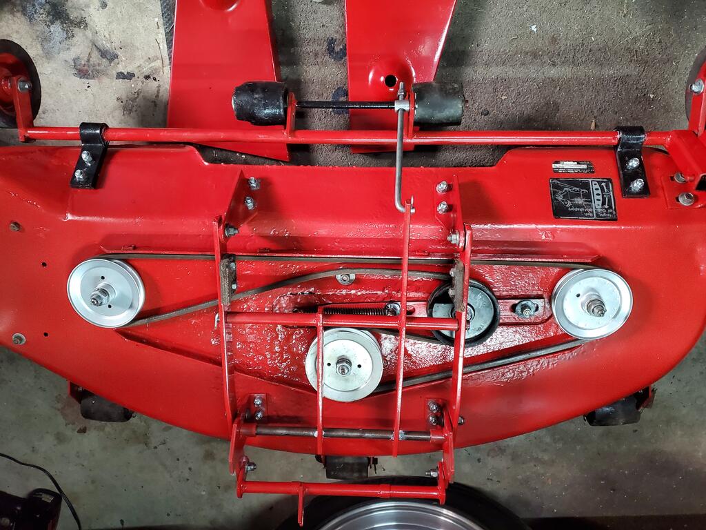

roy 13 #1 Posted March 30, 2021 Rebuilt deck for my 418-A, with new spindles , hardware & all back together BUT, when I installed the same deck belt, it's so loose I know it's not right. I'm assuming it's the spring, flat arm tension thing not doing it's job. For the life of me I can't see how to make it take up the slack, see pic, I just looped belt over that deck bolt to show how much slack belt is! Share this post Link to post Share on other sites
Jeff-C175 7,211 #2 Posted March 30, 2021 (edited) @roy There's two holes for the idler pulley on that bar, right? Maybe you've got the pulley in the wrong hole? I believe that the hole in the deck under the right hand slide bolt is slotted. If you can move that to the left you'll have more room to slide the bar over to service the belt when it comes time. Won't fix your issue now but just for future. Edited March 30, 2021 by Jeff-C175 Share this post Link to post Share on other sites

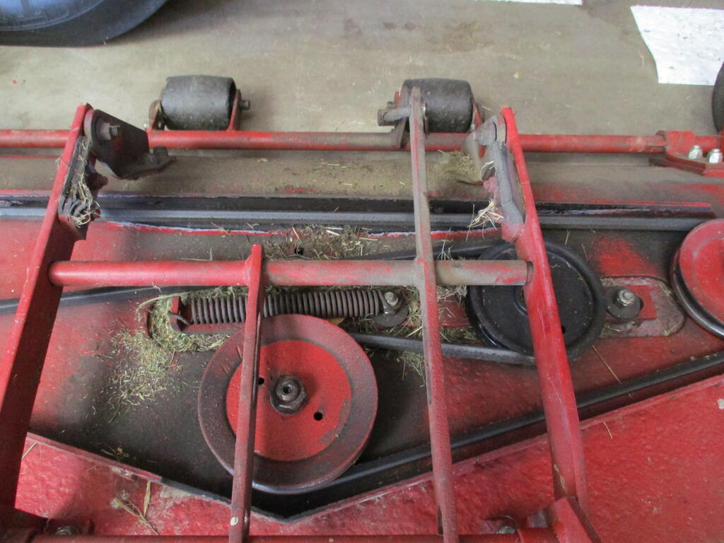

pfrederi 21,222 #3 Posted March 30, 2021 Her is my deck from the 418. When you tug on the belt does the bar slide freely?? Share this post Link to post Share on other sites

pfrederi 21,222 #6 Posted March 30, 2021 Maybe correct on the two holes but with belt loose the spring should pull the bar all the way to the end of the slot it rides in. With proper tension it should be in the middle of the slot. With a loose belt yours is still in the center.... Share this post Link to post Share on other sites

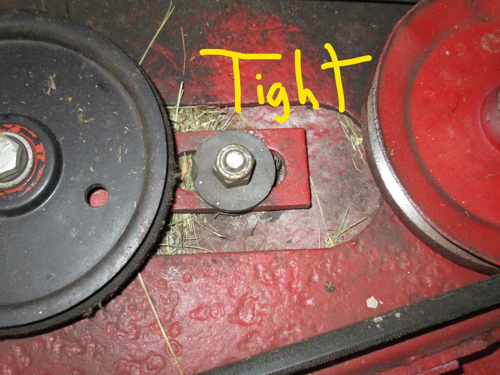

Jeff-C175 7,211 #7 Posted March 30, 2021 7 minutes ago, pfrederi said: Maybe correct Are your drawings backurds Paul? Isn't TIGHT with the bar further to the right and LOOSE to the left? Share this post Link to post Share on other sites
Ed Kennell 47,600 #8 Posted March 30, 2021 Are there two holes for the spring ancher bolt? In your pictures it looks like that bolt is at the end of the slot and the other bolt is in the middle of the slot. Share this post Link to post Share on other sites
pfrederi 21,222 #9 Posted March 30, 2021 2 hours ago, Jeff-C175 said: Are your drawings backurds Paul? Isn't TIGHT with the bar further to the right and LOOSE to the left? No look at how the spring works, it will push the idler bar to the idler pulley end of the slot if there is no resistance from the belt. Share this post Link to post Share on other sites
roy 13 #10 Posted March 30, 2021 I'm pulling it apart tonight, I think there are 2 holes for the idler pulley, will try & move it. Yes to pulley , idler size same as old ones. The bar moves freely when I pull on the belt, end bolt moves to end of slot. I'm hoping moving idler pulley will help " tension" the belt Thanks all guys , will keep u apprised of what happens Roy 1 Share this post Link to post Share on other sites
Lee1977 7,805 #11 Posted March 31, 2021 (edited) It looks like you painted the bar that could cause it not to slide. If you have the idler in the right hole it could be the paint. Edited March 31, 2021 by Lee1977 Share this post Link to post Share on other sites
Jeff-C175 7,211 #12 Posted March 31, 2021 4 hours ago, pfrederi said: No look at how the spring works, it will push the idler bar to the idler pulley end of the slot if there is no resistance from the belt. I think we're actually saying the same thing in a different way. Share this post Link to post Share on other sites
Jeff-C175 7,211 #13 Posted March 31, 2021 7 hours ago, roy said: see pic Definitely in the wrong hole: Look at the distance between the edge of the idler pulley and the end of the slot. About one inch on yours. You can see the edge of the pulley on Paul's pic is right at the end of the slot. And that's exactly the amount of distance between the two holes on the idler bar. Share this post Link to post Share on other sites
roy 13 #14 Posted March 31, 2021 I removed idler pulley, & there is that 2nd threaded hole! Moving the idler to 2nd hole has solved the issue, I now have tension on the belt & the "slider" does move freely Thanks for all the advise gentlemen Roy 2 2 Share this post Link to post Share on other sites
