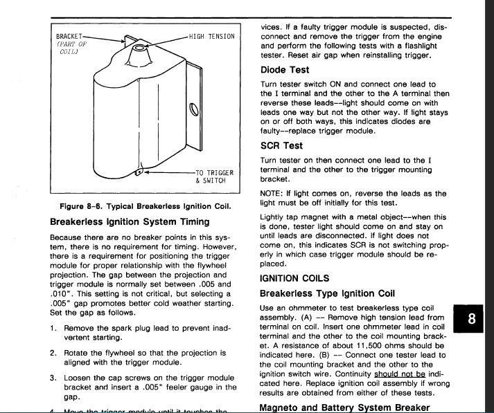

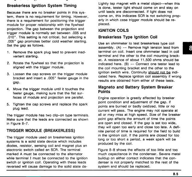

pfrederi 20,891 #2 Posted March 30, 2021 I know of no other compatible... However you should find out if it your coil or the trigger that has failed. Coils can be had triggers are harder/$$ to come by. You can download the K series service manual in the manuals section here Share this post Link to post Share on other sites
