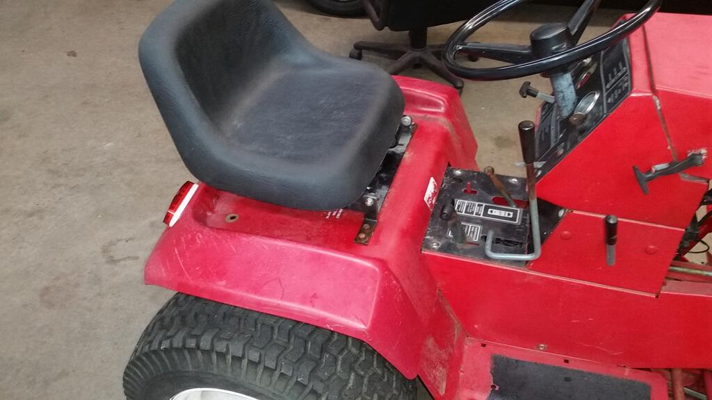

Gregor 4,848 #1 Posted March 29, 2021 Can someone tell me? Did they make this fender in a metal version also, or just plastic? Thanks Greg 1 Share this post Link to post Share on other sites

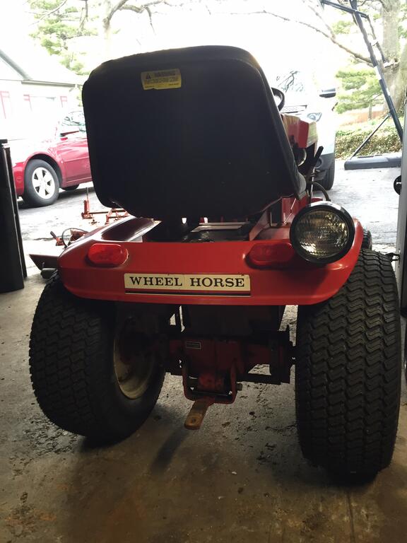

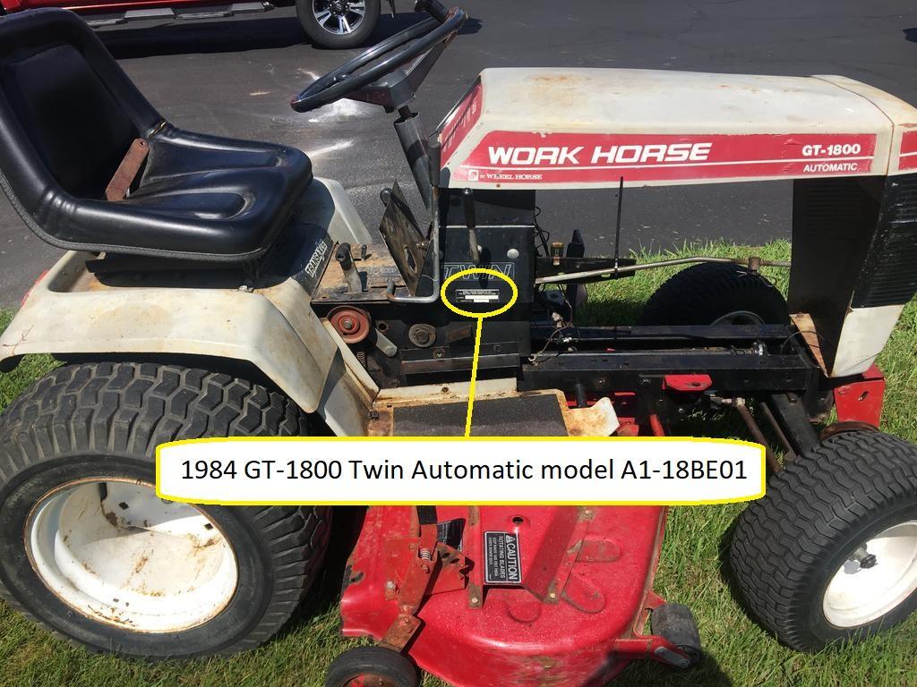

Achto 32,891 #7 Posted March 30, 2021 Most any fender pan from a tractor with the fuel tank under the seat will work. I have a C101 fender pan on my C145. Before After When I get around to restoring this tractor I'm going to install a pan from a GT 1800. It will look a little closer to the plastic fender pan. There was also a member that was reproducing the plastic fenders in fiber glass. I can't remember his handle on Redsquare. Maybe @WHX24 can remember, he purchased a C195 from the guy. 3 Share this post Link to post Share on other sites
Gregor 4,848 #8 Posted March 30, 2021 21 minutes ago, Achto said: Most any fender pan from a tractor with the fuel tank under the seat will work. If I cannot find an original, that will do nicely. Share this post Link to post Share on other sites
WHX?? 58,324 #9 Posted March 30, 2021 (edited) Any pan off 3, 4 500 series will be plug and play. I CRS who that guy was that has the originals but it will come to me. A Bhood in C-145 flavor with a 520 pan ..... Edited March 30, 2021 by WHX24 3 Share this post Link to post Share on other sites

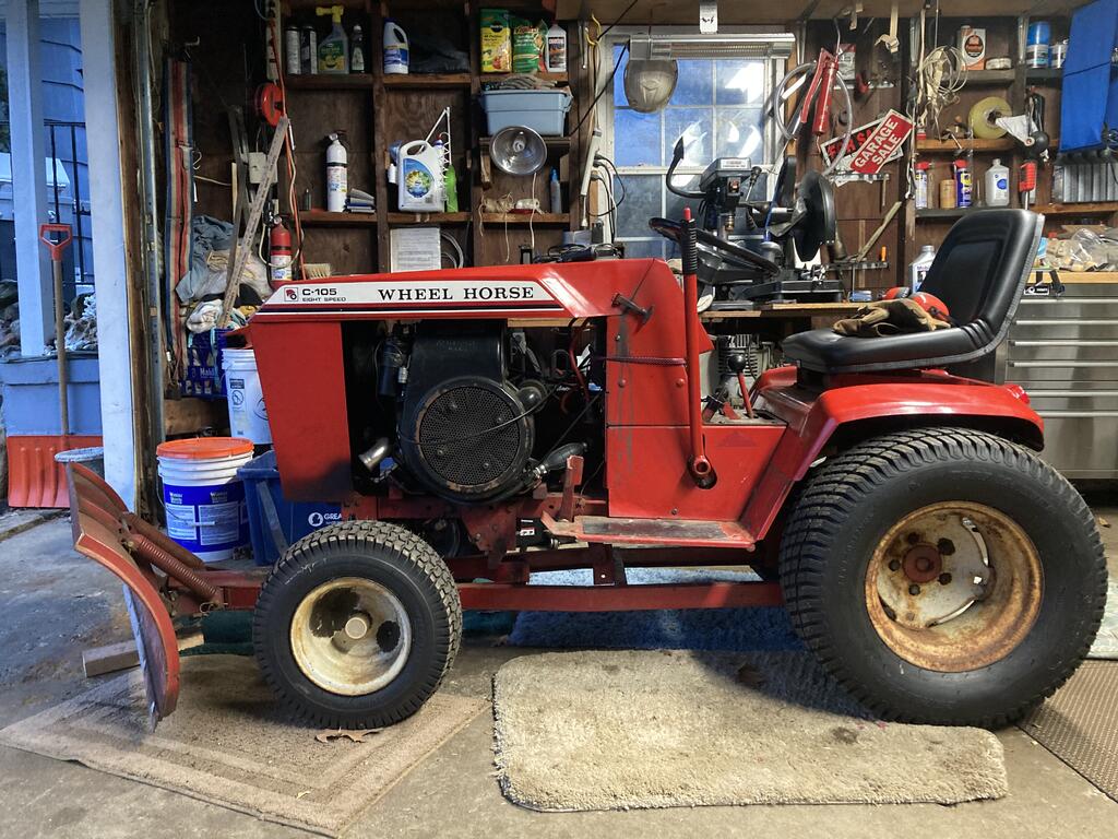

SylvanLakeWH 32,776 #10 Posted March 30, 2021 Heres my C105 with a metal fender... 1 Share this post Link to post Share on other sites

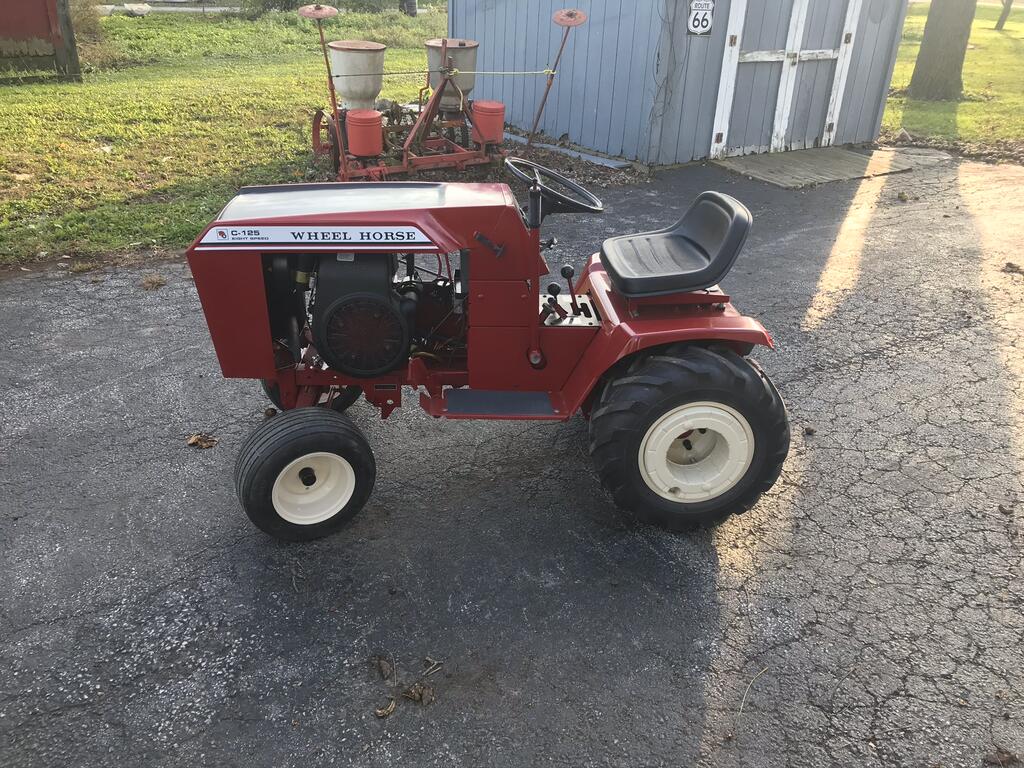

81blackhood 168 #13 Posted March 31, 2021 My C125 with a seat pan off of a C81 2 1 Share this post Link to post Share on other sites

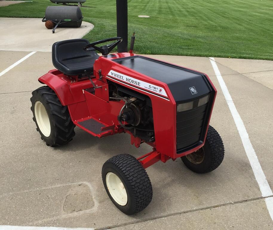

cschannuth 3,821 #14 Posted March 31, 2021 I prefer to keep things original but I think my Dad’s ‘78 C-161 looks good with the metal pan. It’s been on there for over 40 years. 3 1 Share this post Link to post Share on other sites

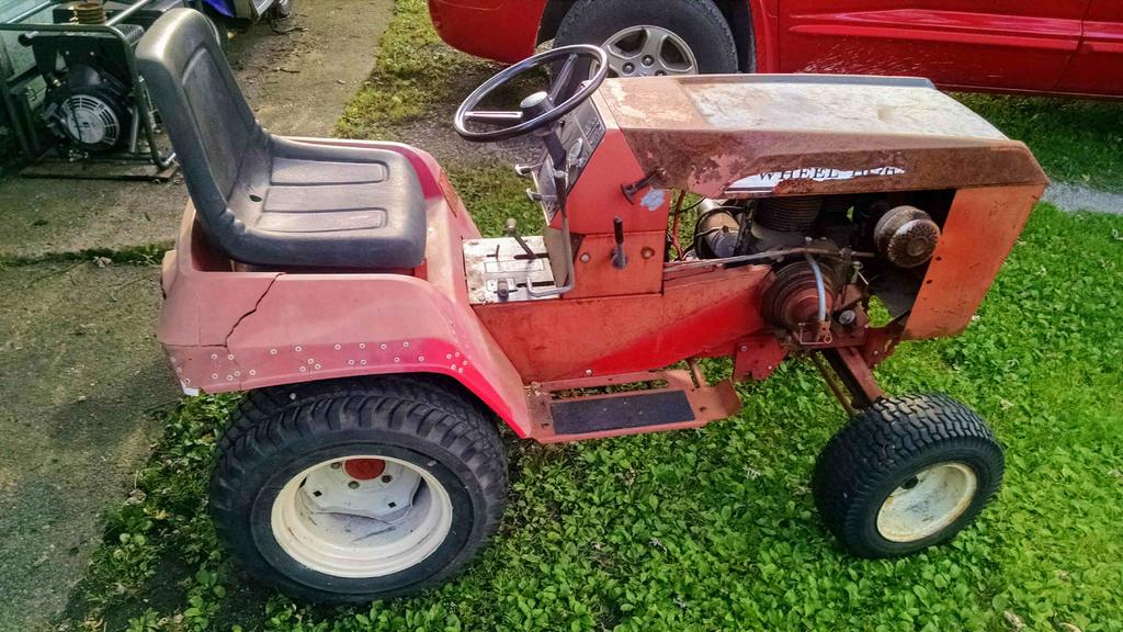

8ntruck 9,368 #18 Posted May 27, 2022 The plastic fenders on my C195 has a crack between the opening for the gas filler and the bottom of the fender. The fender is made from relatively simple shapes. It would be possible to build a reasonable facsimile out of 1/4" plate. Big project, but possible. Would add some weight over the rear wheels, too. Share this post Link to post Share on other sites
