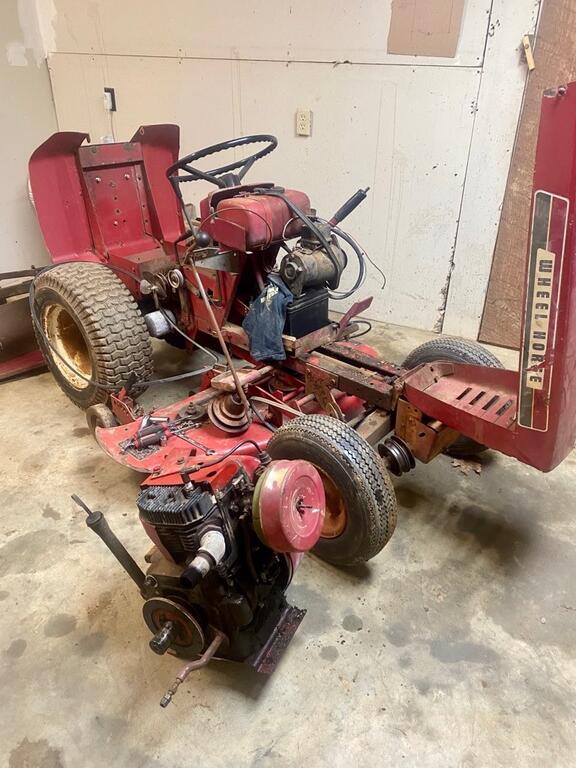

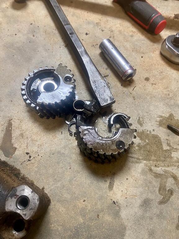

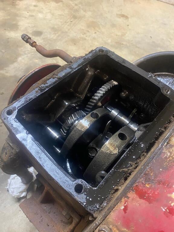

Greentored 3,220 #1 Posted March 29, 2021 This is a topic of much debate, so thought id share some first hand experience with these gears and vibration. The 1277 'lawn duty' got a K341 swap late last fall, and although the extent of his work was blowing leaves and a neighborhood ride, have not been able to get this 'balance gear' thing out of my head. Great runner, no smoke, nice n quiet, but is there a ticking time bomb inside that could potentially destroy a good 16hp block without warning? Yesterday I pulled the engine back off, flipped it over, and went inside. The wear was SCARY! I could rock and wobble the gears all over the place, and the teeth were worn sharp- Gonna call this a real good catch! I popped one gear out, split the second with a long chisel, fished the pieces out, and slapped her back together. The result: there is absolutely, beyond a doubt, a noticeable difference in vibration across the board, most noticeable at about 2000rpm. Overall, not any worse than a non counterbalanced K series big block- 'bouncy' at idle and just fine right up to 3600, but if someone were to run this at 2 grand I believe it would get 'buzzy' and uncomfortable. Some of you guys are much more well versed with these and can chime in with your experiences, but after this back to back test, personally speaking, I will continue popping them out of my used engines with unknown hours/history, but if the time ever comes to overhaul a big K341, I would probably install new ones, just because of that 2000rpm range. Hope this ends up being some useful information for someone 8 1 Share this post Link to post Share on other sites

squonk 46,835 #8 Posted March 30, 2021 Trying something here. Don't know if it will work. Loose balance gear on my K341. https://photos.google.com/share/AF1QipPxLtDwCuxwmWLzvpSRmsRXh1MRSWNpQsAoymZGU5oodXYjxVFCWCKri8Z9iFH-GA/photo/AF1QipNNz5ZvsvvxKLe-5Lxm6ywAeAtgIcLTOKiEOHf2?key=dFpqVE83d3NxOGVaX2NmYkdvNHpObmNQUEY1dFN3 1 Share this post Link to post Share on other sites

Greentored 3,220 #14 Posted March 31, 2021 (edited) 23 hours ago, squonk said: Trying something here. Don't know if it will work. Loose balance gear on my K341. https://photos.google.com/share/AF1QipPxLtDwCuxwmWLzvpSRmsRXh1MRSWNpQsAoymZGU5oodXYjxVFCWCKri8Z9iFH-GA/photo/AF1QipNNz5ZvsvvxKLe-5Lxm6ywAeAtgIcLTOKiEOHf2?key=dFpqVE83d3NxOGVaX2NmYkdvNHpObmNQUEY1dFN3 My gears made yours look like a brand new engine. Wish I had taken a video. ...and the thing was not making noise! I simply did it for peace of mind. Think we both somehow managed to get a pin back in a couple grenades. Edited March 31, 2021 by Greentored Share this post Link to post Share on other sites
