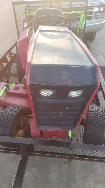

Gregor 4,848 #1 Posted March 28, 2021 Is this a black hood? Share this post Link to post Share on other sites
stevasaurus 23,742 #2 Posted March 28, 2021 Sure looks like it is...not positive though. 90% Share this post Link to post Share on other sites

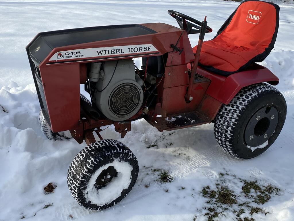

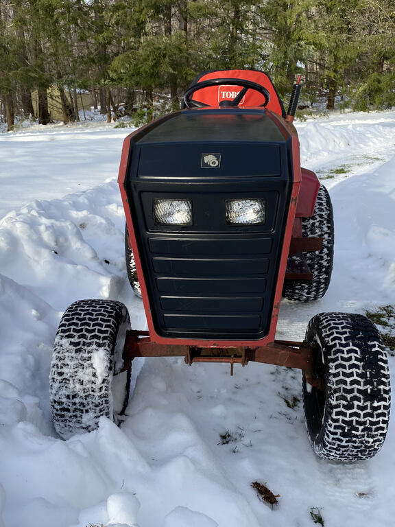

Sparky-(Admin) 25,937 #3 Posted March 28, 2021 Without a pic we can’t be sure. I’ve seen plenty of decals slapped on machines they don’t belong on. But if it’s a real C-125 its considered a black-hood series. This is my C-105 for reference on the body style. 6 Share this post Link to post Share on other sites

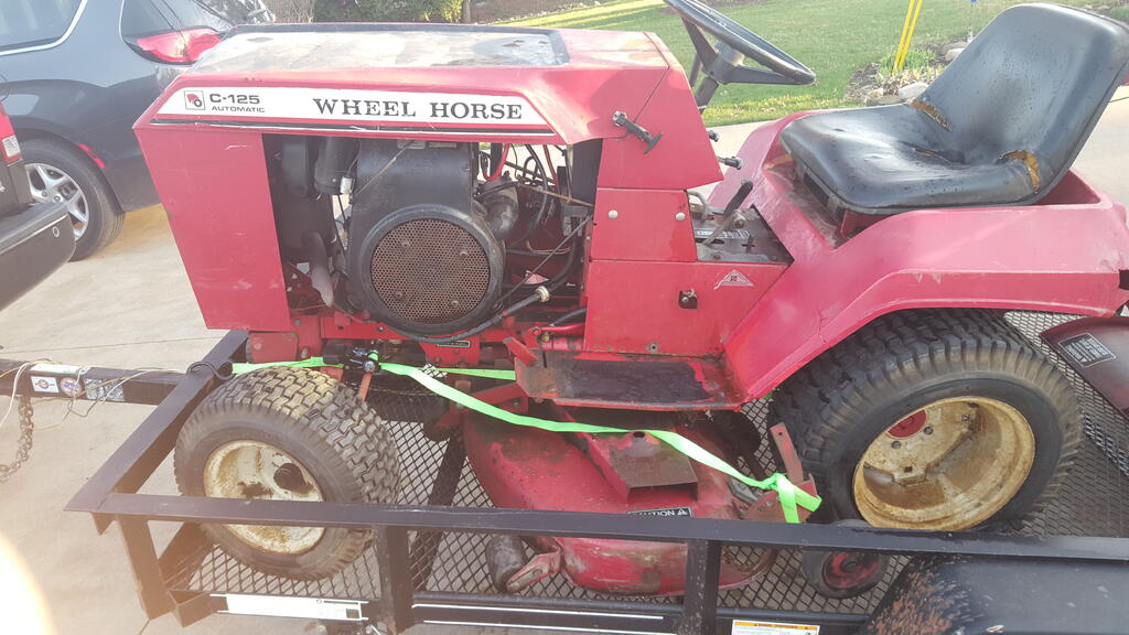

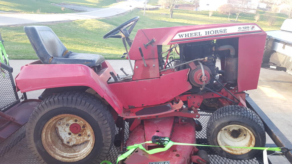

Gregor 4,848 #4 Posted March 29, 2021 I said the other day, I would not buy another tractor, unless it was a 16HP, or a Black Hood. Well, it's not 16 HP, but the hood looks black to me. It popped upon Facebook. 8 minutes after it was posted, I was messaging the guy. 45 minutes, and $150 later, it was on the trailer, headed home. He said he must have sold it too cheap. His phone was blowing up, but I was the first to message him. Complete with mower deck, snow plow, and owners manual. "Ran When Parked" I'm just not sure how long it's been parked. Motor turns free, without any funny noises. The guy said he had the motor rebuilt at one point, by a shop I am familiar with, and trust. I dunno. Might be a good thing, might not. I don't know if the seat/fender pan is plastic, or fiberglass, but it's cracked, and will need some attention. The rest of the tin looks very good. I think the deck is pretty bad. I was not interested in it for mowing anyway. Tire is flat, but in a few days, I'll have extras. This will get towed to my storage for now. I am NOT opening up another project right now. Too many going on already, and all the parts will probably get here at the same time. 4 Share this post Link to post Share on other sites

Gregor 4,848 #7 Posted March 29, 2021 I used the 656 to yank the 125 into the garage this morning, for a quick look over. (the neighbors still love me) It looks to me to be 100% complete. The fender/seat pan appears to be plastic, and has chunks missing. I'll bet these are just all over the internet, right? The rest of the tin work is perfect. Surprisingly the 125 seems larger in stature, than my 141. It's pieces, parts, and workings though, look very similar to the 141. When I turned the motor over by hand last night, it spun very easy. Maybe too easy I thought. I pulled the plug to check, and the piston is moving up and down, so that's a good sign anyway. Not sure what to do with the deck. It has a couple of large holes, and I don't believe it's worth saving. I will yank it off, and later today, pull the tractor around to storage. It has new battery cables on it !t 1 Share this post Link to post Share on other sites
Sparky-(Admin) 25,937 #8 Posted March 29, 2021 Any metal rear fender from a 300 or 400 series will bolt right on with no modifications. Even the fuel fill hole will line up 1 1 Share this post Link to post Share on other sites
