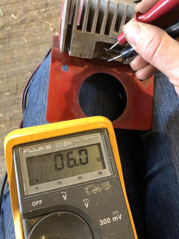

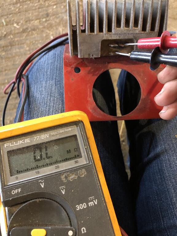

krystolo 504 #12 Posted March 28, 2021 (edited) 3 hours ago, gwest_ca said: If you end up with the regulator off and one of the AC terminals is wasted see if that one is connected to the DC terminal inside the regulator. Use an ohmmeter to do that and look for 0 ohms. One AC terminal is connected directly to the DC and one is not. If it is you can connect one AC wire (does not matter which one) to the DC wire and the regulator will work. Garry Here’s what I’ve got. I am not adept with the MM. im guessing the right side connector is blown. Or maybe it’s the left, since there’s a lot of resistance? Lol, I’m a hot mess over here. so do I connect the ac and dc wires together, then shove them into the connector, then attach? Edited March 28, 2021 by krystolo Share this post Link to post Share on other sites

Handy Don 16,062 #14 Posted March 28, 2021 (edited) The Ω function on most meters is polarized. This means the current flows in one direction "out one probe and in the other" so to speak. To test a rectifier, as part of a voltage regulator, you have to check from each AC input (looks like the "upper" connectors on yours) to the DC output in both directions. That means getting readings with the red probe on the DC and the black probe on the AC and then switching the probes to test "in the other direction". When doing this you have to take a bunch of readings. First, test each pair of connections separately both ways by reversing the probes. Keep track of how the probes were configured for each test (red on AC vs red on DC, for example): If you have 0 Ω in both directions--bad. If you have very high Ω in both directions--bad. If you have 0 in one direction and small (like your 6Ω) in the other probably ok on that side. Once finished with the tests, and both sides have a "probably ok", check your notes. The two tests that had Probably OK should have one test with the red probe on DC and the other test with the black probe on DC. If not. Time for a new regulator. Hope this makes sense! Edited March 28, 2021 by Handy Don Share this post Link to post Share on other sites

krystolo 504 #16 Posted March 28, 2021 Results of the testing. Share this post Link to post Share on other sites
Handy Don 16,062 #17 Posted March 28, 2021 (edited) 9 minutes ago, krystolo said: Results of the testing. So this seems to confirm your earlier assessment. The AC connection with 10 and ∞ is good. The one with 4 and 4 is bad. As someone suggested, you can get by with only one good one. You can disconnect the bad one (and tape it to keep it from shorting against anything) as a temporary workaround until you get a new regulator. This cuts the generating capability in half, though. It is still enough to run the machine and charge the battery if run for, say, 30 minutes or so at a shot. But I suggest no lights or cigarette lighter usage ! Progress! Edited March 28, 2021 by Handy Don Share this post Link to post Share on other sites
Handy Don 16,062 #18 Posted March 28, 2021 Should have added that the bad AC side on the regulator was not only preventing the battery from charging, it was draining your battery when the engine was stopped. Share this post Link to post Share on other sites
