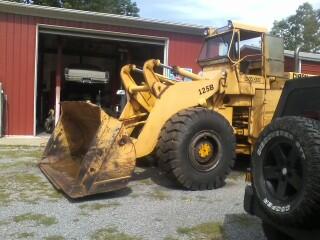

Pollack Pete 2,273 #53 Posted March 31, 2021 If you were close by,I'd come rattling over with this.My Michigan 125B loader.That pile would be spread in less than 5 minutes. 2 1 1 Share this post Link to post Share on other sites
Ed Kennell 47,266 #54 Posted March 31, 2021 24 minutes ago, Pollack Pete said: .That pile would be spread in less than 5 minutes. Now Pete, you wouldn't dare ruin all his fun. 1 2 1 Share this post Link to post Share on other sites

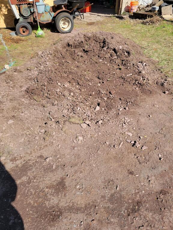

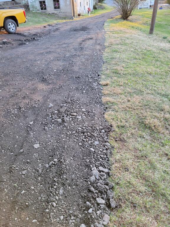

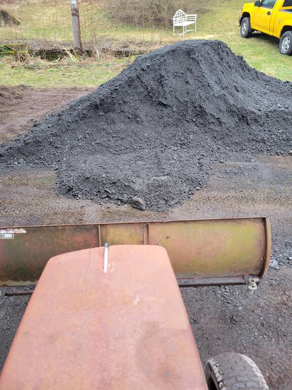

iam206 81 #56 Posted March 31, 2021 Was able to push some millings today... But not until I had to take apart carb again. Took fuel pump apart this time also and found debris in the pump. I'll need all new gaskets for everything, but I have it temporarily back together and pushed back into service. I'll update some pictures... I would back drag the pile to get a good section for pushing, then push that to end of driveway.. then repeat until I got enough to spread with plow and back drag. I came back and did a little hand raking to level it out... Slowly but shorly... and don't cal me surly. 2 Share this post Link to post Share on other sites

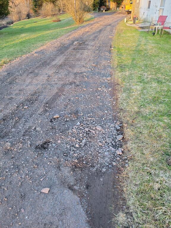

iam206 81 #59 Posted April 3, 2021 Was able to get a little more millings spread out today and rolled it with my little yellow steamroller. I will go back over it and rent a tamper once I get it all spread. I might get another load dropped, went a little thick in some areas to level the job out. I am super happy with this old girl! I was messing with the carb adjustments today, I think I found a good setting on it, still occasionally pops, but for the most part it was running good. It doesn't like to run below a half a tank of gas though. I still think the fuel pump is a bit on the weak side. Do they sell the diaphragm and valves for the original pump anywhere? the repaired hydraulic hose will need attention. hose clamps just dont cut it. David. 3 3 Share this post Link to post Share on other sites

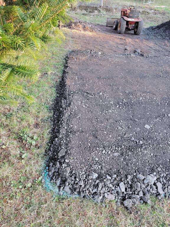

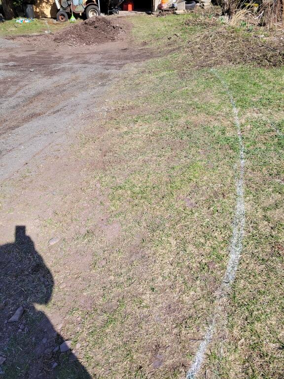

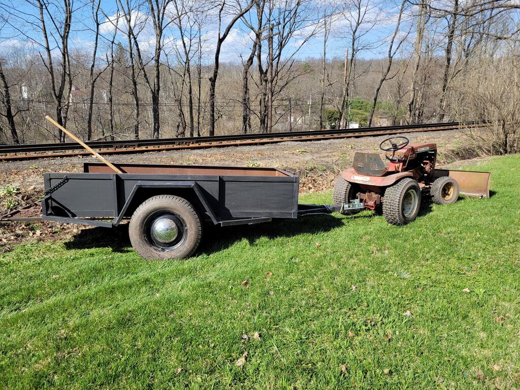

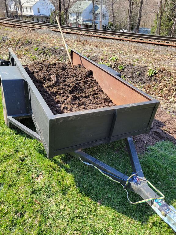

iam206 81 #67 Posted April 5, 2021 I got the last of the pile of millings spread out, Started prepping for the second dump of millings due tomorrow. For this second section I have to do a bit of hand digging. Wish I had some sort of cultivator or ripping tool for the back of the tractor, but I will soon enough. Some of the spots, like where I have the white line painted in the grass, I was thinking of trying out the Troy-Built tiller I have. you can probably see it in the first post I made in this thread. I did the garden with it so If I break it at this point, I am good till next spring.. fingers crossed. lol I put my trailer to work hauling the dirt away that I am generating from the driveway excavation. I modified the Wheel Horse factory hitch to accept the spare 2" ball I have so I didnt need to drive the 'yellow horse" on the lawn and make a new project for myself. I was surprised how much this old girl can do! The wheels slipped a bit on the loose driveway with the "full load", but she pulled that trailer well. I was mostly on flat ground when it was loaded, and up hill when it was empty. Once I get all spread out I will rent a tamper for the day and see how many fillings I can loosen up in my teeth. another good day with the Wheel Horse! David. 2 3 Share this post Link to post Share on other sites

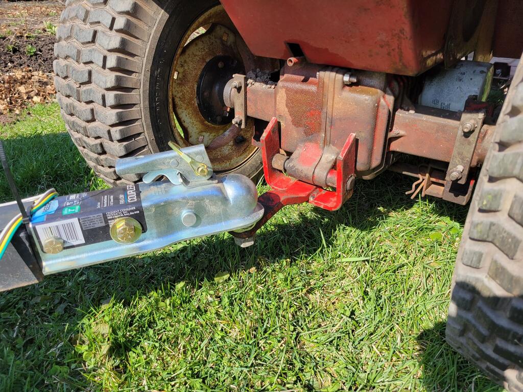

ebinmaine 80,641 #68 Posted April 5, 2021 When you get around to it pick up a heavy duty hitch from our own vendor Wheelhorse parts and more. Good addon for the type of work you're doing. 2" receiver so you can change heights or ball size quickly. I keep 3 or 4 on hand for different trailers. Very nice... 1 1 Share this post Link to post Share on other sites
iam206 81 #69 Posted April 5, 2021 1 hour ago, ebinmaine said: When you get around to it pick up a heavy duty hitch from our own vendor Wheelhorse parts and more. Good addon for the type of work you're doing. 2" receiver so you can change heights or ball size quickly. I keep 3 or 4 on hand for different trailers. When I get to log some shop time (my shop is in the same town where I work, about an hour away from where I live ) I'll weld up something that is appropriate for the job. I mentioned earlier in the thread, that we purchaced the property a little over a year ago. First phaze was getting the interior liveable and now I get to play with the garage to get that in a condition that I can move my shop into that. Maybe by this fall I'll have the new garage structure up (if I last that long..), In the meantime, I really want to score a lift cable and a slot hitch so I can start using the rear lift. David 1 Share this post Link to post Share on other sites
ebinmaine 80,641 #70 Posted April 5, 2021 3 minutes ago, iam206 said: really want to score a lift cable and a slot hitch so I can start using the rear lift Sounds like you've got a good plan together. Looking forward to seeing how things work out for you. The same vendor I mentioned above could also help you with the cable, and I think, the hitch as well. Share this post Link to post Share on other sites

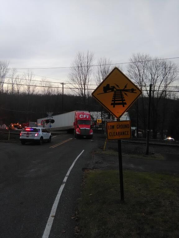

pfrederi 21,145 #75 Posted April 5, 2021 (edited) Looks like the opposite of what happens around here. instead of getting hung up Tractor Trailer drivers routinely ignore the big yellow 11' clearance signs on the under passes. Edited April 5, 2021 by pfrederi 1 2 1 Share this post Link to post Share on other sites
