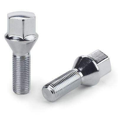

kpinnc 18,851 #53 Posted July 28, 2022 I used the bolts below for my spacers. They were a bit expensive compared to lug nuts, but they work well. I've also used allen tapered cap screws. 3 of my machines have spacers, and I've had no issues with them. 2 Share this post Link to post Share on other sites
Rob J. 1,942 #54 Posted July 28, 2022 6 minutes ago, kpinnc said: I used the bolts below for my spacers. They were a bit expensive compared to lug nuts, but they work well. I've also used allen tapered cap screws. 3 of my machines have spacers, and I've had no issues with them. That is the other option, either way is better that the stud lug. Share this post Link to post Share on other sites
Rob J. 1,942 #55 Posted July 28, 2022 7 minutes ago, kpinnc said: I used the bolts below for my spacers. They were a bit expensive compared to lug nuts, but they work well. I've also used allen tapered cap screws. 3 of my machines have spacers, and I've had no issues with them. I still like the bolts and nuts cause it gives me something to throw the tire on. 1 Share this post Link to post Share on other sites
kpinnc 18,851 #56 Posted July 28, 2022 2 hours ago, Rob J. said: I still like the bolts and nuts cause it gives me something to throw the tire on. Correct, but the spacer has studs for the wheels. But bolts and lug nuts to hold the spacer to the hub should work just as well. 1 Share this post Link to post Share on other sites

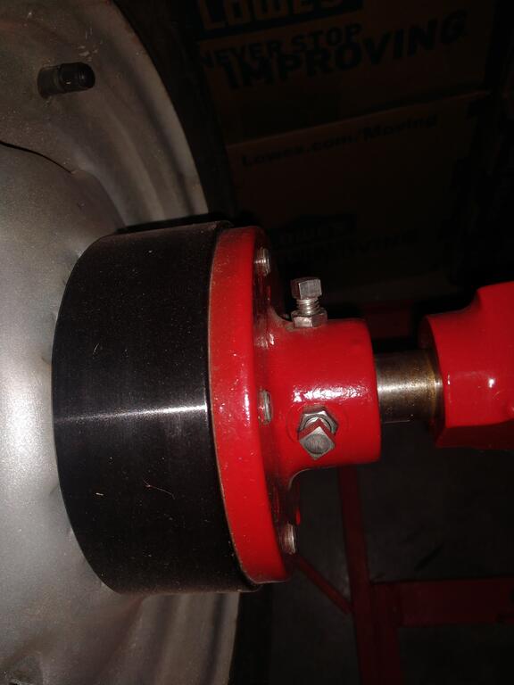

kpinnc 18,851 #67 Posted January 4 (edited) 2 hours ago, Larry Chamberlain said: 7/16×20×1 1/2 grade 8 bolts still waiting on the bolts Be aware that if you use bolts, one of the bolt heads will interfere with one of the two hub set screws. You'll likely have to remove a setscrew to install one bolt, and if you ever have to remove a hub, you'll have to remove that one bolt first... Just FYI. The setscrew on top in the pic below is where You'll have the issue. Edited January 4 by kpinnc 1 Share this post Link to post Share on other sites
ebinmaine 80,067 #68 Posted January 4 5 hours ago, kpinnc said: Be aware that if you use bolts, one of the bolt heads will interfere with one of the two hub set screws. You'll likely have to remove a setscrew to install one bolt, and if you ever have to remove a hub, you'll have to remove that one bolt first... Just FYI. I may be using different bolts.. or different set screws. We don't remove the bolt. We remove the set screw. That way I can oil down that hole. Share this post Link to post Share on other sites

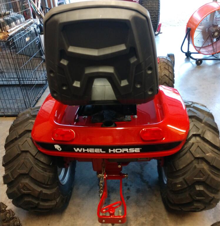

Larry Chamberlain 29 #69 Posted January 26 I finished this up a week or so ago turned out nice the 1 1/2 worked great now battling other issues 1 Share this post Link to post Share on other sites
