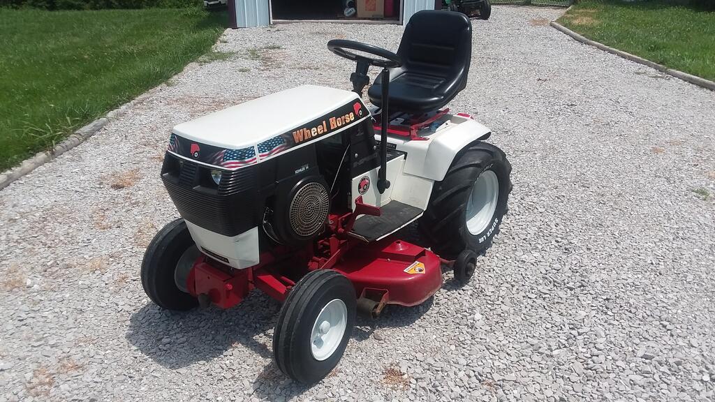

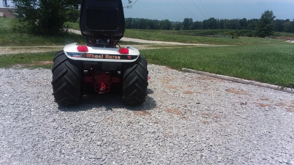

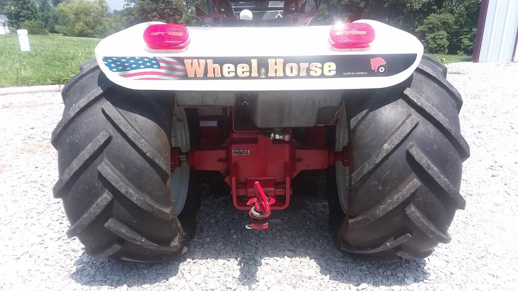

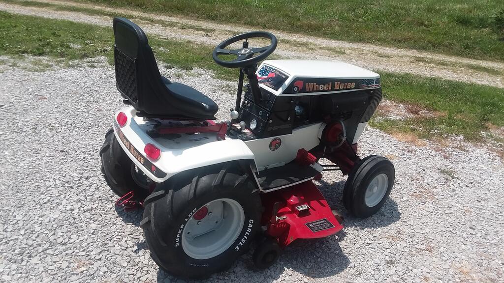

giddyap 1,574 #34 Posted April 1, 2021 Here is my C-81 I recently sold to illustrate the mods mentioned in this post to accomodate 25x10-12 tall tires. The raised seat pan also pivots up and back to access a tool box that replaced the wrap around gas tank and the cut out running boards. I dropped the front of the hood 2 inches to give the tractor a new profile. Share this post Link to post Share on other sites

Jeff-C175 7,209 #36 Posted April 1, 2021 (edited) 9 minutes ago, giddyap said: Here is my C-81 I recently sold to illustrate the mods mentioned in this post to accomodate 25x10-12 tall tires. The raised seat pan also pivots up and back to access a tool box that replaced the wrap around gas tank and the cut out running boards. I dropped the front of the hood 2 inches to give the tractor a new profile. You forgot to mention the spotting scope for the artillery! Looks great! I like the 'rake' on the hood. Edited April 1, 2021 by Jeff-C175 1 Share this post Link to post Share on other sites
