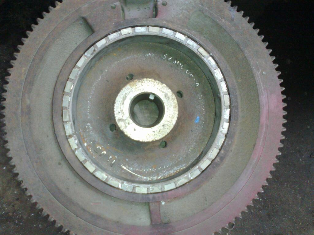

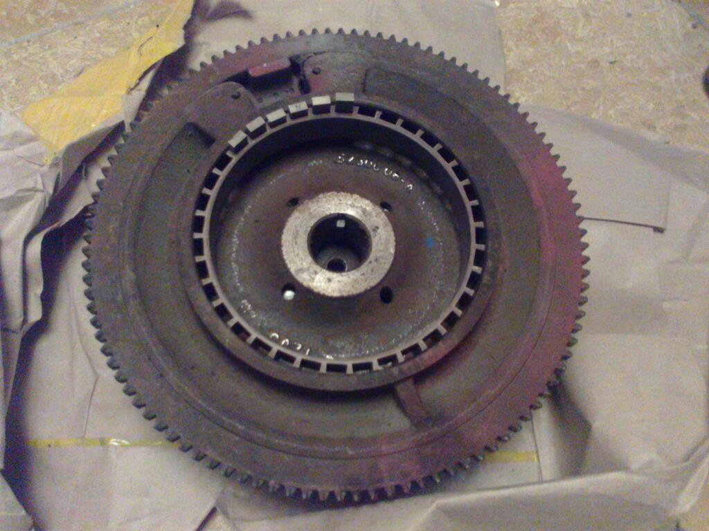

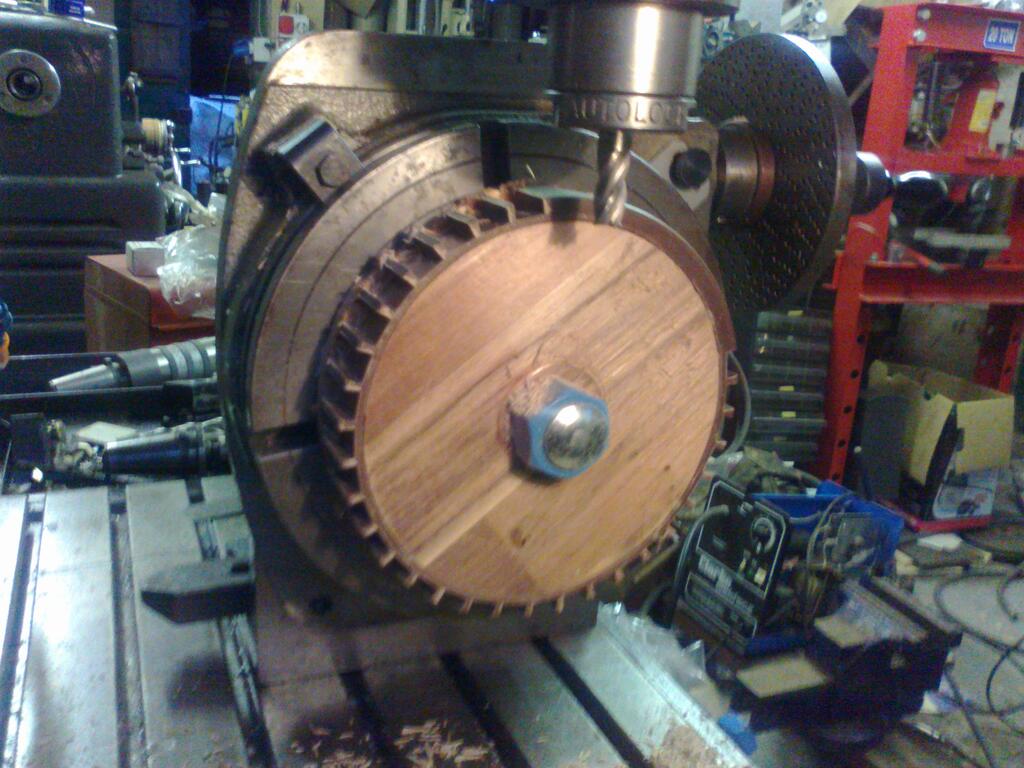

Damien Walker 297 #1 Posted March 25, 2021 My C175 is fitted with a Magnum 18 (original KT17 threw a rod) and after arriving at a friend's field with the tractor in the trailer, I tried to start it to go and do the job I had come to do. Clunk! Engine rotated a few degrees and came to a dead stop.....something was stopping it from rotating. Removing the flywheel showed that the alternator had lost a magnet or two which had dropped into the works jamming any further rotation...pulverising the magnets in the process. Problem: those magnets are not available as spares (well, I couldn't source any) and the only option available from Kohler was a complete new flywheel at great expense. Repair was possible however because luckily, I have a very well equipped workshop and so here's what I did (see photos): You can buy very powerful Neodymium magnets in all shapes and sizes (though I couldn't find the crescent shape required by this alternator). So, I machined up a Tuffnol ring that mimicked the original magnets and then milled recesses into it to accommodate the magnets. The magnets were glued in place using 24Hr epoxy and then the whole assembly was glued into the flywheel. The Tuffnol ring means the inner face of the flywheel is smooth...nothing can drop off and jam any more. The magnets are positioned with alternating poles, which means that the generating frequency will be much higher, due to there being many more magnets. I probably should have grouped them into groups of 6 of the same polarity (there's 36 in total), but I didn't think of that at the time. My approach was to simply fill the existing space with however many magnets would fit! The result is a more powerful alternator which may even be too powerful for the regulator as the ammeter always shows significant positive charge. I'm on the same battery (and regulator) some 9 years later. though..and it is still working well. 9 Share this post Link to post Share on other sites

Damien Walker 297 #7 Posted March 26, 2021 39 minutes ago, R. L. Addison said: I have a flywheel with missing magnets also, and like you I don't like the thought of buying one I am going to have to do something. I have access to a Bridgeport but no index, so I'm on the lookout for a used flywheel at this point. I too looked to find magnets, but had same luck. If you have access to a Bridgeport it should be easy. Indexing doesn't need to be very accurate, particularly if you use the same magnets and arrange the poles in groups of six. Just work out the circumferential spacing between whatever magnets you use and mark with pencil or use dividers to set the next position. All you'll need then is an angle plate arrangement and a clamping bolt. I used a Tuffnol blank (which I happened to have to hand), roughed out with a hand router and trammel and then turned in the lathe to size. I then used a wooden blank (surplus kitchen worktop!) to act as a mounting mandrel for the indexer which I also turned to size on the lathe. I can't lay my hands on the couple of magnets I had left over just at the moment to check their size, but I think they were probably 20mm x 10mm x 5mm....I'll keep looking and let you know if I find them. Share this post Link to post Share on other sites
