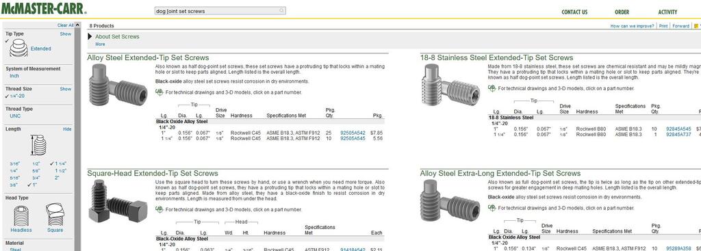

953 nut 69,728 #2 Posted March 23, 2021 https://www.mcmaster.com/set-screws/extended-tip-set-screws/alloy-steel-extended-tip-set-screws-9/thread-size~1-4-20/ 3 1 Share this post Link to post Share on other sites

953 nut 69,728 #7 Posted March 23, 2021 I use the one inch long screws, a bit longer than the units but the boot will cover it. 92505A542 is the part number. Shipping will be more than the parts but you are getting a bag of 25. 2 Share this post Link to post Share on other sites

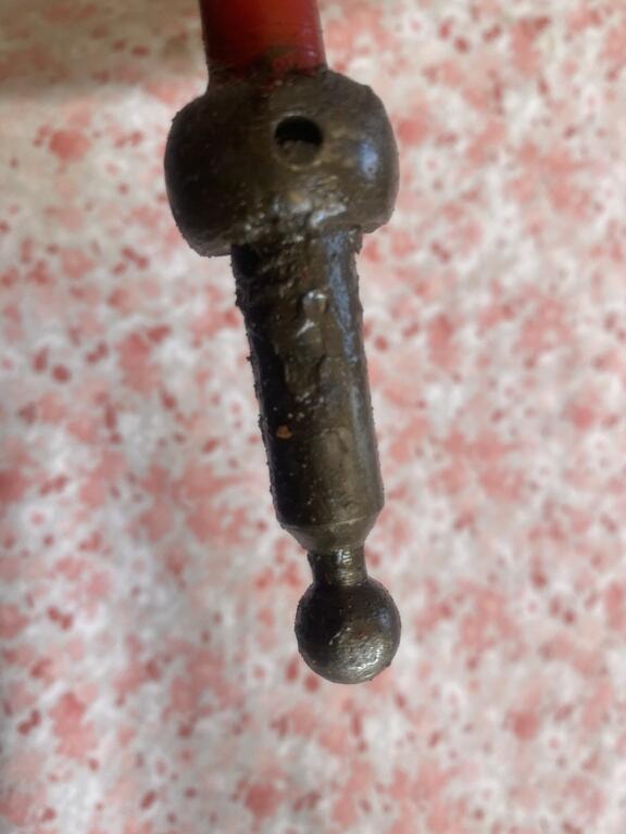

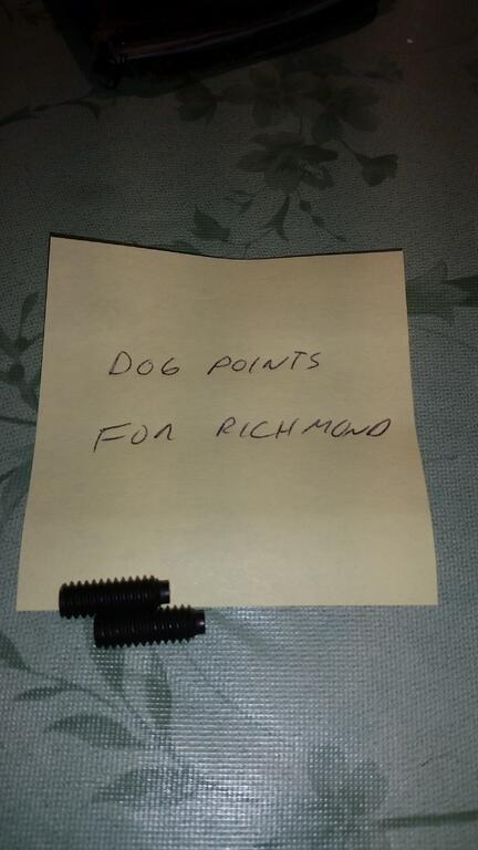

WHX?? 58,291 #14 Posted March 24, 2021 (edited) Got ya covered guy... set them out so as is I don't forget ! Ya need more than two let me know I got six left but I know Dan is holdin. I think next time I order I will get the 1 inchers. The 3/4's seem to break right at the point of the allen end and at the worst time. 'Course this one has only been in use for what 50 some years? Edited March 24, 2021 by WHX24 2 Share this post Link to post Share on other sites

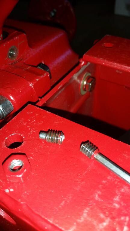

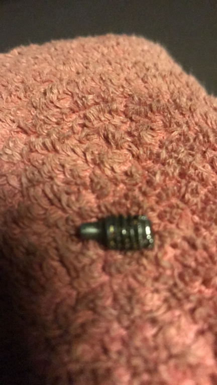

Lane Ranger 12,131 #20 Posted March 24, 2021 Here is a broken set screw Lawnman_56. (Rodney Burger ) spent thirty minutes getting out of his 854! He used a pick to slowly turn the broken screw. I buy set screws from McMaster-Carr also but buy them one inch long instead of 3/4. The location of the set screws on top of the tractor tins and the Allen wrench inset are difficult to access. The extra length helps with jam nut and access for big fingers! 5 Share this post Link to post Share on other sites

rjg854 13,399 #24 Posted March 24, 2021 Is everyone talking about a dog point screw Might as well get in on this 1 1 1 Share this post Link to post Share on other sites
Lane Ranger 12,131 #25 Posted March 24, 2021 (edited) If you ever had a problem with one you will never forget it and you will always be looking for some improvement! Just remember where your. dog point screw is going! Edited March 24, 2021 by Lane Ranger Editing script 1 Share this post Link to post Share on other sites
