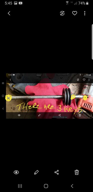

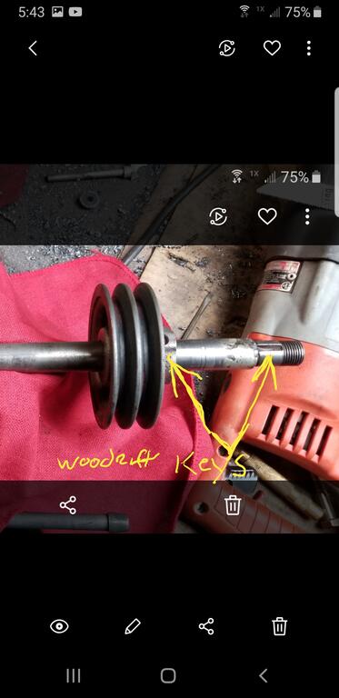

gt14rider 1,283 #4 Posted March 23, 2021 There are 3 woodruff keys on shaft. 1 on ea spindle gear. Added set screws to help keep bearings tight. Share this post Link to post Share on other sites
upstate yank 219 #5 Posted March 24, 2021 17 hours ago, gt14rider said: There are 3 woodruff keys on shaft. 1 on ea spindle gear. Added set screws to help keep bearings tight. thank you so much as now it might cut better as now I know where they go would you know the size of the key ways in case I find a few missing ;as another member did mention the caps which hold the roll pins on ;they are there ;the thing is once I remove the cap the shaft sides out from the bottom; so I am sure there are a few key ways missing or busted ;again thank you Share this post Link to post Share on other sites

gt14rider 1,283 #7 Posted March 25, 2021 If you can remove shaft from bottom, you my have a broken snap ring on top of shaft. I'll get better pics tomorrow 1 Share this post Link to post Share on other sites

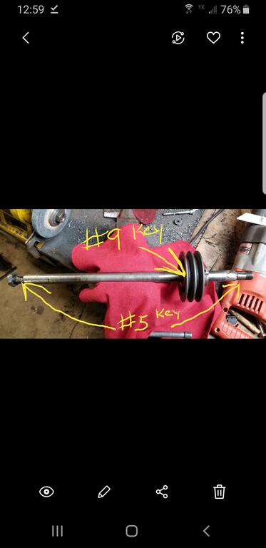

gt14rider 1,283 #8 Posted March 25, 2021 Can't sleep pn # 937084 is # 5 key Pn# 937159 is # 9 key 1 Share this post Link to post Share on other sites
upstate yank 219 #9 Posted March 25, 2021 14 hours ago, gt14rider said: Can't sleep pn # 937084 is # 5 key Pn# 937159 is # 9 key thanks so much as this is very help full now if the weather would get warmer I will be able to check if any key ways are gone or even the snap ring 'again thank you again Share this post Link to post Share on other sites
