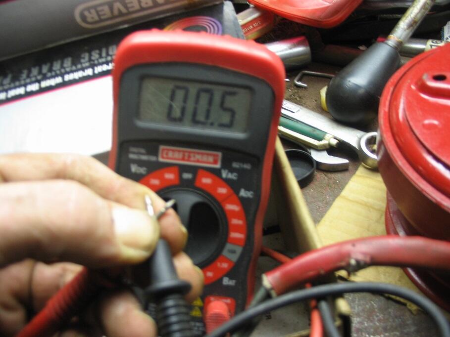

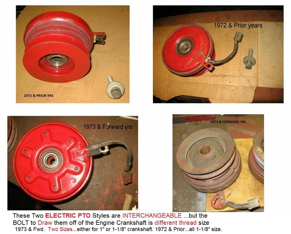

daveoman1966 3,884 #5 Posted March 23, 2021 (edited) I have worked on a bunch of the electric PTO and can provide some component pics here. The coil can be saved if the lead wires are broken at the field housing...very common... About a year ago, I stumbled on a method to re-wire the field but, dummy me, failed to copy the video to do it. It can be done however... NOTE...Do NOT use any type of gear or hub puller to remove the E-PTO from the crankshaft. Use ONLY the long bolt as shown in the last pic. Anyway..some pics: Edited March 23, 2021 by daveoman1966 2 4 Share this post Link to post Share on other sites

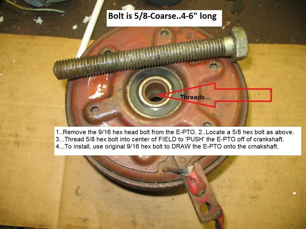

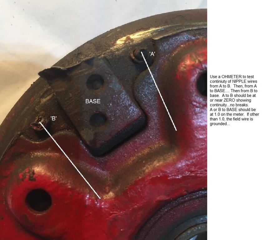

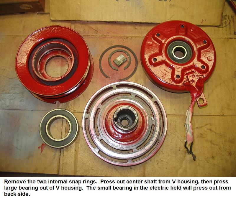

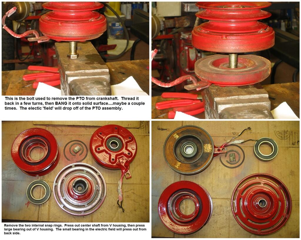

dt1990 4 #11 Posted March 23, 2021 Cool ill check it out. Thanks for the help. Share this post Link to post Share on other sites

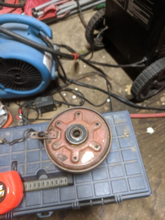

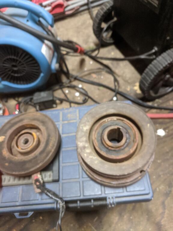

dt1990 4 #13 Posted March 26, 2021 Some pictures of the electric clutch. Still on the hunt. Share this post Link to post Share on other sites

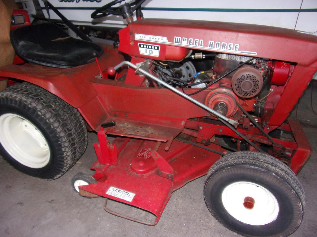

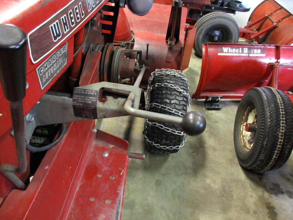

dt1990 4 #14 Posted March 27, 2021 May have found a manual pto to covert over on ebay. Not a complete set up but the pulley and clutch is they're. Anyone have some detailed pictures of a raider 10 manual set up. Planning on fabricating the lever and catch if I can. Share this post Link to post Share on other sites
pfrederi 21,176 #15 Posted March 27, 2021 Some pics. I can send you the top bracket and the rod that mounts to the block not sure how to package/ship the long handle. All yours for postage. PM me if you are interested Share this post Link to post Share on other sites

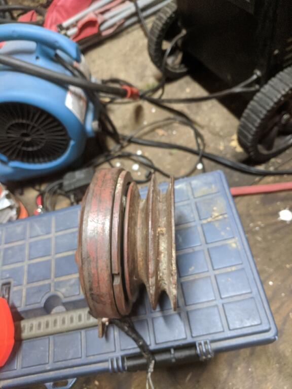

dt1990 4 #17 Posted April 6, 2021 Got the Manual pto installed and works great, even threw the mower deck and and gave it a test run. Did find that the pulley that redirects the belt down to the deck was locked up, but some pb blaster and persuasion with a pipe wrench freed it right up. Pictures to follow. 1 1 Share this post Link to post Share on other sites
