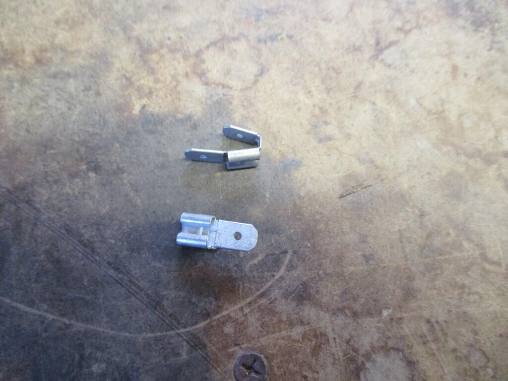

pfrederi 21,181 #3 Posted March 22, 2021 As for your connector they probably crimped both wires into one terminal. Or you could use a piggy back connector like one of these. 5 Share this post Link to post Share on other sites
Tach-a-matic 357 #4 Posted March 22, 2021 Never saw that piggyback style connector before (I learn something every day!) I am installing LED front bulbs as well so the total load on the switch should be decreasing even if after I add an LED light in the rear 3 Share this post Link to post Share on other sites

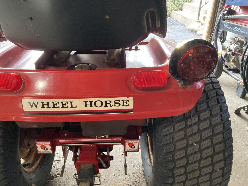

Tach-a-matic 357 #11 Posted March 23, 2021 (edited) Tonight I replaced the 72 watts of halogens with 24 watts of LED's. ...and picked up some piggyback connectors (thanks for the tip!) and ran a wire from the switch out to the back for a 6W light. I "sacrificed" the real estate of a p-side reflector and mounted it in its flat mounting area. It seems to work okay, no probs, and puts out decent light Yesterday I painted the seat pan Regal Red but it looked awful because it was so pitted. Went a little "out there" and painted it with bedliner paint to hide all the pitting and get some kind of uniform finish going. I know its not red, and I dont really like it in black myself, but its what I got to work with. The rear light is now where the right reflector was Edited March 23, 2021 by Tach-a-matic 2 Share this post Link to post Share on other sites

Tach-a-matic 357 #15 Posted March 23, 2021 (edited) relocated the light a la Mr Sylvan Lake's spot Edited March 23, 2021 by Tach-a-matic 1 1 Share this post Link to post Share on other sites
Tuneup 1,459 #16 Posted March 24, 2021 My 125 came with rear lighting, not that the pan was in any shape to be retained. That krinkle finish is a nice base for a Regal Red overspray, right? I'm assuming that finish can be painted - maybe not. Nice job on the lighting! Share this post Link to post Share on other sites
