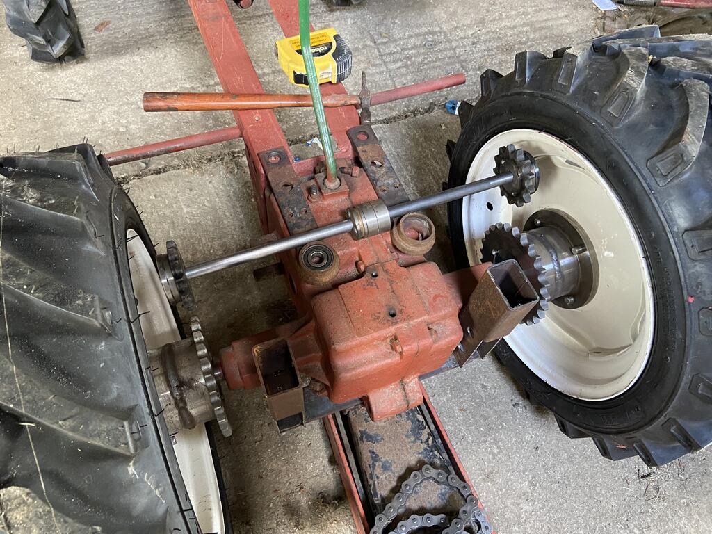

Jeff-C175 7,211 #51 Posted March 26, 2021 Some sort of locking diff? 3 Share this post Link to post Share on other sites

meadowfield 3,191 #56 Posted March 26, 2021 3 hours ago, Jeff-C175 said: Some sort of locking diff? 10 house points! 3 Share this post Link to post Share on other sites

ACman 7,746 #58 Posted March 26, 2021 (edited) Where’s the turning brakes at ? .... Edited March 26, 2021 by ACman 1 Share this post Link to post Share on other sites

Pullstart 71,356 #63 Posted March 27, 2021 Selectable exterior locker! Woo hoo! There’s just no more room inside that case, huh Mark? 1 Share this post Link to post Share on other sites
Stormin 9,988 #64 Posted March 27, 2021 19 hours ago, Jeff-C175 said: I wanna cash out! Is that enough for a pint or two? I'll have them for you. I'm a bit nearer. Just a couple of thoughts. That dog clutch for a winch. Or even more wrong. Front wheel drive only. Share this post Link to post Share on other sites
8ntruck 9,333 #65 Posted March 27, 2021 3 hours ago, pullstart said: Selectable exterior locker! Woo hoo! There’s just no more room inside that case, huh Mark? Ya know, that's not a half bad idea. Would be easy to make and install. Might even be able to include turning brakes in the assembly. 2 Share this post Link to post Share on other sites

meadowfield 3,191 #68 Posted March 27, 2021 4 hours ago, pullstart said: Selectable exterior locker! Woo hoo! There’s just no more room inside that case, huh Mark? there is, but I figured if I make an external one this time it's possibly easier for you guys to copy 1 1 2 Share this post Link to post Share on other sites
ACman 7,746 #69 Posted March 27, 2021 (edited) Could you add some disc on the shaft and mount the caliber somewhere? Simple hydraulic setup for go kart . Edited March 27, 2021 by ACman 3 1 Share this post Link to post Share on other sites
meadowfield 3,191 #70 Posted March 28, 2021 (edited) 16 hours ago, ACman said: Could you add some disc on the shaft and mount the caliber somewhere? Simple hydraulic setup for go kart . Jeff, I had considered that, but given two of my bigger tractors have them and I've never used them, I thought it was overkill. Note the Difflock on the John Deere is used a lot in conjunction with 4WD.... and I see it as more useful. Edited March 28, 2021 by meadowfield 1 Share this post Link to post Share on other sites
Pullstart 71,356 #71 Posted March 28, 2021 I’m sure I’ll see the story unfold soon... but this is saying it can be engaged within 1/3 of a slipped rotation? Since it doesn’t guarantee engagement right now, will the fork be spring loaded? Let it slip into place slowly? 1 Share this post Link to post Share on other sites
meadowfield 3,191 #72 Posted March 28, 2021 32 minutes ago, pullstart said: I’m sure I’ll see the story unfold soon... but this is saying it can be engaged within 1/3 of a slipped rotation? Since it doesn’t guarantee engagement right now, will the fork be spring loaded? Let it slip into place slowly? given the gearing, it will be about 1/6 rotation as the pinions on the end increase the speed. Not worked out how the engage will work, it ideally needs springs to pull it out as it will naturally lock and not want to release. It will be using the High low shifter to lock it - thus retaining the original wheel horse look. 1 1 Share this post Link to post Share on other sites
Pullstart 71,356 #73 Posted March 28, 2021 31 minutes ago, meadowfield said: given the gearing, it will be about 1/6 rotation as the pinions on the end increase the speed. Not worked out how the engage will work, it ideally needs springs to pull it out as it will naturally lock and not want to release. It will be using the High low shifter to lock it - thus retaining the original wheel horse look. Would low be auto locking then? Awesome! 1 Share this post Link to post Share on other sites
