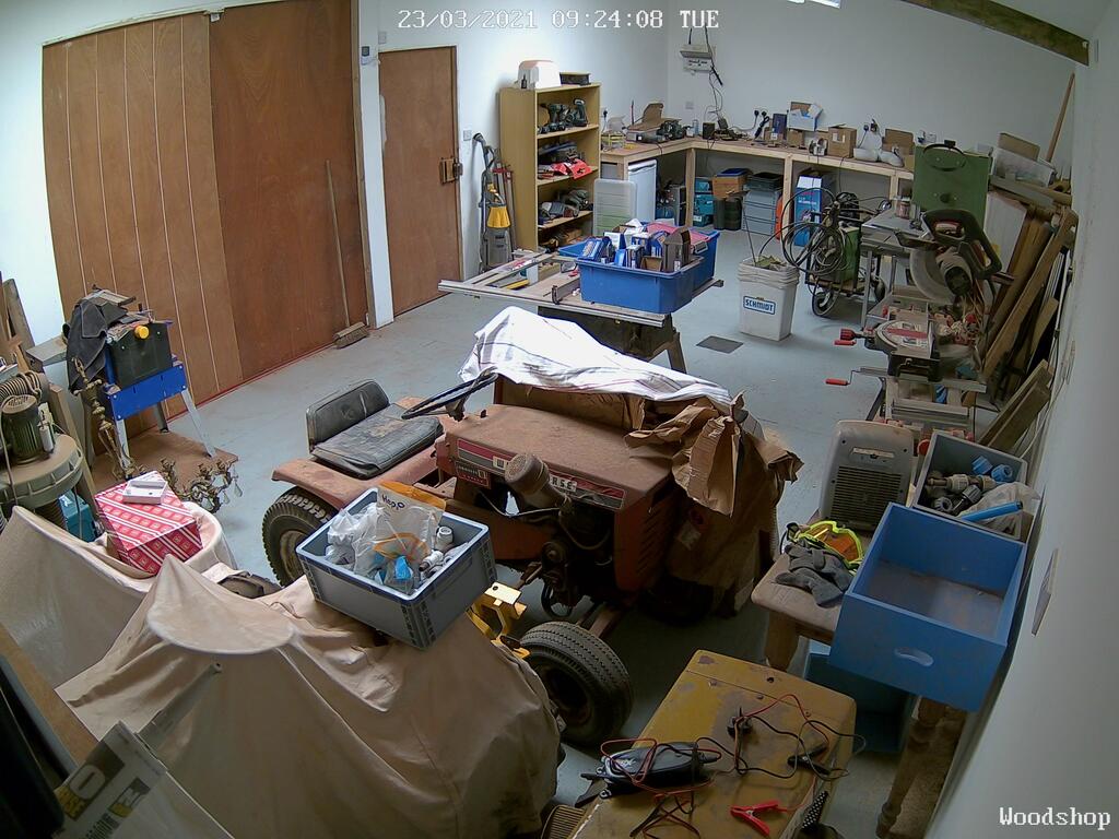

squonk 48,156 #31 Posted March 23, 2021 (edited) Better get that thing off of those work mates before it decides to get on the floor on it's own! Also I hope that's styrofoam on top of that shelf! Edited March 23, 2021 by squonk Share this post Link to post Share on other sites
ohiofarmer 3,494 #32 Posted March 23, 2021 (edited) 43 minutes ago, squonk said: Better get that thing off of those work mates before it decides to get on the floor on it's own! Also I hope that's styrofoam on top of that shelf! Now my yank brain just cannot figger this out. Are the tyres mounted this way to compensate for driving on the other side of the road? Also, are the plows made to turn the furrows over on the left side of the tractor? How about Australia where the water circles in reverse going down the drain??? Maybe somehow that makes a double reverse condition and everything cancels out, I suppose Edited March 23, 2021 by ohiofarmer 5 Share this post Link to post Share on other sites
cschannuth 3,821 #33 Posted March 23, 2021 14 minutes ago, ohiofarmer said: Now my yank brain just cannot figger this out. Are the tyres mounted this way to compensate for driving on the other side of the road? Also, are the plows made to turn the furrows over on the left side of the tractor? How about Australia where the water circles in reverse going down the drain??? Maybe somehow that makes a double reverse condition and everything cancels out, I suppose Maybe it’s going to be four-wheel-drive… A wealthy hog farmer who lives near me turns the front tires around backwards on every tractor he buys so that he has better traction when backing out of his hog farming operation areas that are really muddy. Or maybe he just threw them on there to see how it looks and didn’t realize he had them turned around. 2 Share this post Link to post Share on other sites
meadowfield 3,191 #34 Posted March 23, 2021 17 minutes ago, ohiofarmer said: Now my yank brain just cannot figger this out. Are the tyres mounted this way to compensate for driving on the other side of the road? Also, are the plows made to turn the furrows over on the left side of the tractor? How about Australia where the water circles in reverse going down the drain??? Maybe somehow that makes a double reverse condition and everything cancels out, I suppose haha, I just chucked the wheels on for the picture, so they are indeed on backwards... now the fronts probably will be mounted in reverse as apparently that works best on 2wd. 4 Share this post Link to post Share on other sites

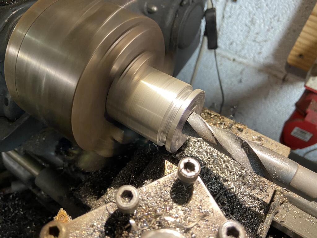

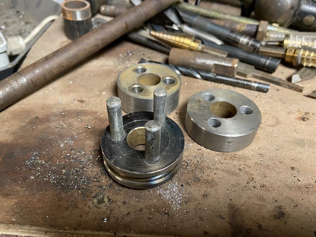

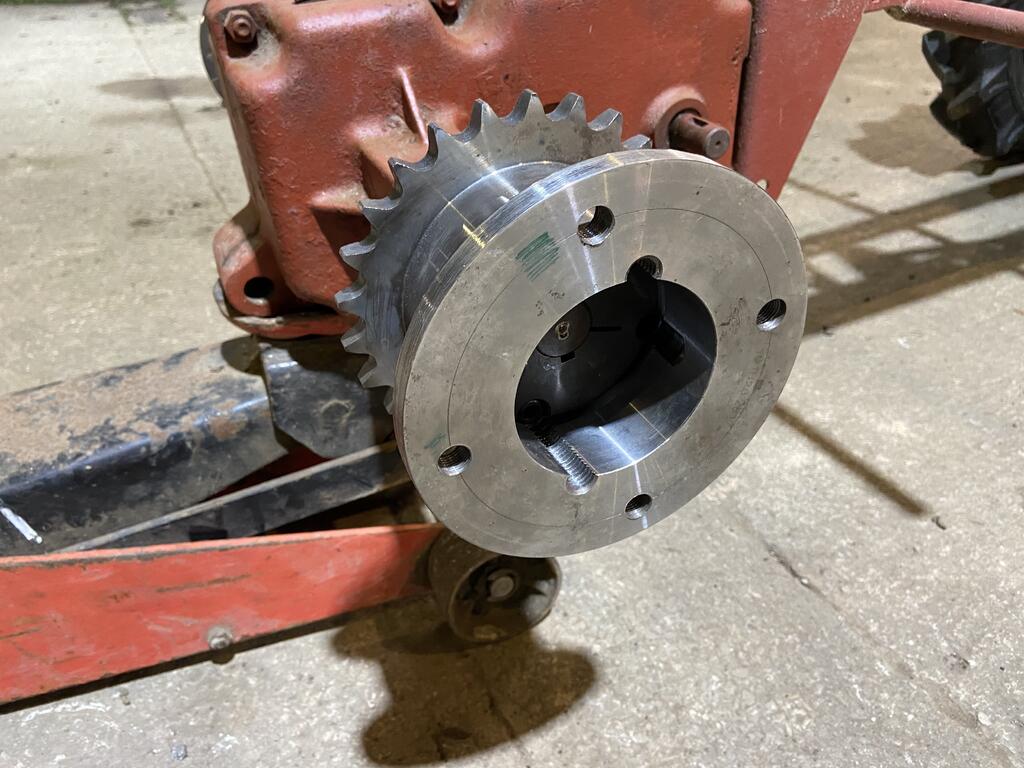

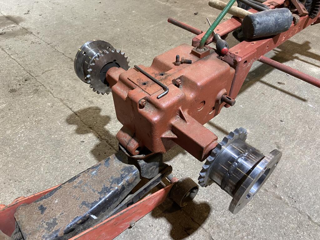

meadowfield 3,191 #35 Posted March 25, 2021 A bit of time on the lathe and the next phase begins. Firstly the rear track just didn't look right, so I've added 2" either side and rather than buy spacers - which are expensive.... I made my own and there is the first clue to my something special with the transmission. you can either take a guess - or watch this space! 4 6 Share this post Link to post Share on other sites
Stormin 9,988 #36 Posted March 25, 2021 18 minutes ago, meadowfield said: you can either take a guess - or watch this space! I can think of several things, but they'd no doubt all be wrong. 2 Share this post Link to post Share on other sites
Oldskool 6,678 #37 Posted March 25, 2021 I have a couple ideas, but im just gonna keep watchin for now. Looking good so far. I love it when something out of the ordinary pops into a build. 4 Share this post Link to post Share on other sites
ebinmaine 80,765 #38 Posted March 26, 2021 42 minutes ago, Oldskool said: I have a couple ideas, but im just gonna keep watchin for now. Looking good so far. I love it when something out of the ordinary pops into a build. Pretty much what I was thinking too.. 3 1 Share this post Link to post Share on other sites
Mickwhitt 5,259 #39 Posted March 26, 2021 Chain drive? Looks exotic. 2 Share this post Link to post Share on other sites
Tractorhead 9,217 #40 Posted March 26, 2021 Have a little bit the charme of Steampunk i like it 2 Share this post Link to post Share on other sites
Mickwhitt 5,259 #41 Posted March 26, 2021 Im pretty sure I'm going out on a limb early, but this has to be a tracked version. Those sprockets look way too big for chain drive. And you did say you were aiming for unique and something everyone else wants. Mick 2 Share this post Link to post Share on other sites
meadowfield 3,191 #42 Posted March 26, 2021 Just now, Mickwhitt said: Im pretty sure I'm going out on a limb early, but this has to be a tracked version. Those sprockets look way too big for chain drive. And you did say you were aiming for unique and something everyone else wants. Mick nice try, but I thought the wheels gave it away... it's definitely running on wheels! 2 Share this post Link to post Share on other sites
Mickwhitt 5,259 #43 Posted March 26, 2021 Thought it was a double blind. I'll sit back and watch lol 2 Share this post Link to post Share on other sites
Oldskool 6,678 #44 Posted March 26, 2021 Rear 4 wheel drive? Share this post Link to post Share on other sites
meadowfield 3,191 #45 Posted March 26, 2021 10 minutes ago, Oldskool said: Rear 4 wheel drive? thats a good guess - like your thinking... but not right... 2 Share this post Link to post Share on other sites
rjg854 13,380 #46 Posted March 26, 2021 I'll just wait and see 1 1 Share this post Link to post Share on other sites
Jeff-C175 7,211 #47 Posted March 26, 2021 Chains to run a calliope you'll pull behind the machine during parades? <--see what I did there? 1 1 Share this post Link to post Share on other sites

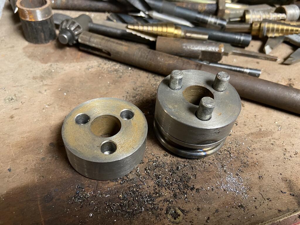

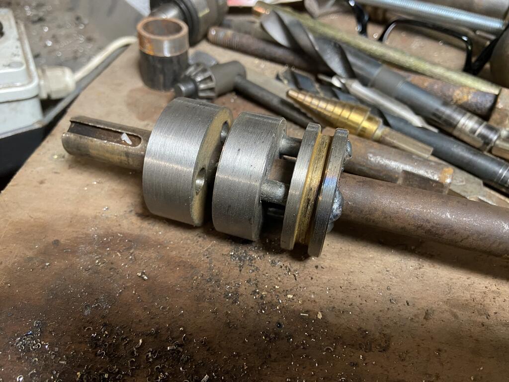

meadowfield 3,191 #49 Posted March 26, 2021 (edited) a few more clues... can you tell what it is yet? Edited March 26, 2021 by meadowfield 1 Share this post Link to post Share on other sites
Oldskool 6,678 #50 Posted March 26, 2021 20 minutes ago, meadowfield said: a few more clues... can you tell what it is yet? I'm still stumped. I'm assuming the groove might be for a lever/clutch fork of sorts? The pins to engage/disengage? Share this post Link to post Share on other sites
