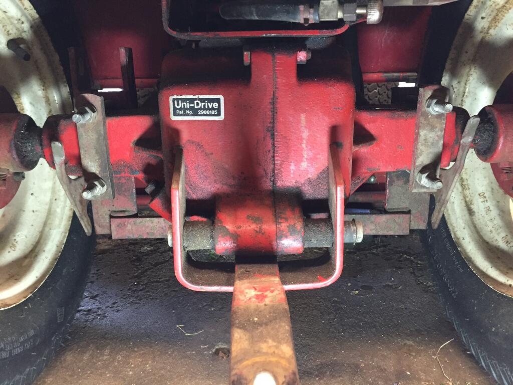

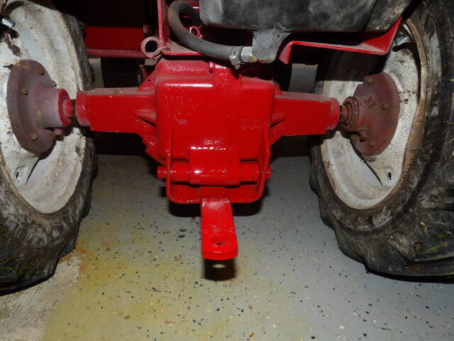

Tach-a-matic 357 #1 Posted March 21, 2021 (edited) After painting and reinstalling my unit I realized there is a lot of side to side play. Is this normal? I dont recall this much on my previous Horse's Edited March 21, 2021 by Tach-a-matic 1 Share this post Link to post Share on other sites
oldlineman 1,814 #2 Posted March 21, 2021 there should be shims on each side of transmission hount. 6 Share this post Link to post Share on other sites

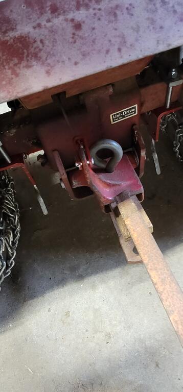

squonk 48,215 #4 Posted March 21, 2021 Or add a slot hitch and double hitch it! 4 1 3 Share this post Link to post Share on other sites

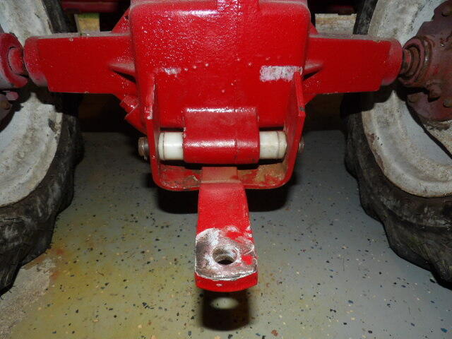

SylvanLakeWH 32,698 #5 Posted March 21, 2021 You can see the spacers in this pic... any small pipe cut to size will do... 5 3 Share this post Link to post Share on other sites
Tach-a-matic 357 #6 Posted March 21, 2021 Ohhhh that explains it, thanks! Will get some pipe Judging by the witness marks on the case L & R its been without the spacers for some time. 4 Share this post Link to post Share on other sites
haydendavid380 759 #7 Posted March 22, 2021 (edited) 4 hours ago, squonk said: Or add a slot hitch and double hitch it! This! If the pins out, you can probably find a slot hitch for $15-$20. That's a no brainer. Edited March 22, 2021 by haydendavid380 2 Share this post Link to post Share on other sites
Achto 32,844 #8 Posted March 22, 2021 48 minutes ago, haydendavid380 said: you can probably find a slot hitch for $15-$20. That's a no brainer. If you don't have a lift cable for the slot hitch. That will be an added $60 to get a new one, not sure on a used price. 3 Share this post Link to post Share on other sites
The Tuul Crib 7,354 #9 Posted March 22, 2021 13 hours ago, Tach-a-matic said: Ohhhh that explains it, thanks! Will get some pipe Judging by the witness marks on the case L & R its been without the spacers for some time. Since that's the case if its been missing for a while you might want to check the drain plug on the bottom of the transmission. It may have rubbed on it for so long you may not be able to get it off. 4 Share this post Link to post Share on other sites

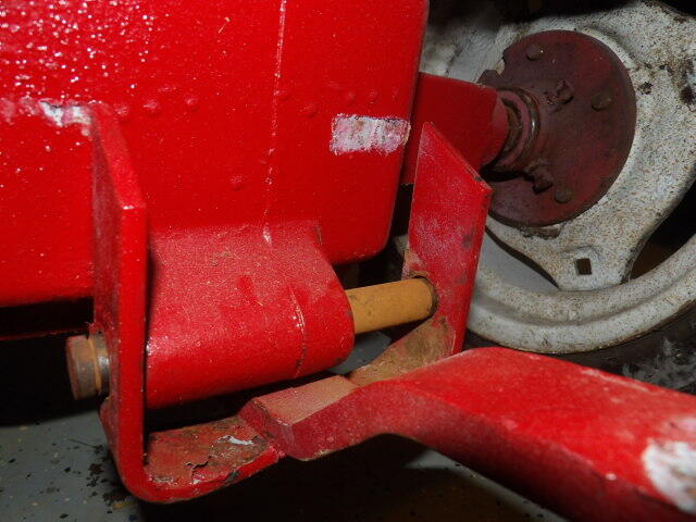

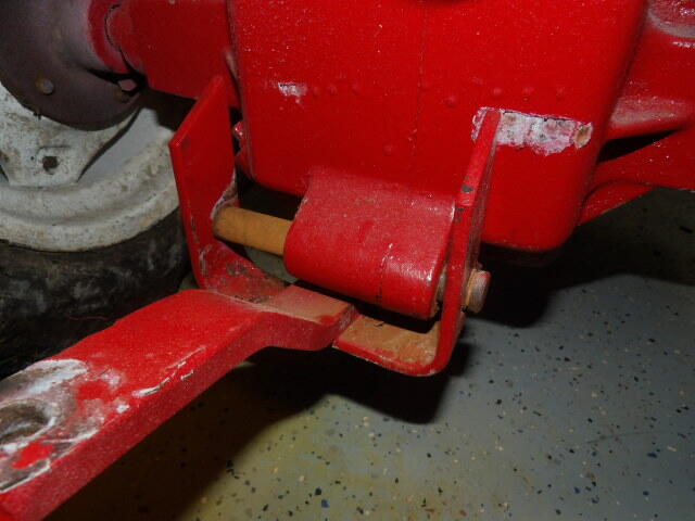

Snoopy11 5,731 #10 Posted August 5, 2022 (edited) Bumping an old thread... Here is what happens when you have this side to side movement and try to pull heavy objects... The fix via nylon spacers: Me likey... Don Edited August 5, 2022 by Snoopy11 Share this post Link to post Share on other sites
peter lena 10,090 #11 Posted August 5, 2022 @Tach-a-matic if you grease that pin , the natural movement will keep that totally , slick all the time , zero rust , pete 1 1 Share this post Link to post Share on other sites
