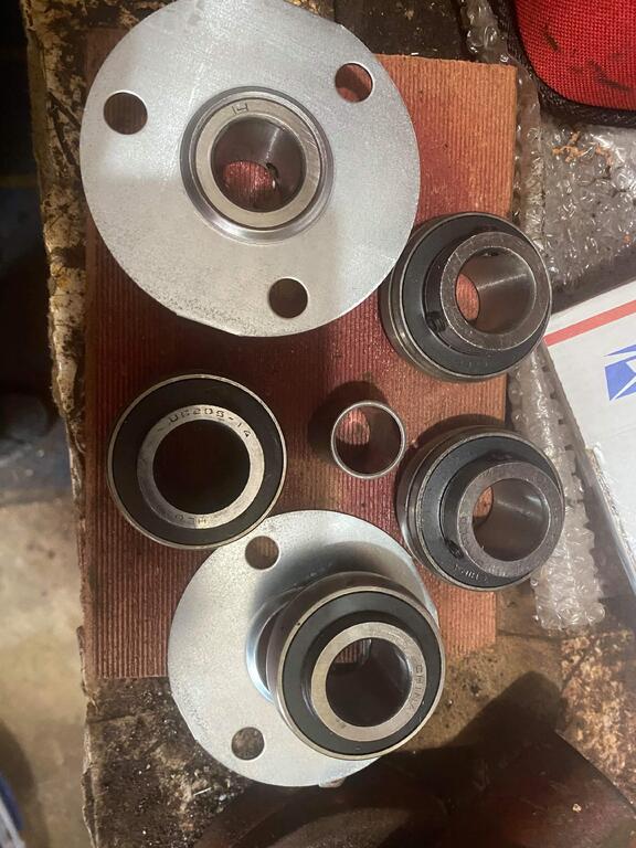

Lane Ranger 12,094 #5 Posted March 22, 2021 https://thebigbearingstore.com/3-bolt-round-stamped-housing-52mm-od-bearings/ I found a supplier and the flanges for the sickle frame box are three hole 5/16 square that fit 205 bearings. 52MS lots of suppliers once you have the correct part number! The original Wheel Horse manuals listed the bearing and flanges together with a Wheel Horse bearing number. Share this post Link to post Share on other sites
giddyap 1,574 #6 Posted March 23, 2021 (edited) surpluscenter.com generic Edited March 23, 2021 by giddyap Share this post Link to post Share on other sites
gwest_ca-(File Mod) 12,483 #7 Posted March 23, 2021 Those bearing retainers must be different for some applications. I recall the most common available 3/4" bearing for the snowthrowers would not fit. The most common available 7/8" bearing retainers would fit so members were adding a bushing to get the ID down to 3/4". There was a substantial cost saving doing this. Garry 1 Share this post Link to post Share on other sites
WHX?? 58,069 #8 Posted March 23, 2021 3 hours ago, gwest_ca said: adding a bushing to get the ID down to 3/4". Exactly what I did..... 1 Share this post Link to post Share on other sites
Lane Ranger 12,094 #9 Posted March 23, 2021 I did that too on my last rebuild! That was Robert Maynard’s snowblower rebuild info posted when he redid his bearings on one. Share this post Link to post Share on other sites
