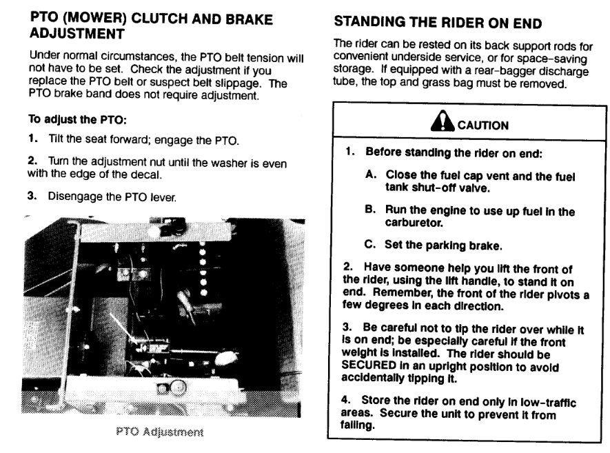

gwest_ca-(File Mod) 12,260 #3 Posted March 20, 2021 I do not know the answer but suspect this operator manual will help Click on the picture Garry Share this post Link to post Share on other sites

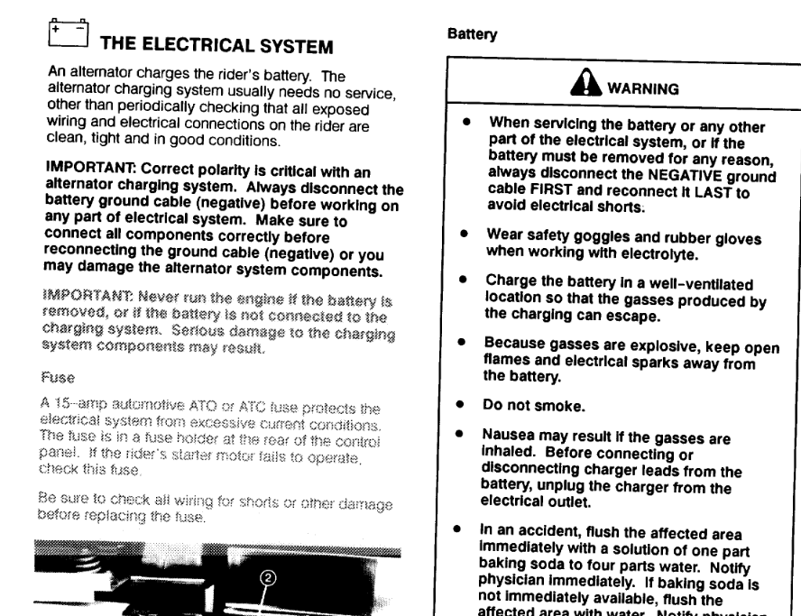

Gregor 4,848 #4 Posted March 20, 2021 (edited) It looks a lot like my old Snapper. It's made to be stood on end. This doesn't say anything about the battery, but if it were mine, I would remove it. If it has one of course Edited March 20, 2021 by Gregor 1 Share this post Link to post Share on other sites

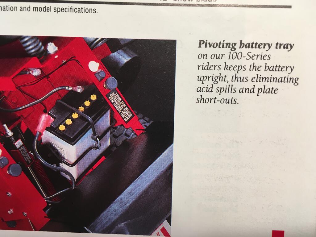

evanloock 254 #5 Posted March 20, 2021 I believe that model had a swinging battery tray. When the tractor was stood on end, the battery tray swung keeping the battery upright. 2 Share this post Link to post Share on other sites
evanloock 254 #6 Posted March 20, 2021 From a 1988 brochure. 2 Share this post Link to post Share on other sites
Gregor 4,848 #7 Posted March 20, 2021 OK My Snapper didn't have that! Whooda thunk ? 1 Share this post Link to post Share on other sites

TOra 1 #10 Posted March 20, 2021 Wheelhorse Tora 110-4 which I bought from new in 1991, it has been in storage for 26 years. I have got it started but want to check condition of blade and also store it in the vertical position I have checked original manual and it says you can store it vertically and shows a photo of it vertical in the manual and gives a description of procedure, it does not say that you have to drain the oil. I am concerned that if I do not drain the oil it might creat a problem 1 Share this post Link to post Share on other sites

Handy Don 16,713 #12 Posted March 20, 2021 (edited) I have a late 90's Snapper rider with a 12.5 HP vertical shaft and it specifically permits being stored on end (with oil inside) BUT only with the battery removed--otherwise upend it for only an hour for maintenance. I do stand it to hone the blade and clean the underside of the deck at two or three times a season. I tend not to run it afterward until the next mowing opportunity, though, and I store it on its wheels. As @Jeff-C175 explained, its how the engine is oriented that matters. If no battery involved, the fuel system cannot leak, and neither the cylinder nor the crankcase vent are pointed downward, the odds are better that upright storage will not cause problems. Upright storage was a big selling point in the 90's so since the manual says its permitted, and since it doesn't mention oil removal, you are probably ok. Edited March 20, 2021 by Handy Don 1 Share this post Link to post Share on other sites
