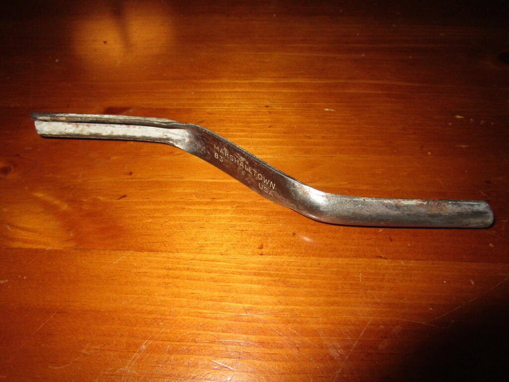

JCM 10,802 #4 Posted March 20, 2021 FYI Marshalltown or W.Rose Company sell quality brick jointers. A concave jointer is what you would need to replicate that type of a joint. Used where freeze and thaw cycles are not an issue on exterior work. The opposite of this tool. 1 Share this post Link to post Share on other sites

8ntruck 8,632 #6 Posted March 21, 2021 16 hours ago, JCM said: FYI Marshalltown or W.Rose Company sell quality brick jointers. A concave jointer is what you would need to replicate that type of a joint. Used where freeze and thaw cycles are not an issue on exterior work. The opposite of this tool. Yup. That's the one I want. Spent time today removing more trim pieces to see how the roof is framed, and did some measuring and sketching. Tightened up the jacks too. Seems they have compressed the ground a little. Turn out that the main beam across the front of the porch is a touch over 30 feet long and made out of three 2x12's spliced over the center column. They are also in the process of rotting out over the center column. Replacement is necessary. Took another look at the joists too - looking better than at first glance yesterday. Spent time on line looking up beam equations, lumber properties, and snow loads for this area. After turning the crank, looks like a 30 foot 3.5" x 14" lvl beam will replace what is there. Have to check the local lumber yards for availability, price, and delivery next week. Will check with the building office for permitting needs too. 2 Share this post Link to post Share on other sites
