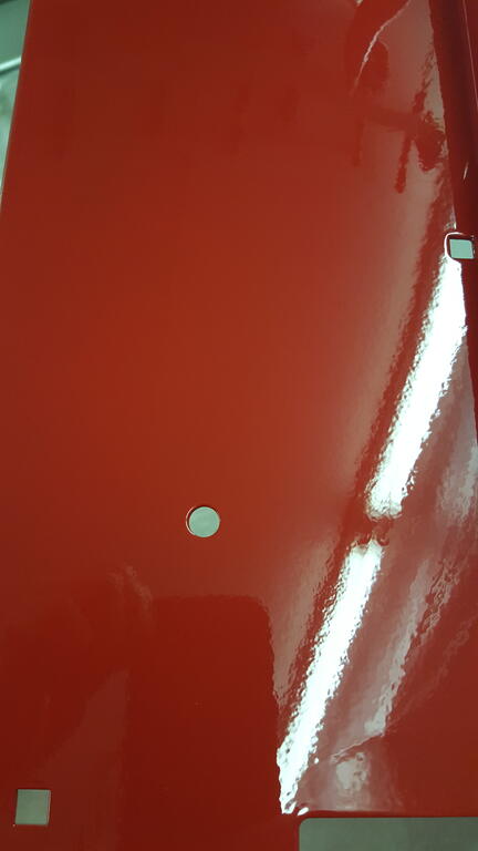

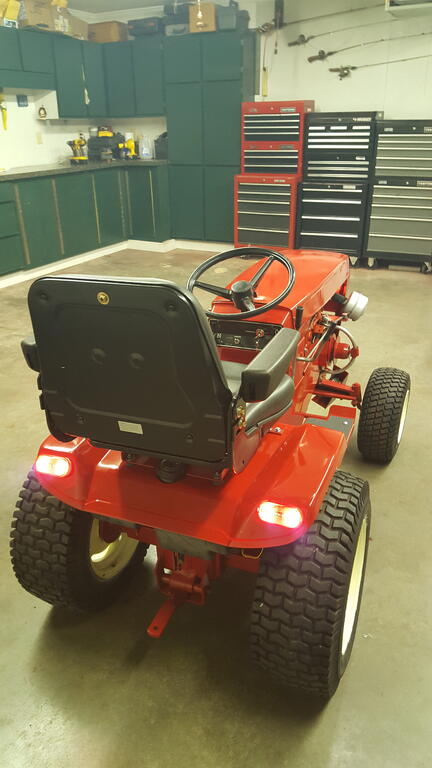

Gregor 4,848 #12 Posted March 19, 2021 16 minutes ago, Achto said: I prefer to heat the garage and paint when it is cold out side. My reason - I can adjust my dry times ( wait longer between coats if needed ) and there aren't any bugs that are going to fly into my wet paint & screw it up. If you can keep your garage 65 to 75 degrees with no more that 65% humidity, you will be fine. High humidity will slow dry times, but will not ruin a paint job. ( Unless you are spraying lacquer, which is almost impossible to get now days anyway ) I like the idea of no bugs. Been there, done that. I painted this with Lacquer from a can. BY FAR The best finish I have ever got out of a rattle can. Are you saying the humidity level for lacquer needs to be less than 65%? Chinese Red from Menards. $3.50 2 coats of clear on top. 27 cans in stock at various stores within 40 miles of me. I ALWAYS worry about humidity. 1 Share this post Link to post Share on other sites
seuadr 490 #13 Posted March 19, 2021 1 minute ago, Gregor said: I painted this with Lacquer from a can. i came here, disappointed that there were no strippers, but you've redeemed the thread - damn that is a fine looking horse! in all seriousness - i came here looking for stripping of paint as well, thanks for sharing! 1 Share this post Link to post Share on other sites
Achto 32,891 #14 Posted March 19, 2021 2 minutes ago, Gregor said: Are you saying the humidity level for lacquer needs to be less than 65%? Extreme humidity can make lacquer turn white & blotchy with poor gloss. I had this happen with black out of a gun on a hot humid day. Share this post Link to post Share on other sites
Gregor 4,848 #15 Posted March 19, 2021 After reading all this and thinking about it, I think maybe right now may be the very best time to paint. No bugs! The humidity outside right now is 59%. Not great but maybe not terrible??? I can run my heat up as high as I want, and I usually want a lot! . all for your help. 1 Share this post Link to post Share on other sites
pacer 3,181 #16 Posted March 19, 2021 I'm really surprised that you can still get Lacquer!!! Years ago I LOVED to paint with it, and actually did a few really nice jobs. Best one was a 1959 Jaguar in GM's white I did for my wife ... that gal loved that car!! It is a bit finicky about temp, humidity, viscosity, etc but as Gregor shows it can sure POP! 1 Share this post Link to post Share on other sites

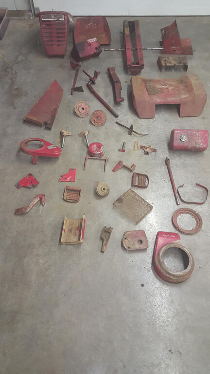

Gregor 4,848 #24 Posted March 19, 2021 I took 42 pieces to the stripper. Everything from the hood and seat pan, to the front spindles, and rear hubs. We'll see how long that takes. More importantly how many $$$$$ Share this post Link to post Share on other sites
