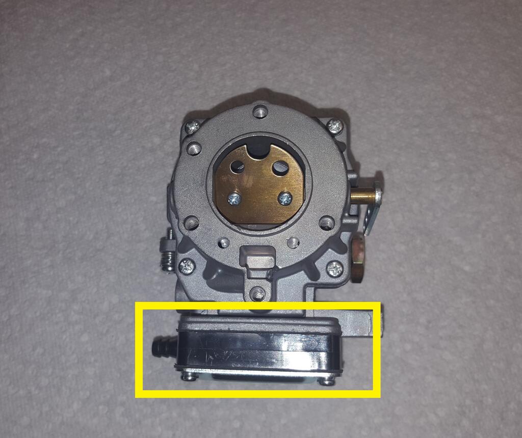

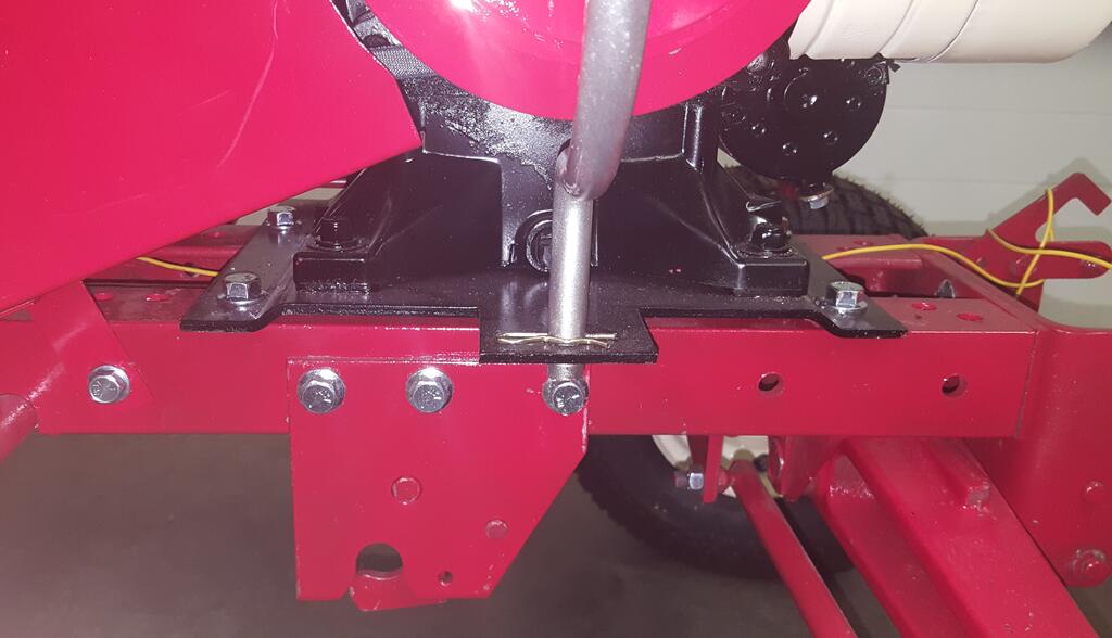

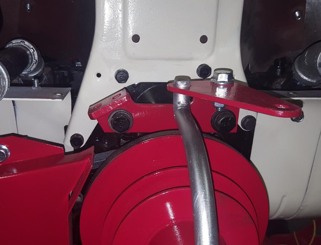

MikMacMike 494 #79 Posted July 20, 2021 On 7/9/2021 at 9:22 AM, Gregor said: My C-175 came with the Briggs 18 Twin on it. Model # 422437 Type 1049 01. I have not seen a C-175 with the Kohler on it, so I cannot tell you the differences between the two. I can say that the shaker plate was completely removed, and the frame re-drilled for the Briggs. I replaced the belt. I am 99% sure it is an 85" belt, but it's been a while. (still waiting on parts) All of the safety switches had been by-passed. I am using the brake pedal safety switch, but not the PTO switch. I don't plan on having any implements on the tractor at this time. The Briggs has magneto ignition, and has the correct ignition switch. I don't know what the Kohler is. It looks to me as though the PTO Housing Rod has been cut off at the top. I don't know why anyone would have done this, but it just seems short to me. I ordered a new carb, and also bought a rebuild kit for the old one. The rebuild kit came with the parts necessary to rebuild the integrated fuel pump also. It cleaned up well, so I reused the old carb. When I check the tracking number for my parts from Lincoln, it simply say, "In Transit Arriving Late" It has said that for the last 6 days. Where you said the rod seems short at the top I had the same thing. the split pin on the bottom of mine was the same as yours too, so I added an 1/8" washer which brought it back up to hieght. Now I should mention though!!! watch your centers where it conects to the shaft to the bearing, that should be as close to center as possible. Share this post Link to post Share on other sites

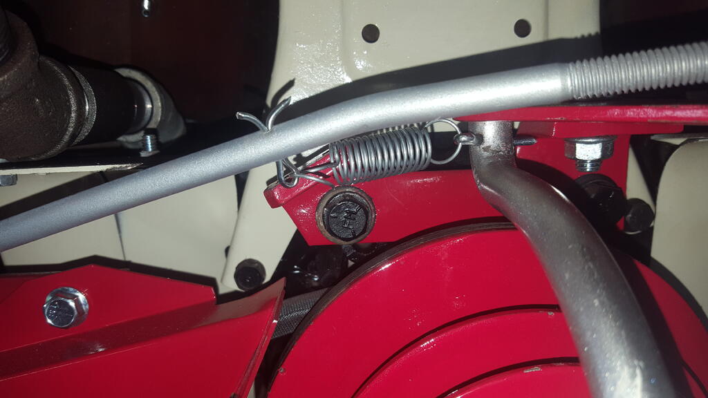

Gregor 4,847 #80 Posted July 20, 2021 This is my fix. I turned the cotter pin upside down in the PTO rod, and drilled a hole in the PTO housing rod, and added a cotter pin there. Bought a generic spring, and all is good I think. Share this post Link to post Share on other sites
