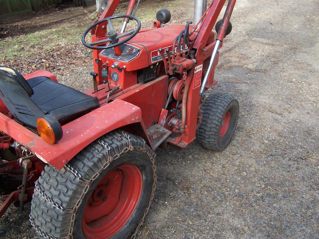

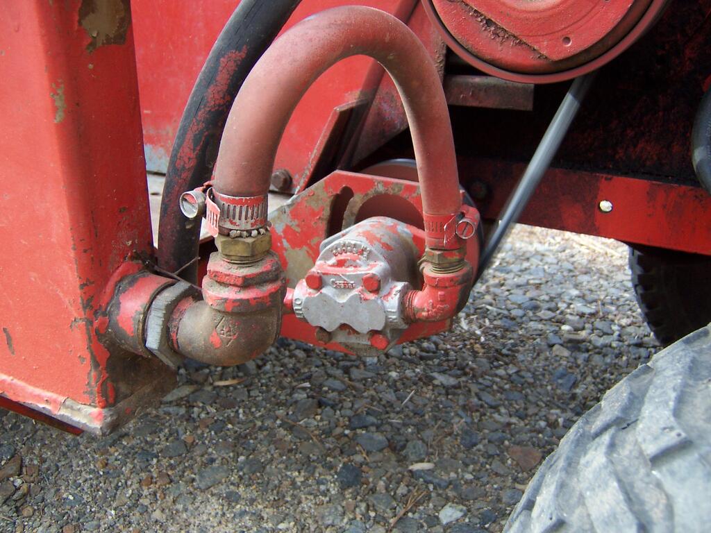

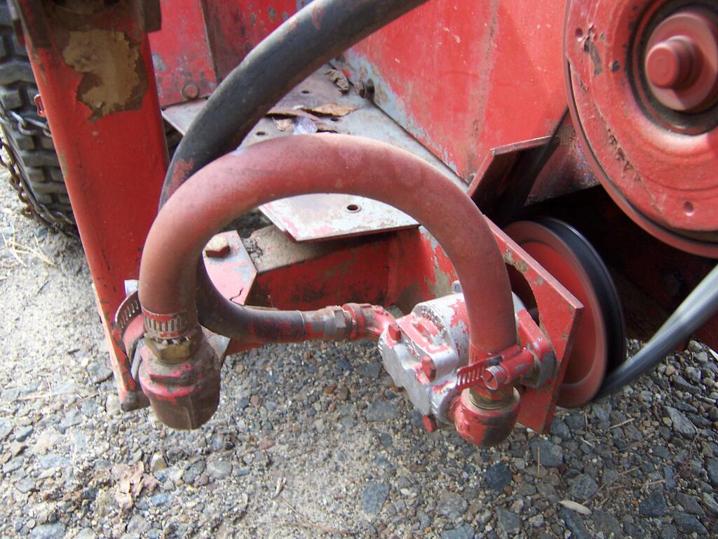

953 nut 69,825 #2 Posted March 17, 2021 My Johnson Workhorse FEL is on a GT-14 which is very much like the 953/1054. Here are a couple shots of the pump. 6 Share this post Link to post Share on other sites
ricksrj58 279 #3 Posted March 18, 2021 Thank you,that helps alot.i will start mounting my loader Saturday and see what kind of mods i will have to do. Share this post Link to post Share on other sites
953 nut 69,825 #4 Posted March 18, 2021 Did your loader come with a sub-frame? It needs to be mounted to a sub-frame so the load is distributed to the axles and doesn't harm the frame of your . Share this post Link to post Share on other sites
