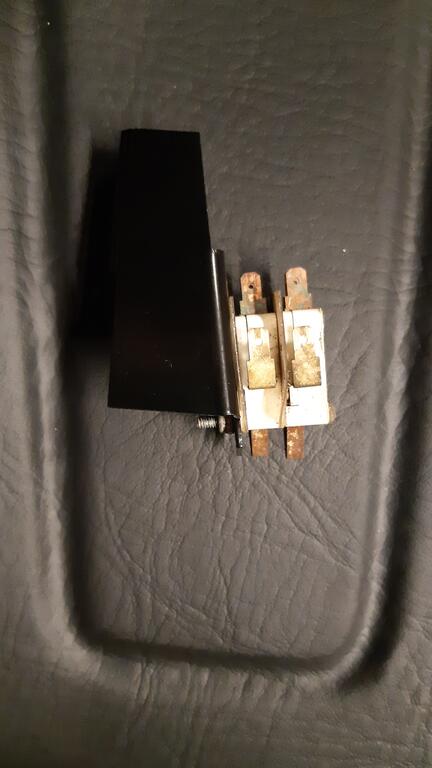

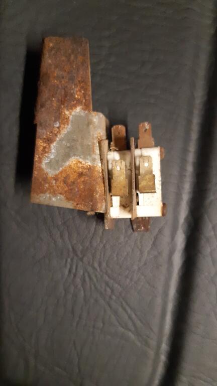

Damien Walker 297 #5 Posted March 19, 2021 Hello, I have just completed the restoration of my 518H which included sprucing up the Onan shrouds. I didn't have powder coat capability when I painted the various parts (though I now do) and so used 2 pack isocyanate based paint. In my experience, this gives the most durable finish that has good ageing resistance, but you do need breathing aparatus, particularly if you are spraying indoors. I always use 2 pack primer too. I now tend to powder coat most things though because the finish is REALLY tough. The additional benefit of powder coating is the speed...a few nights ago, I powder coated the pto and motion lever interlock switch mounting brackets. Both were slightly rusty and the paint flaking. 5 mins to blast the paint off (I think shot blasting is essential for powder coat) 2 mins to coat and 10 mins in the oven and voila: new parts that can be screwed straight on to the tractor (when they have cooled down!). My set up is not big enough for the main panels, so I had them done professionally and I suspect they applied a primer coat first, though I never do with my equipment. So in summary, both the tractor and the engine are painted in a mix of 2 pack and powder coat and perhaps of particular interest; the exhaust heat shield is powder coated. So far I have run the tractor twice to mow the lawn (takes approx 40mins) and I'm not seeing any deterioration anywhere, not even the heatshield. Only time will tell. 1 Share this post Link to post Share on other sites

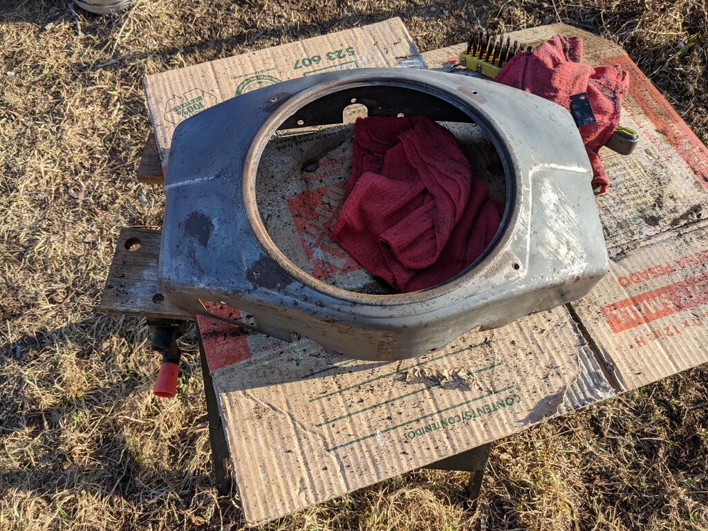

seuadr 490 #8 Posted March 19, 2021 Well, first part of the shroud, first round of stripping: Going to need to get a flapper wheel or something to remove the really tough rust, then I'll smooth everything. Thinking about getting an air tool from harbor freight for the task. 1 Share this post Link to post Share on other sites
Damien Walker 297 #9 Posted March 19, 2021 50 minutes ago, seuadr said: Well, first part of the shroud, first round of stripping: Going to need to get a flapper wheel or something to remove the really tough rust, then I'll smooth everything. Thinking about getting an air tool from harbor freight for the task. More power is always the answer! Flap wheels are good because they cause little damage...and, sorry to harp on about it, but shot/sand blasting is the bizz for this. Which brings me to another point. If you have rust pock marks, they get much worse with shot blasting and are easy to fill using bondo or similar...but not so good if you powder coat. Bondo doesn't like the heat! I believe powder coat compatible fillers are available but I didn't bother. My panels are mostly fine with only some marks on the removable centre console panels and the rear Fender. It wouldn't pass muster in a concours competition but it'll do fine for me. Anyway, it looks as though you are well on the way..I look forward to seeing more photos! I'll try and get some of mine for comparison. Share this post Link to post Share on other sites
seuadr 490 #10 Posted March 19, 2021 Yeah there is some pock marking, i was hoping it was not going to that bad, but there are a couple fairly bad spots. Guess I'll learn to use bondo - doesn't look att the different than mudding drywall really. Share this post Link to post Share on other sites
Damien Walker 297 #11 Posted March 19, 2021 Very similar to plastering in fact....many thin coats better than one thick...it's all about how much sanding you have to do to smooth out the lumps and bumps. The answer is to not put them there in the first place...Nice thin skims please! Over here we also have cellulose body putty (watch it, it dries lightning fast), but that is good for filling in any scratches and air bubbles in the bondo...I presume you'll have something similar? You can also get spray filler which is just like thick primer. That's very good for finish quality because it goes on smooth by the fact that you spray it (unless it runs). From what I can see in your picture, the rust doesn't look too bad. If the blemishes are hidden underneath the plastic grill or the fuel pump for example, there's little point in spending much time on them as only you will know they exist! Share this post Link to post Share on other sites

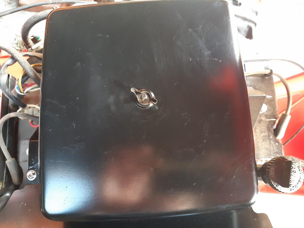

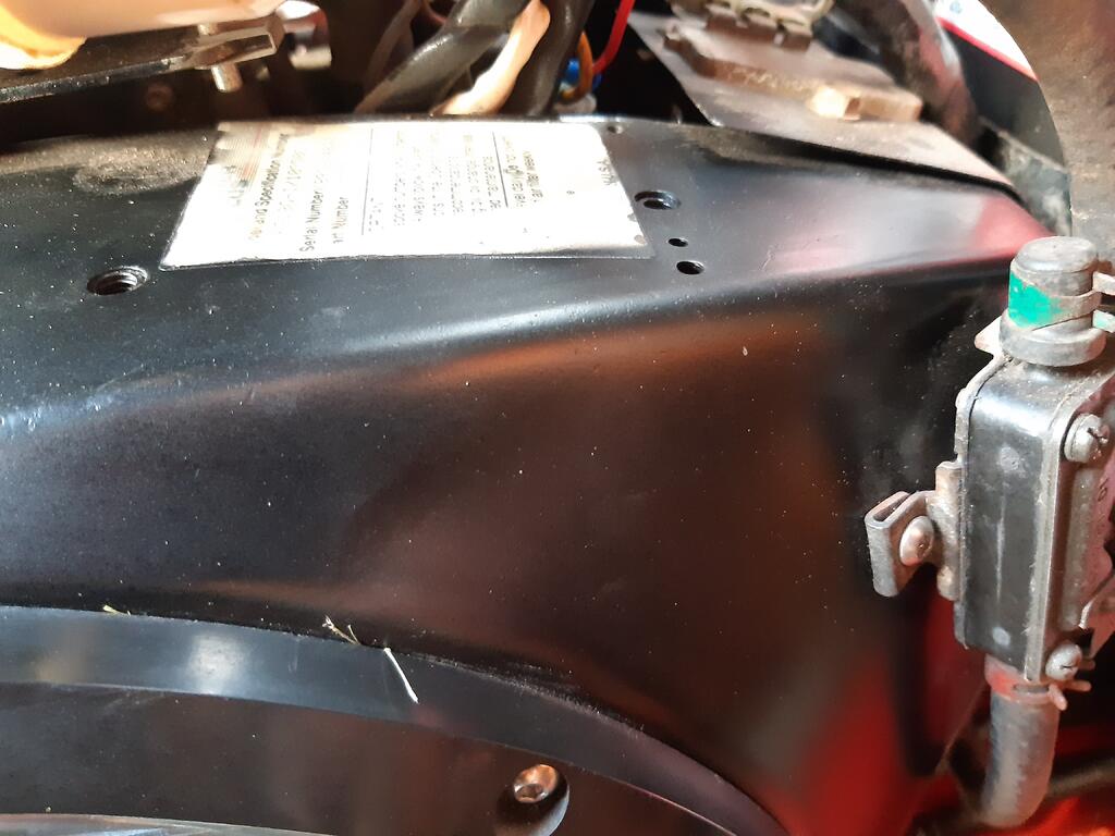

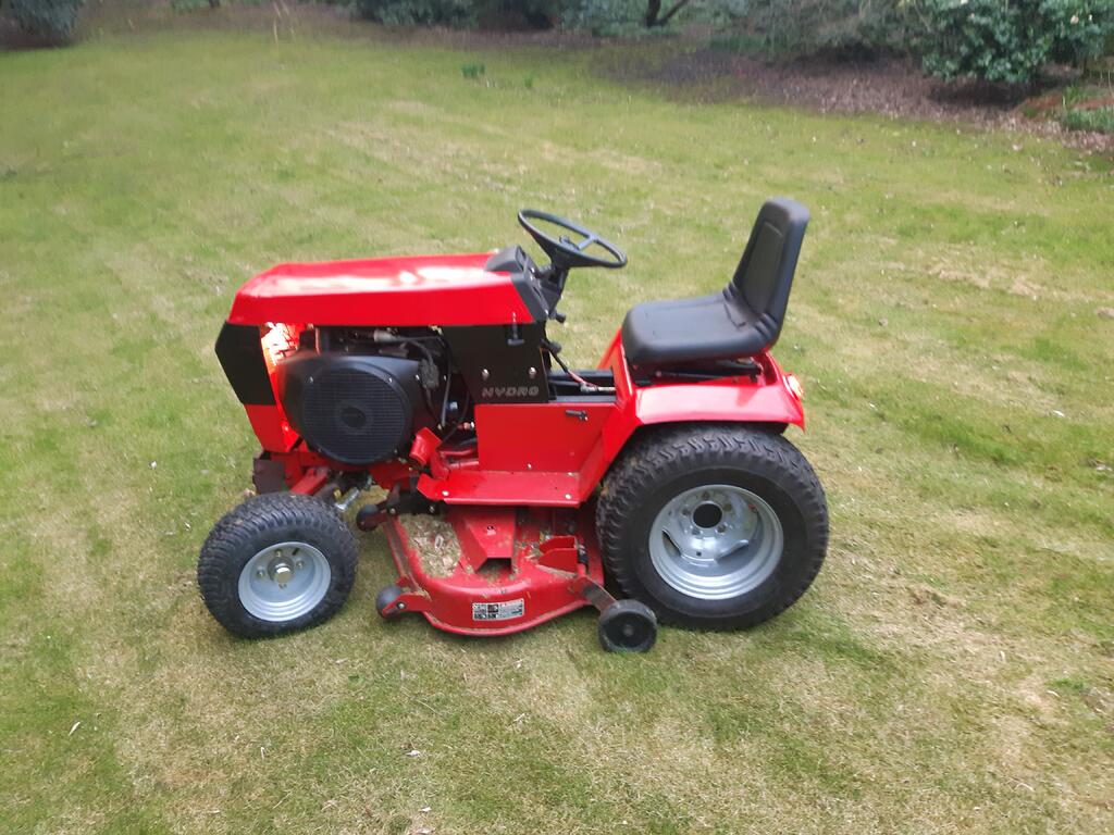

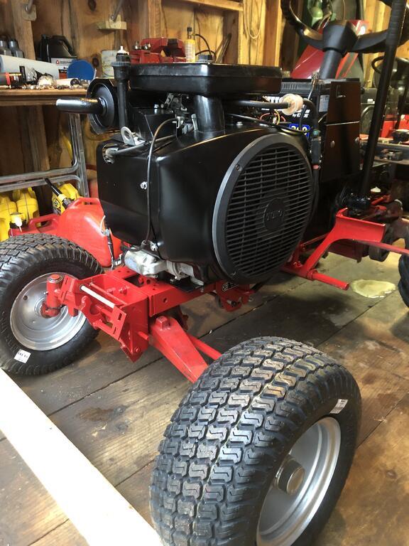

Damien Walker 297 #15 Posted March 26, 2021 I promised some photos of my paint finish....unfortunately the effect is ruined slightly by me running the tractor round the lawn twice (very dusty) but hopefully this will show what I have achieved. The fan cowl is 2 pack isocyanate paint (primed first) and the air filter is powder coat. I did take a photo of the exhaust heat shield too, but it is blurred so not worth posting here. As mentioned, despite having run the engine a couple of times to good running temperature, there is no sign of discolouration (yet). I didn't worry about small rust worm blemishes and I'm very happy with the result. 1 Share this post Link to post Share on other sites
