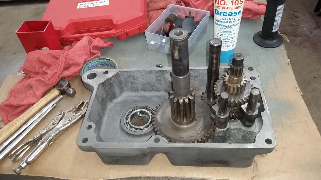

WHX?? 57,650 #16 Posted March 17, 2021 (edited) I'll fess up here EB I did set the bearings in this project with the hammer in method. Only cause I knew they would set fairly easy and I would not have to use 'Fishes BFH. I go by gut feeling with a bit of stupidity thrown in. I'd be the first one to admit I'm too lazy or stupid to take it to the press. This kinda build I'm more worried about the internals than the bearings ...... Edited March 17, 2021 by WHX24 1 Share this post Link to post Share on other sites

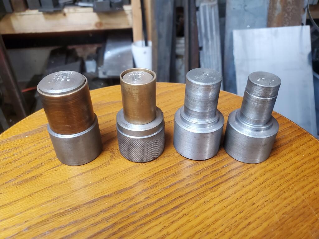

Shynon 7,642 #17 Posted March 17, 2021 (edited) I made these a few years ago, bushing, bearing and seal drivers. They will set the bearing in correct depth, then use the same one to press the seal in. Edited March 17, 2021 by Shynon 3 3 Share this post Link to post Share on other sites
