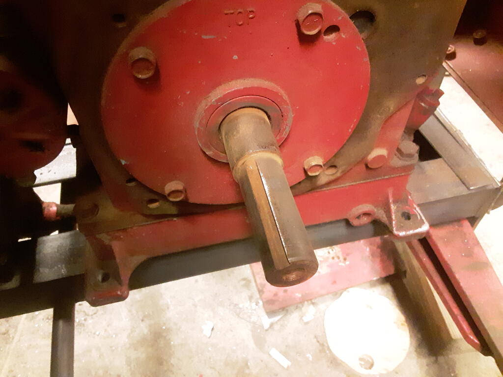

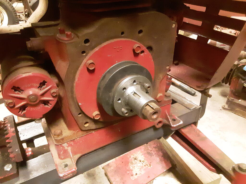

Always working with as much on hand as possible i had to make a shaft adapter for the pulley. The engine I chose had a stepped shaft.

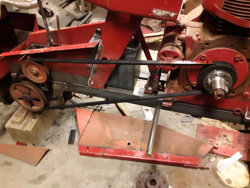

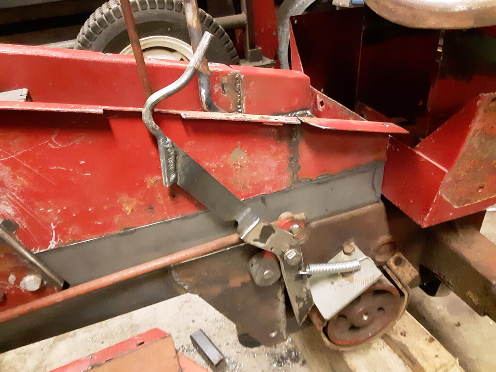

The belt is on. I hope it correct. Also working on a parking brake. I think I'm making headway.
  • Confused 1
The belt looks great!  Is it fabric/Kevlar coated?  The parking brakes looks functional, but the spring doesn’t seem “right” for some reason.  Maybe it’s needed because of the excess weight of the rod on top?
Edited by pullstart
Oldskool
The spring it set to auto engage the parking brake. I can clutch  before it auto sets. After looking at it I probably should have it auto release instead. Maybe that's why the spring looks wrong?
Oldskool
There should be a tension spring on it somewhere. The only thing holding it tight is the brake spring at the moment
That's what you want right there
there should be a spring from the rib on the top of the left axle housing to the brake/clutch rod.  That’ll give you belt tension.
