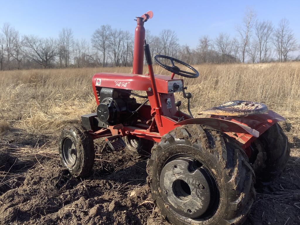

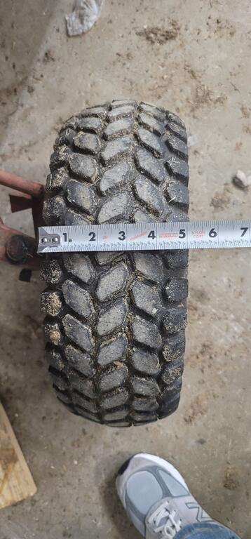

haydendavid380 759 #1 Posted March 15, 2021 (edited) I'm looking to get a nice set of ag rears (probably tru-powers) and a set of ribbed fronts. I've dug into the topic previously, but I wanted to get some clarity before I actually click the order button. Firstly, I know most of the pre-80s tractors had off white 12" rear wheels. Were they all the same size/offset/ect? I've picked up a second set so I can keep a pair of turfs to run with chains. The B80 currently has 22" tires on it. When I go to ags I'm looking for something with a tall and skinny look. How tall can I go before I start running into issues? I'm thinking the 23x8.5-12, or can I go taller? As far as the fronts, they are labeled 6.50" wide but they seem much more narrow Can I get away with the Deestone 4.8-8 tri rib or do I need to go with the Firestone 5 rib in 16x6.5-8? Lastly, I now have 4 rears and 2 front tires that are 40-50 years old. After I take them off to replace them are they something the that the resto guys would want or am I okay to throw them away? Edited March 15, 2021 by haydendavid380 1 Share this post Link to post Share on other sites
Lee1977 7,638 #2 Posted March 15, 2021 (edited) I'm guessing you have 4" wide x 8" wheels the Deestones in 400 x 8 will work great on those wheels. I have mine on 3" wide x 8" wheels. My guess is that the biggest tires you can put on the rear is 23 x 10.50 x 12 with out making modifications, The 400 x 8 Deestone tryribs are $37.00 for two at Greater Cleveland Tire. Mine were $54.00 with shipping. The Deestone rear tires are shorter in height then other brands in the same size. Edited March 15, 2021 by Lee1977 1 Share this post Link to post Share on other sites
Pullstart 70,035 #3 Posted March 15, 2021 Putt Putt has 4-8.0 and 23x10.5-12 Deestones for reference. Late 70’s rear wheels... 6 or 7 inches wide. Share this post Link to post Share on other sites

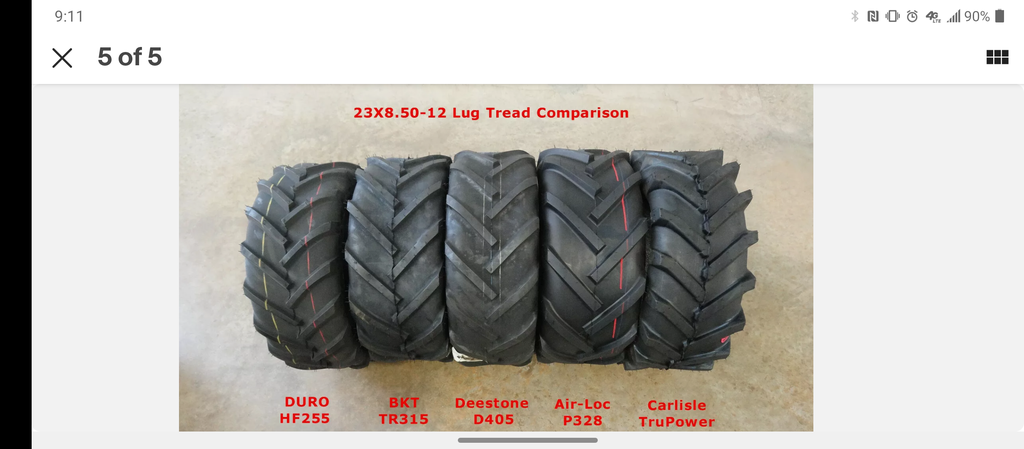

JoeM 9,989 #7 Posted March 15, 2021 (edited) This is one of the tire comparison pics out of @WV Hillbilly thread Nice compare. I think goodyear might be the tallest not shown in the pic but not much more then carlisle And if you got deep pockets goodyear makes a nice looking hybrid ag tire. R14T Edited March 15, 2021 by JoeM 1 Share this post Link to post Share on other sites
WVHillbilly520H 10,378 #8 Posted March 15, 2021 9 minutes ago, JoeM said: This is one of the tire comparison pics out of @WV Hillbilly thread Nice compare. I think goodyear might be the tallest not shown in the pic but not much more then carlisle And if you got deep pockets goodyear makes a nice looking hybrid ag tire. R14T I haven't seen any new GOOD YEAR L&G tires (Terra Grip turf or AG) forsale, I know they were O.E. on Cub Cadet, one of the better gripping turf tires IMO, you have a source or other moniker besides "Terra Grip"? ... Like I mentioned in my thread the OTR is very close to stated size. 1 Share this post Link to post Share on other sites
JoeM 9,989 #9 Posted March 16, 2021 I’ve seen the hybrid R14T (8,50’s) on the bay 2 for 285 and a couple other places Share this post Link to post Share on other sites
WVHillbilly520H 10,378 #10 Posted March 16, 2021 30 minutes ago, JoeM said: I’ve seen the hybrid R14T (8,50’s) on the bay 2 for 285 and a couple other places No, not those the old style R1 "Terra Grip" or turfs from GY is what I was asking about. Have you seen these... https://www.walmart.com/ip/BKT-TR-315-23X10-50-12-C-6PR/618408452 2 Share this post Link to post Share on other sites

JoeM 9,989 #12 Posted March 16, 2021 @haydendavid380 With only 8 hp on that rig any taller size up or added weight will eat horse power. i cut a lot of steep hills and can be into the governor with a 20hp. and weighted tires. Both filled and steel weight. If you are running flat ground no issue. Get the meat! If your into ag's those BKT tires in 8.50, the billy showed, would be my pick. Nice square edge on the side wall bars. Reasonable price not to overwhelming on size. BKT TR-315 23X8.50-12 62$american not to bad! 1 1 Share this post Link to post Share on other sites
