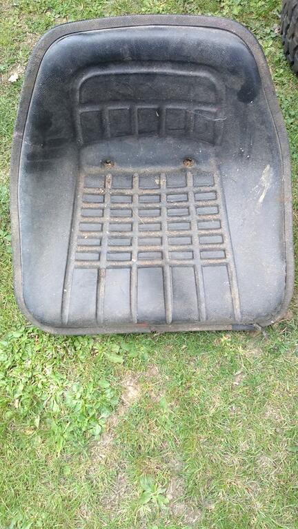

Dan.gerous 2,696 #1 Posted March 15, 2021 Thanks to @Keith of kent for some extra parts to add to my growing collection of Wheelhorse bits and bobs in the garage. Its like Christmas! 2 4 Share this post Link to post Share on other sites
