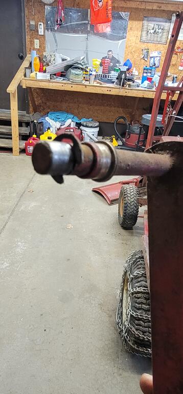

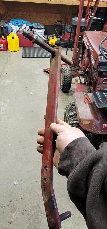

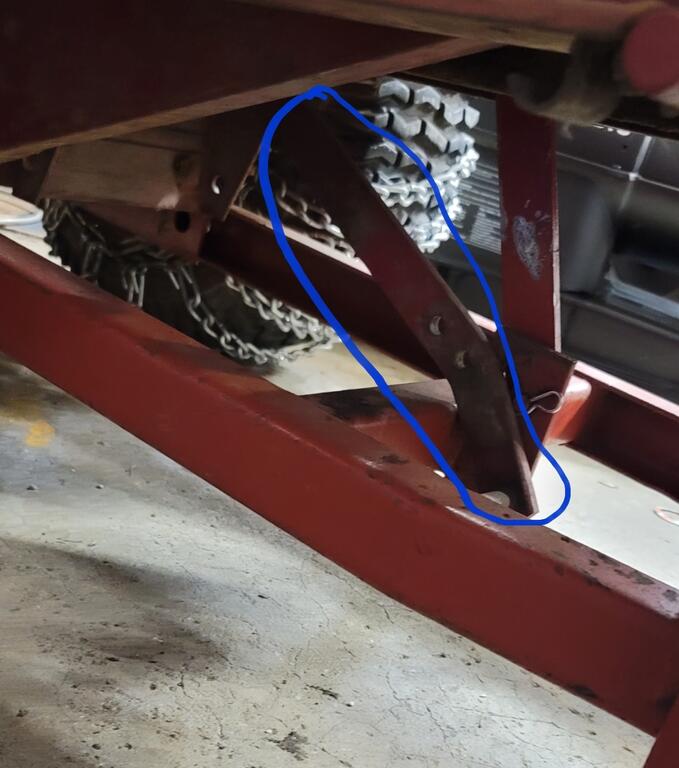

haydendavid380 759 #1 Posted March 14, 2021 I don't know if I'm just an idiot or what, but I wish someone had told me this earlier. I see plenty of pictures of the bar for the mower deck hanging down, so I know I'm not the only who who has struggled with this. Heck, I've even seen pictures where previous owners have cut them off. This is what I'm talking about I struggled with it knocking pins out, rattling, catching on the ground, ect, for as long as I've been messing with these. It's a simple 30 second process to remove it. Just pull out a c clip and it slides right out. Just crawl under there and pop it out and poof! No more bar hanging down! 1 Share this post Link to post Share on other sites

squonk 47,888 #6 Posted March 14, 2021 If you catch that bar on the ground in reverse, it will stop you dead with the back wheels off the ground. Happen D to me in the middle of snowblowing. I tie it off or remove it. Share this post Link to post Share on other sites
seuadr 490 #7 Posted March 14, 2021 huh. mine has a chain attached to it that is loose enough that it has full range of motion, but it won't go down far enough to hit the ground - it is bolted in place i figured it was factory! Share this post Link to post Share on other sites
squonk 47,888 #8 Posted March 14, 2021 49 minutes ago, seuadr said: huh. mine has a chain attached to it that is loose enough that it has full range of motion, but it won't go down far enough to hit the ground - it is bolted in place i figured it was factory! When that chain becomes detached, that's when it happens. Saw it happen to a kid that was hot rodding at the Big Show too. Vibration loosened the bolt on mine. I use lock nuts now. Share this post Link to post Share on other sites
seuadr 490 #9 Posted March 15, 2021 2 hours ago, squonk said: When that chain becomes detached, that's when it happens. Saw it happen to a kid that was hot rodding at the Big Show too. Vibration loosened the bolt on mine. I use lock nuts now. Yeah i use my horse almost exclusively for snow removal and now I'm thinking i need to check it too! Share this post Link to post Share on other sites
ronhatch 410 #10 Posted March 17, 2021 Removed the bar from both my C101 with a 42" mower deck and also from my 876 with a snow blade. Don't need it. It's somewhere up in the attic of my shed taking up space. Maybe I can repurpose it some day. Share this post Link to post Share on other sites
