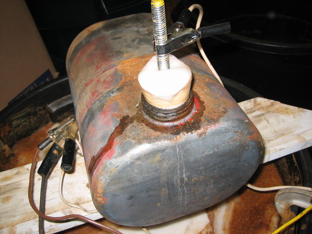

The Tuul Crib 7,354 #14 Posted March 14, 2021 What l did was electrolisis. Take a piece o wood and drill a 3/8 hole. Then put a 3 or 4 inch bolt and put it inthe hole. Fill the tank with water and washing soda and set the wood with the bolt into the tank. Dont let the bolt touch the tank opening! Connect the positive to the bolt and the negative to the tank and turn on the battery charger. Worked well for me. 1 Share this post Link to post Share on other sites

formariz 12,381 #17 Posted March 14, 2021 29 minutes ago, The Tuul Crib said: What l did was electrolisis. Take a piece o wood and drill a 3/8 hole. Then put a 3 or 4 inch bolt and put it inthe hole. Fill the tank with water and washing soda and set the wood with the bolt into the tank. Dont let the bolt touch the tank opening! Connect the positive to the bolt and the negative to the tank and turn on the battery charger. Worked well for me. That is also the method I use. No noise no mess just set it and forget it. Great results every single time. Share this post Link to post Share on other sites

Wheel Horse 3D 3,827 #19 Posted March 17, 2021 (edited) On 3/14/2021 at 1:29 PM, formariz said: That is also the method I use. No noise no mess just set it and forget it. Great results every single time. Just a word of caution!....passing current through water and seperating its constituents by electrolosis results in HHO insted of H2O. Hydrogen AND oxygen in just the perfect ratio to combust! Use a well vented area please! Edited March 17, 2021 by Wheel Horse 3D 1 Share this post Link to post Share on other sites

seuadr 490 #21 Posted March 17, 2021 33 minutes ago, Wheel Horse 3D said: Don't ask me how I know that...and nifty fact when it does combust...the main by product is H2O. ok, so we can't ask how you know - but - do you have any video? wanted to add, you can't use a float charger for this - they will not "detect" a battery and not work. you can either modify a float charger, find a manual charger (these seem to be getting rare) or i've heard about some people just using a battery in line to get around it (seems like it'd be easy to try!) 2 Share this post Link to post Share on other sites
Wheel Horse 3D 3,827 #22 Posted March 17, 2021 7 minutes ago, seuadr said: ok, so we can't ask how you know - but - do you have any video? wanted to add, you can't use a float charger for this - they will not "detect" a battery and not work. you can either modify a float charger, find a manual charger (these seem to be getting rare) or i've heard about some people just using a battery in line to get around it (seems like it'd be easy to try!) No video... but lets just say it was purposeful and involved a 30A 12v power supply and a bunch of really closely spaced positive and negative electrodes! 1 1 Share this post Link to post Share on other sites
8ntruck 9,368 #23 Posted June 7, 2022 If you do opt for electrolysis, don't use any stainless steel for the electrode. That process pulls chrome out of the stainless and then your water/washing soda mixture becomes a very nasty, federal regulated, super fund type of toxic waste. Share this post Link to post Share on other sites
