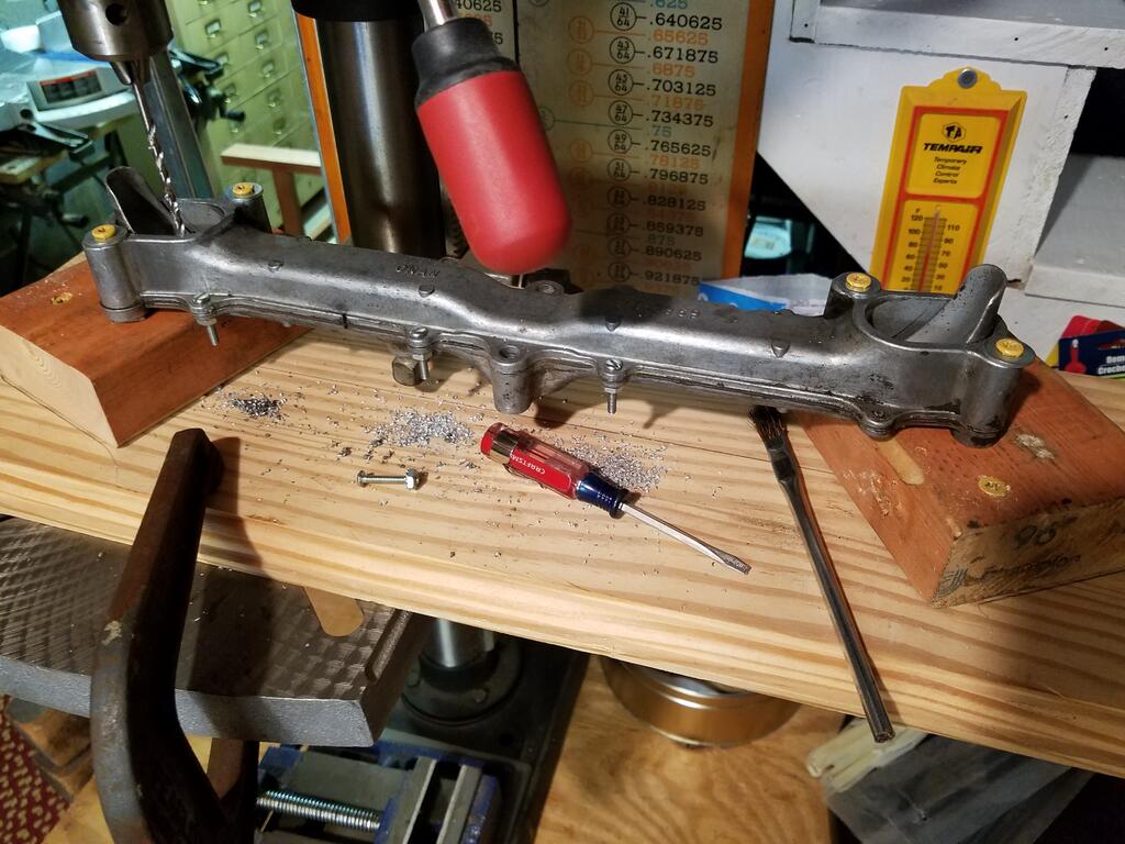

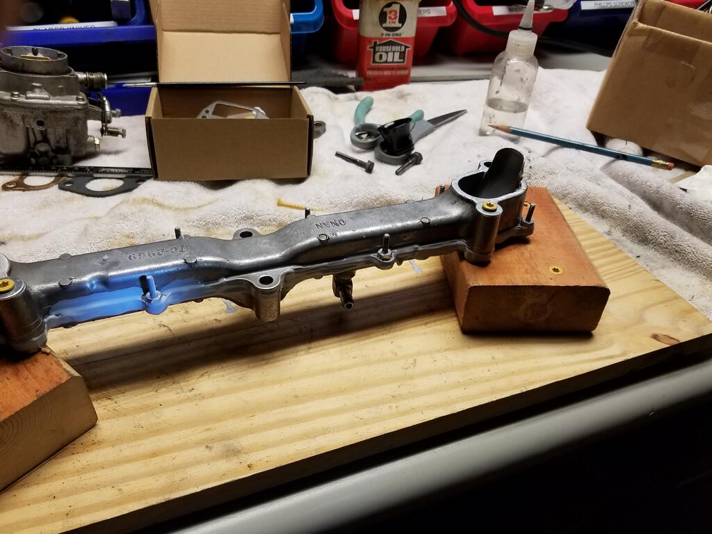

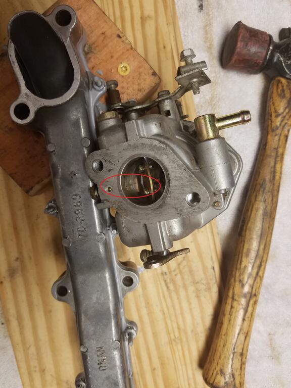

acc7484 52 #1 Posted March 13, 2021 Hello All, I removed the Intake to to reseal it. Problem is how do I get it apart? I drilled out the rivets . It wont separate. Is there a trick Im missing? Share this post Link to post Share on other sites
lynnmor 8,915 #2 Posted March 13, 2021 If you drilled all the rivets it should pry apart easily. In the photo with the screws installed it looks like there is a rivet that still needs drilled. 1 Share this post Link to post Share on other sites
acc7484 52 #3 Posted March 13, 2021 I installed screws and nuts as I drilled to keep things in alignment. That photo was during the process. Im afraid I might break it. Its really stuck together. Share this post Link to post Share on other sites

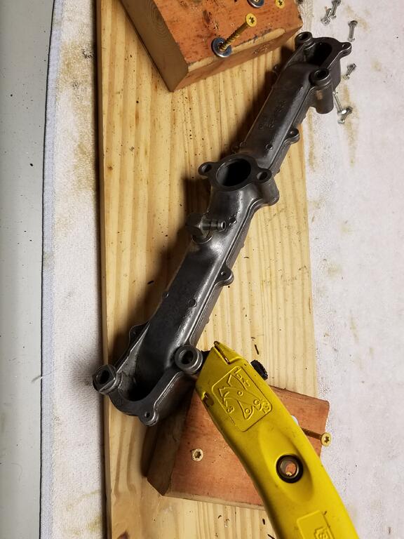

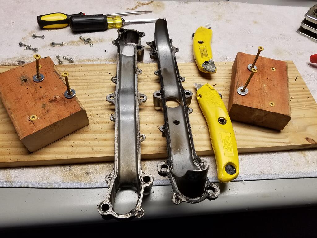

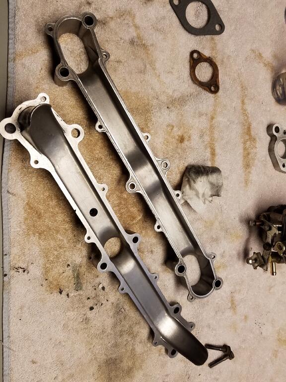

acc7484 52 #4 Posted March 14, 2021 OK folks I got it! I used two utility knives to carefully pry it open. I dont think I had a problem with this leaking vacuum. I will clean it up and reseal it. Share this post Link to post Share on other sites

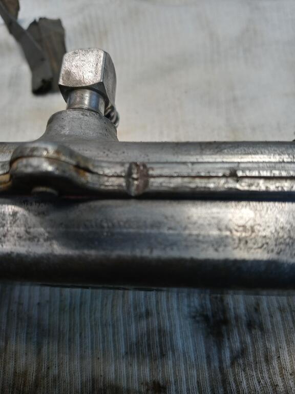

Horse Newbie 7,405 #8 Posted March 14, 2021 (edited) @acc7484 In the 2nd pic in frame 1 above, there appears to be a black line across the seam... Looks like where the exhaust heat shield is rubbing. When you get the intake manifold back on, hold the front exhaust manifold heat shield in place and you will see where the heat shield tends to rub a hole in the intake manifold across the seam. This is a common occurrence on the 520H's. Take a pair of tin snips and trim a little metal off the edge of the exhaust manifold if needed. I will post a pic of where mine was rubbing if I can find the pic. I hope you resealed with gasoline resistant sealer. I opted to just reseal mine without drilling out the rivets and separating the 2 halves...although there are some on here that would say separate and seal... Edited March 14, 2021 by Horse Newbie 1 Share this post Link to post Share on other sites

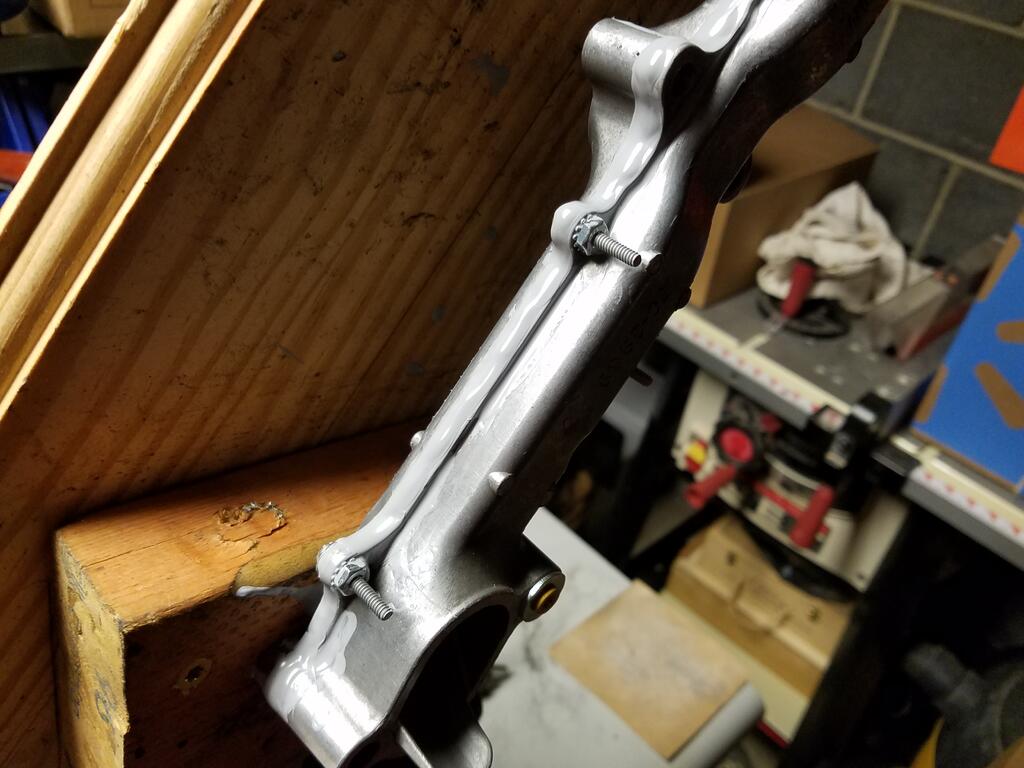

lynnmor 8,915 #13 Posted March 17, 2021 I use MotoSeal 1. When you tighten the screws thru the two halves, you should put screws thru the carburetor mounting holes and tighten them just slightly so that there is the correct amount of sealant there. 1 Share this post Link to post Share on other sites

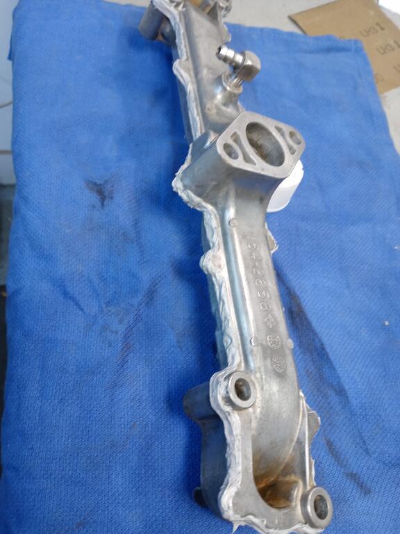

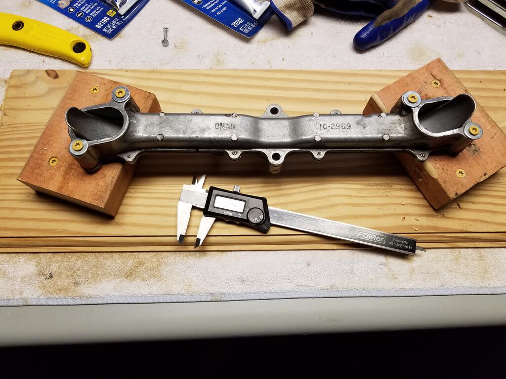

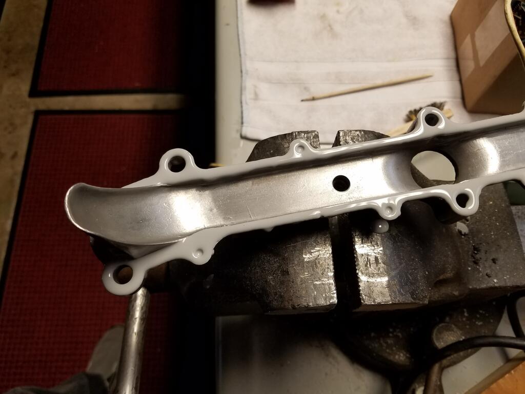

acc7484 52 #15 Posted March 17, 2021 Prepping the Intake: Thoroughly clean the two halves. I used a sharp putty knife, Brass brush and Isopropyl Alcohol to degrease the parts. in addition i filed the mating surfaces to fit perfectly. Apply a thin coating of Motoseal (29132) Gasket Maker Its very messy. I used a small brush to apply it. I made a holding fixture to hold the manifold halves in position. I installed the nuts and screws. After some drying time I coated the edge with another layer of Motoseal. 1 Share this post Link to post Share on other sites

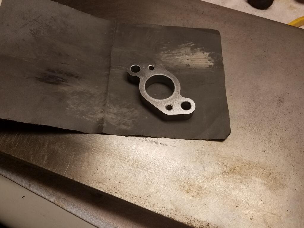

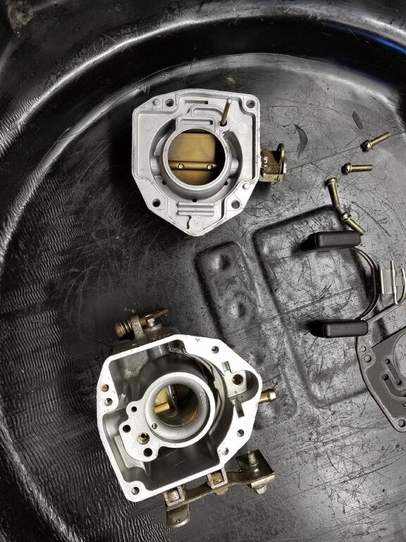

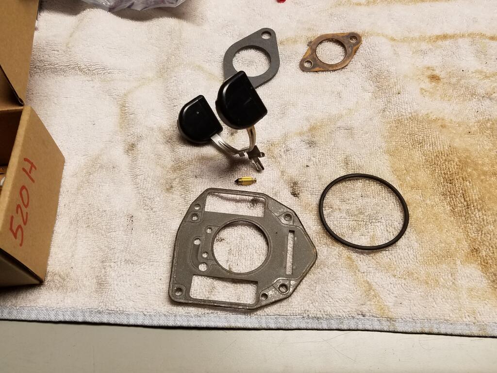

acc7484 52 #16 Posted March 17, 2021 Nikki 146-0414 Carburetor The PO gave me a rebuild kit made by Autokay. I only used a few parts the base gasket needle valve, O-ring and air horn gasket, the rest was trash including the float. Made of a cheep plastic with two halves glued together. The most important thing is to make sure these small holes in the base are clean use a "hang tag" wire to make sure they are clear. Set the float on this unit its .050" from the top edge or the thickness of the gasket. I have a surface plate so I use this to refinish all the mating surfaces. 4 Share this post Link to post Share on other sites
