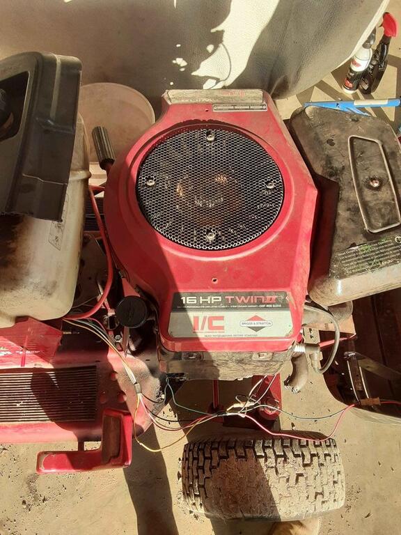

Raider69 124 #1 Posted March 13, 2021 (edited) OK, any vertical shaft transaxle experts out there? I have a 1970 Commando V-8 which originally had the 5066 3 speed transaxle but it has been replaced with the 5075 3 speed transaxle pulled form a '71 or '72 CG-7. In the Commando V-8 owner's manual it says the 5066 had limited slip. However before mine fell victim to my 15 year old many years ago it never showed any signs of having limited slip, probably worn out. I can't find a CG-7 manual to check but the transaxle I pulled from the CG-7 most definitely has limited slip as well. The Commando V-8 has been idle for about 3 years while I searched for a suitable replacement engine. Last night I snagged Briggs 16HP oppose twin to put in it, I had a Briggs 14.5 HP single setting in it but I figured if I was going to have to modify the hood I might as well make it worth the effort so I upped the ante with the twin. I'm wondering if it would be better to rebuild the original 5066 (provided I can find parts) or just keep the 5075? The plan for the tractor after the repower is to mount a V-plow on it for opening up sidewalks and breaking a hole through the pile of crust at the end of the driveway from the state plows so I can then chip away at it with my Raider 9 and 42" dozer blade. On more than one occasion I wasn't able to get the end of the driveway and "upstream" shoulder cleared before the state plows came and they plowed me in so bad I couldn't break through with a dozer blade or snow thrower. I'm thinking the V-plow would at least break an opening though I could then open up with the dozer blade or thrower. In nice weather I'd use it as a backup mower in case my other would break down. This is after several hours of trying to get through with my B-100 with the dozer blade AND digging by hand, I finally had to get a full size tractor with a loader to dig it out. It's all hard packed snow from the state plows. To give you some idea how deep that pile is I'm 6' 1-1/2" and my driveway drops off quite a bit about 6 feet in front of the car so I'm standing on 12-18" of snow in the picture. Maybe my "drift buster" wouldn't be able to get through something like that either but I'll sure have more fun trying than I did that day LOL. Edited March 13, 2021 by Raider69 2 Share this post Link to post Share on other sites
