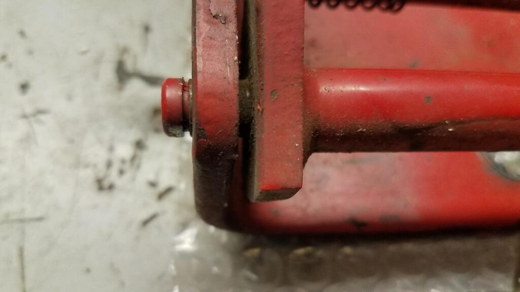

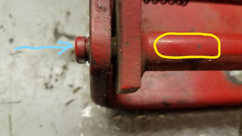

kthomas62 46 #10 Posted March 15, 2021 (edited) Guys, I apparently failed to explain with clarity. What I am talking about, is the lower attachment locking bar in photo 3, that I am holding onto. The top piece does come out if all the clips are removed but the lower locking bar don't come out. As you can see, the new hitch comes with no other hardware and has to be moved over from the old hitch. The lower locking bar seems to be impossible to remove without bending the sides of the hitch and that would a difficult task! Thanks, Kevin Edited March 15, 2021 by kthomas62 Share this post Link to post Share on other sites

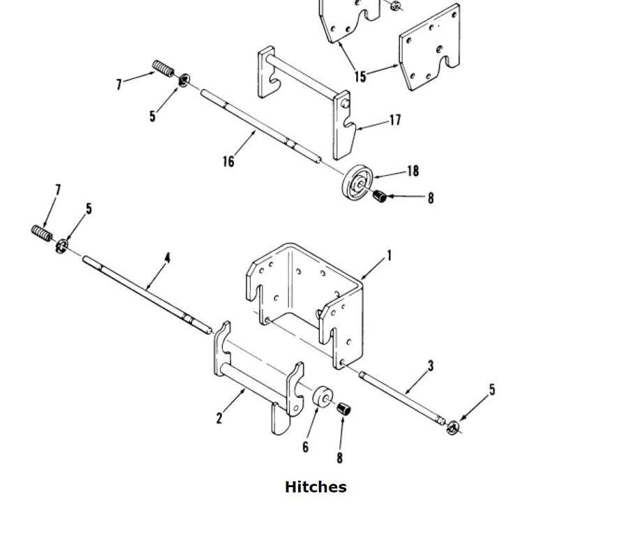

pfrederi 20,870 #11 Posted March 16, 2021 The blue arrow is really a pin (#3 in parts diagram) that goes all the way through the yellow tube (#2 parts diagram). Just drive it out. 3 1 Share this post Link to post Share on other sites
clueless 3,427 #12 Posted March 16, 2021 1 hour ago, pfrederi said: The blue arrow is really a pin (#3 in parts diagram) that goes all the way through the yellow tube (#2 parts diagram). Just drive it out. The three pin on the hitch can be driven out once you remove all the E clips. Share this post Link to post Share on other sites
kthomas62 46 #13 Posted March 19, 2021 On 3/16/2021 at 9:52 AM, clueless said: The three pin on the hitch can be driven out once you remove all the E clips. Thank you very much, that is exactly what I needed. I was wondering if it drove out but wasn't sure! Kevin 1 1 Share this post Link to post Share on other sites
