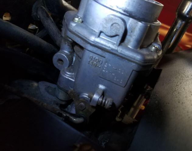

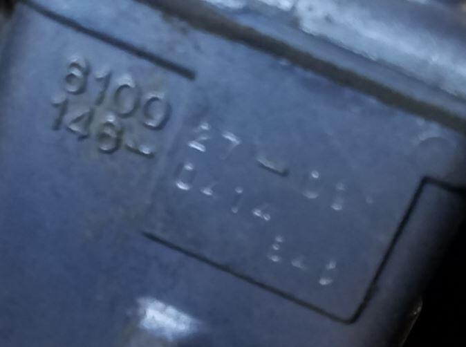

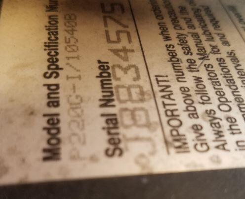

acc7484 52 #1 Posted March 12, 2021 Wheel Horse 1988 520-H model 31-20OE01 with Onan P220G-I. Hello All, I am looking for a proper Carb rebuild kit for my Wheel Horse 520H. What type of carb is this? Is 146-6100 the correct number? Thank you for your input. Share this post Link to post Share on other sites

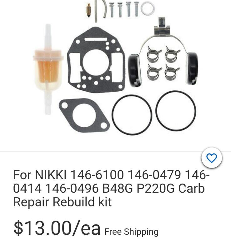

haydendavid380 759 #2 Posted March 12, 2021 (edited) If you search the auction site for a Nikki 6100 kit for a P220G you should find rebuild kits for around $30. Onanparts dotcom has genuine Onan 146-0657 kits for $49 Edited March 12, 2021 by haydendavid380 Share this post Link to post Share on other sites
haydendavid380 759 #3 Posted March 12, 2021 Heck, they have them down as low at $13 Share this post Link to post Share on other sites
acc7484 52 #4 Posted March 12, 2021 Thats it ? I thought there would be more that that.... Thanks Guys. Share this post Link to post Share on other sites
seuadr 489 #5 Posted March 12, 2021 not for a rebuild - unless something is broken you just clean the jets, replace the float and the needle the button it all back up with new gaskets. if you have the stock diaphragm fuel pump, you may consider not fitting in the filter - i've heard that sometimes the cheap filters can cause too much of a restriction for the stock pump to do it's thing if it isn't tip top. Share this post Link to post Share on other sites

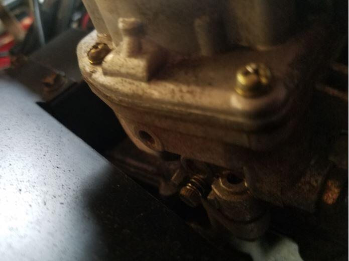

Handy Don 14,654 #6 Posted March 13, 2021 Double check that the little plug is in place above the idle mixture adjustment screw (called a welch plug) pointed to by the red arrow. If that is missing, make sure your rebuild kit includes one. (And read up on how to set one in place!) Share this post Link to post Share on other sites
acc7484 52 #7 Posted March 13, 2021 Don ...... The welch plug appears to be there. The picture above shows it. I will double check. What is behind there? I have an Idle adjustment screw there as well. Share this post Link to post Share on other sites
lynnmor 8,085 #8 Posted March 13, 2021 10 minutes ago, acc7484 said: Don ...... The welch plug appears to be there. The picture above shows it. I will double check. What is behind there? I have an Idle adjustment screw there as well. If you find much dirt, it might pay to pull that welch plug because there are three small passages hiding in there. A 3/8" aluminum welch plug will be needed to close it back up, using a very small amount of sealant on the edge. Screw out the idle mixture screw and blast carb cleaner thru there as well as all other passages. I have found that some of the cheap needles have a razor sharp that causes them to bind to the float, carefully stone off any sharp edge. It is easier to pull the intake to get the carb off, do not reuse the gaskets and replace them with only genuine Onan parts. Now I will give you a few more chores. The two piece intakes can leak between halves, inspect carefully. The heat shields often cut into the sides of the intake, if they are hitting or close, grind a little clearance. While the intake and exhaust are off would be a good time to adjust the valves and paint the exhaust. Use only Onan gaskets there as well. Share this post Link to post Share on other sites
Handy Don 14,654 #9 Posted March 13, 2021 13 minutes ago, lynnmor said: If you find much dirt, it might pay to pull that welch plug because there are three small passages hiding in there. A 3/8" aluminum welch plug will be needed to close it back up, using a very small amount of sealant on the edge. Screw out the idle mixture screw and blast carb cleaner thru there as well as all other passages. What he said, @acc7484 My personal preference when working on engines is to do anything now, while I have things apart, that might have to be done in the next two or so years. @lynnmor gave me these assignments (and more) when I redid my carb (I did clean behind and replace the welch plug) and it fired right up afterward and works just fine now. I don't expect to have to go in there again for as long as I keep the fuel system clean, change the air filter regularly, and use good gas. Share this post Link to post Share on other sites
