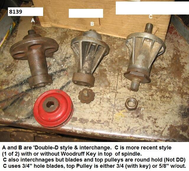

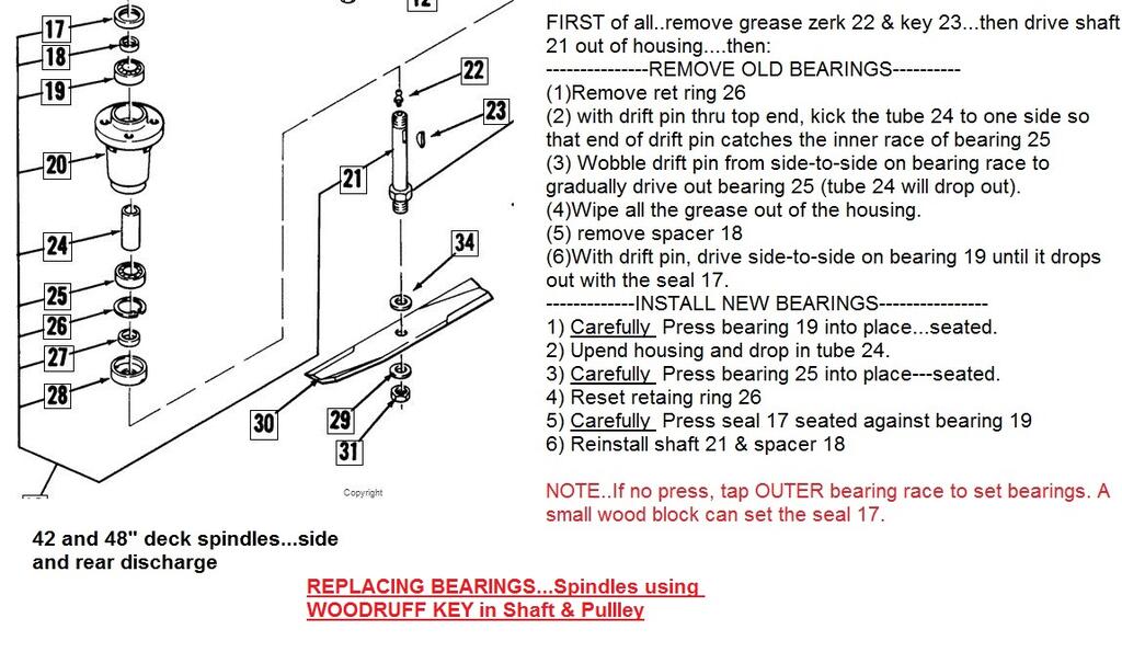

daveoman1966 3,884 #11 Posted March 12, 2021 In 30+ years of working on these, I've never had to use a torch of anykind. I'm not saying to NOT use torch method, I've just never had to. This is my method...as best I can describe it. Of course, this method is about the same for those spindles NOT incorporating a Woodruff key as in this pic. 1 Share this post Link to post Share on other sites
grinchsr 674 #12 Posted March 12, 2021 Thank you gentlemen Two schools of thought which I will consider. Maybe a combination of both. Share this post Link to post Share on other sites
