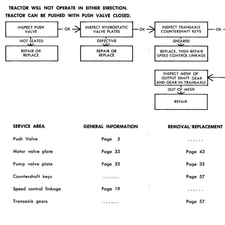

krohs nest 29 #1 Posted March 10, 2021 The GT-14 is free wheeling in both forward and reverse. It dose not matter which position the valve is in. Is the problem with the flow valve or should I be looking at something else. Any suggestions? Thanks Share this post Link to post Share on other sites
pfrederi 21,215 #2 Posted March 10, 2021 (edited) download the sunstrand manual here I would look at tow valve first then transaxle gear Is this a sudden onset issue??? Edited March 10, 2021 by pfrederi 1 Share this post Link to post Share on other sites
953 nut 69,728 #3 Posted March 11, 2021 9 hours ago, krohs nest said: The GT-14 is free wheeling in both forward and reverse. It dose not matter which position the valve is in. Is the problem with the flow valve or should I be looking at something else. Any suggestions? Thanks Jack up one side at a time and see if the wheels and axles are turning freely, could be an axle or hub problem. Even with an open tow valve the GT-14 will roll without resistance. Share this post Link to post Share on other sites
