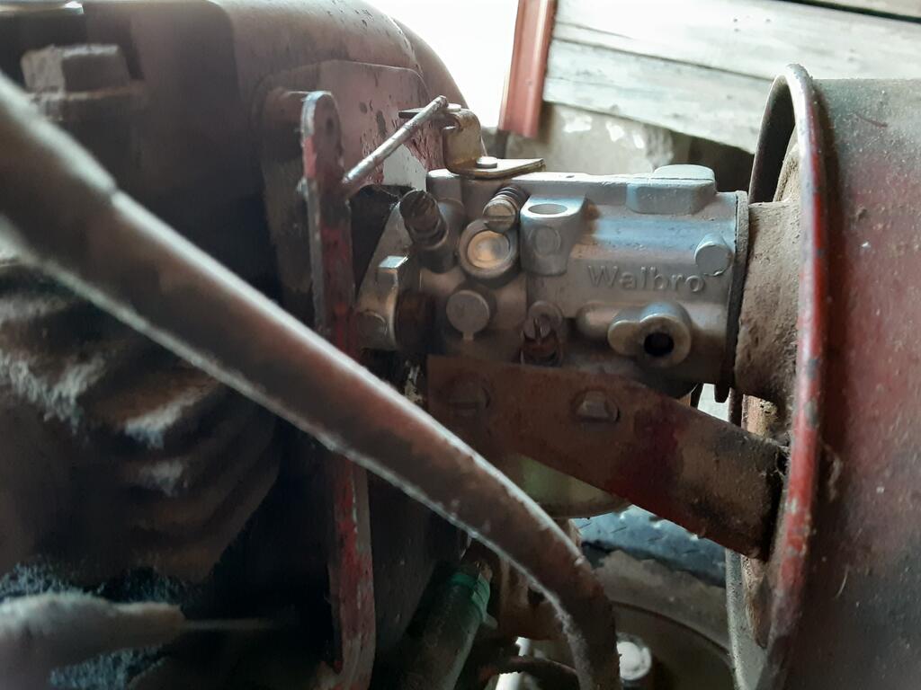

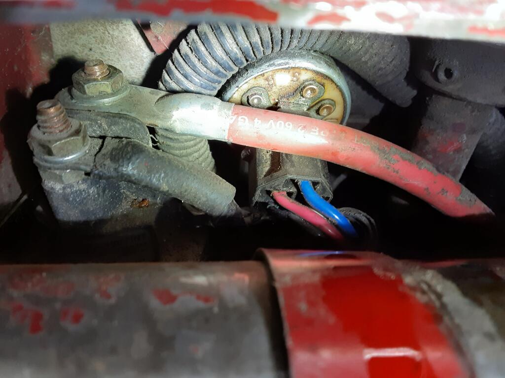

Jason Miller 24 #33 Posted April 10, 2021 So my small engine mechanic loaned me a new battery to try today and I installed it and we have a smooth running engine now!! I’m so happy thanks to all of you. A few things. I have a cleaned carburetor how do I adjust it? There’s 3 screws one being the idle. also one of you mentioned the back of the ignition area. Extremely dirty and corroded. I have a picture the plug is the ignition I’m assuming what is the other connectors? They were very dirty as well. I took off the gas tank and cleaned those as well. jason Share this post Link to post Share on other sites
Jason Miller 24 #34 Posted April 10, 2021 Here’s the carb Share this post Link to post Share on other sites
