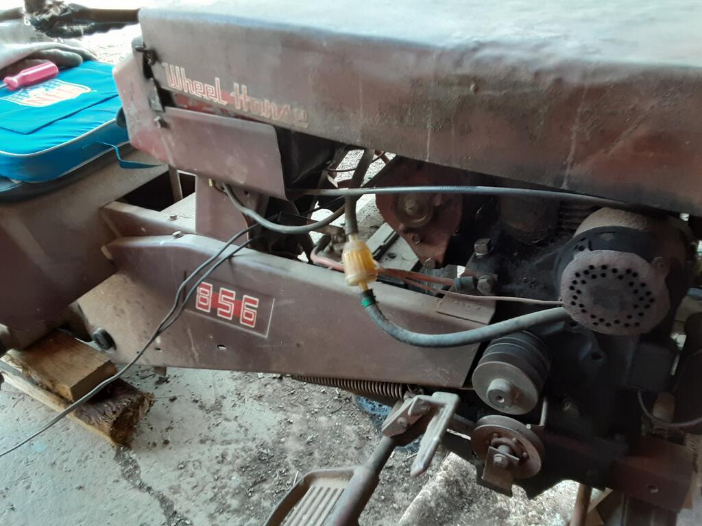

Jason Miller 24 #1 Posted March 10, 2021 My 856 won’t start. Turns over just won’t fire. Always does need a place to start I’ve never had an issue with this machine it was my grandfathers he bought new. jason Share this post Link to post Share on other sites

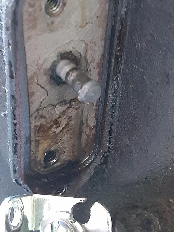

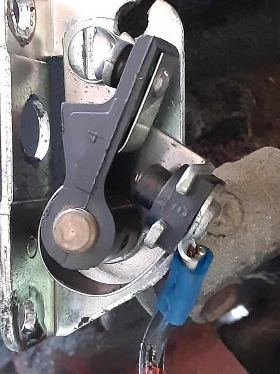

953 nut 70,324 #5 Posted March 10, 2021 Glad to see a third generation showing some love to a family . As others have said it could be fuel or it could be spark that is keeping the engine from running. What type of gas have you been burning? The fuel systems in older equipment are not compatible with ethanol. It is best to run non-ethanol gas, https://www.pure-gas.org/ this site will help you to locate real gas. If you have been running E-10 you probably should drain it, replace the fuel hose and filter and add some Seafoam fuel treatment to the real gas. If you don't have spark the first thing to check would be your ignition points. It takes very little corrosion to keep them from working properly. You can remove the cover from the points and place the edge of a dollar bill between the contacts and run it back and forth a couple times to clean them up. Please let us know what you find. Share this post Link to post Share on other sites

Jason Miller 24 #8 Posted March 10, 2021 Ok Wow! Feel the love already. Ok I replaced the spark plug no spark when cranking. The fuel is good use good fuel always. No I don’t have a meter. I use this thing al the time first time it wouldn’t start. Just replaced rear tires today. The original wheel horse tires were on they dry rotted. Where do I go from here 1 Share this post Link to post Share on other sites
Skipper 1,792 #9 Posted March 10, 2021 (edited) check for current on coil. check starter switch if no current. If current OK on coil, check points and condenser. also check that all wires are good, and tight on all connection points. Fuses check of cause, if there are any. Might also want to check safety switches if there are any on it. If you find above OK, and the plug is surely grounded, and still no spark, it points to a bad coil. Edited March 10, 2021 by Skipper 1 Share this post Link to post Share on other sites
Jason Miller 24 #10 Posted March 10, 2021 (edited) Where is the coil and starter switch and points? Easiest way to check for current? I don’t think there are any saftey switches. Edited March 10, 2021 by Jason Miller Added a line Share this post Link to post Share on other sites

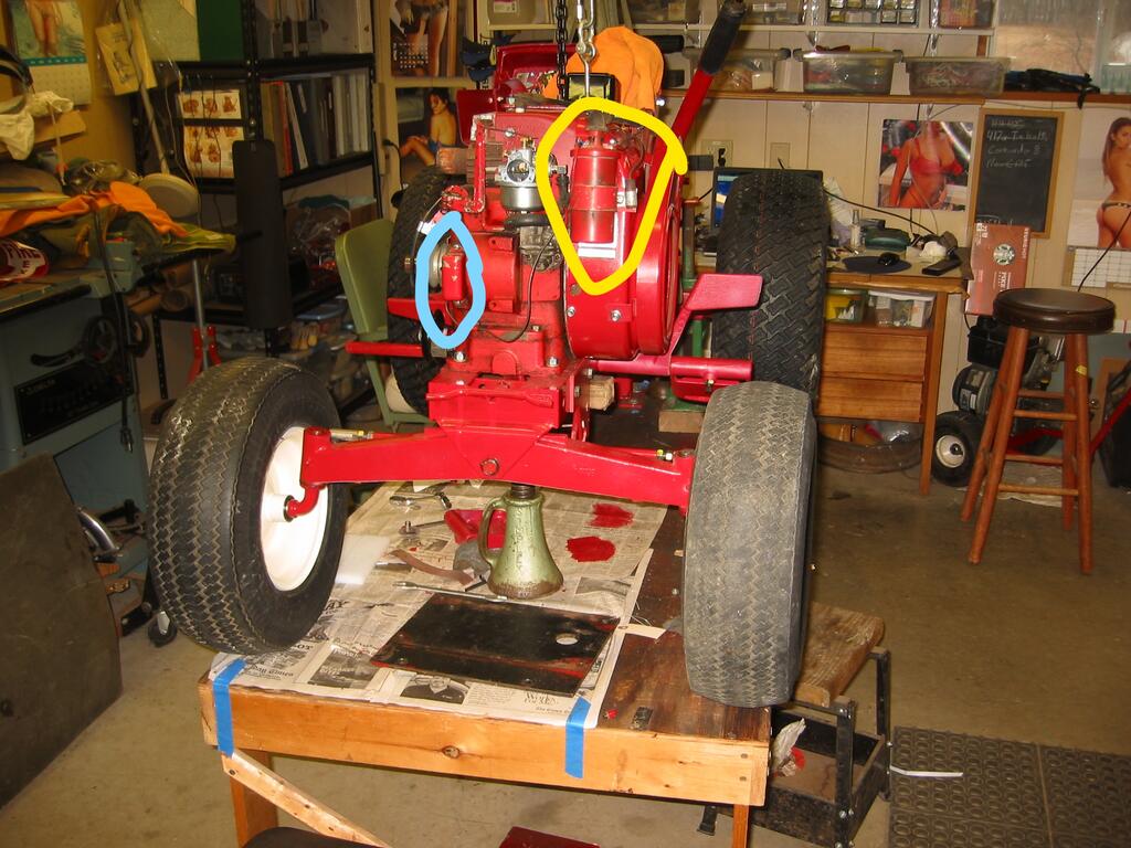

pfrederi 21,301 #11 Posted March 10, 2021 Points blue circle Coil yellow. Look on top of coil two small terminals. One with a +. Ignition switch on see if you have voltage to that small + (You could rig up a light bulb if you do not have a meter. a$5 meter from harbor freight would be a good thing to get 1 Share this post Link to post Share on other sites

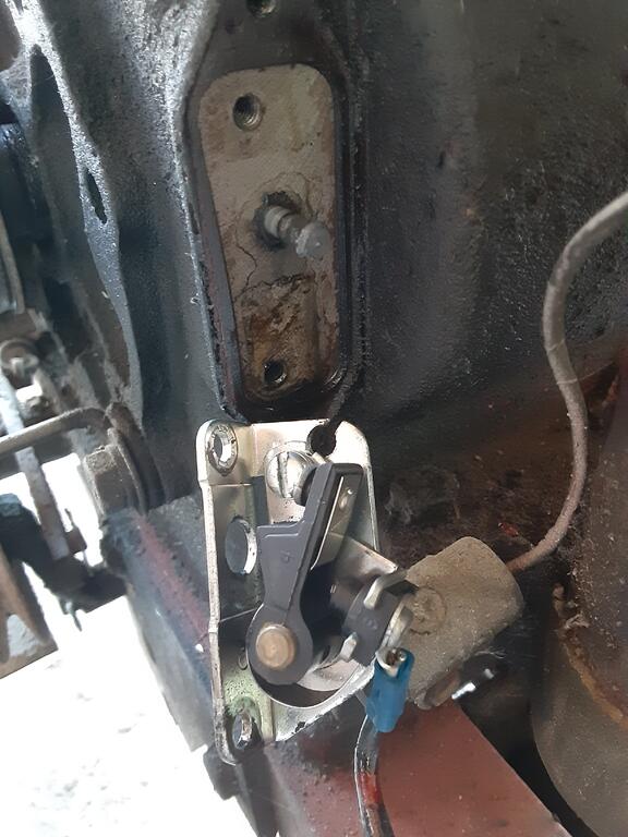

Jason Miller 24 #14 Posted March 10, 2021 Thanks Guys so much! I had some time this afternoon. Took off the points cover first oily and dirty so I cleaned. (Bad thing is half the gasket tore off so now I have a little gap on one side.) next took off the coil. Cleaned all the little prong connectors that go on top. I believe the + side had 2 and the - side had one. I wire brushed them real good. Then I took off the fuel line on the side of the carb. It’s a 1/2 inch bolt metal u shaped line that connects the carb to a small bowl. Lots of black dirt in both ends. I turned the key and fuel pumped out of the bottom . I put all back together and turned it over. Took a while but did fire and is running now although rough. Kept shutting off seemed like it wasn’t getting gas. Seems to have a miss. I’m thinking the carb maybe dirty?? Never had it off since I got this from my pap 8 years ago. Of course never needed too. jason 1 Share this post Link to post Share on other sites

Ed Kennell 47,809 #16 Posted March 10, 2021 Sounds good. You have fire. You can do it right and clean the carb, fuel pump, and fuel tank and replace all the fuel lines. Or, dump a can of Sea Foam in the tank and hope for the best. What does the air cleaner look like? If it shuts off after running for a few minutes, try running with the fuel tank cap off. The vent hole may be clogged. 1 Share this post Link to post Share on other sites

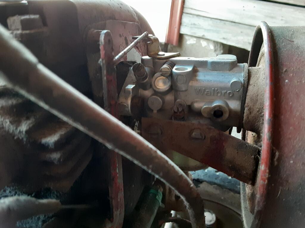

Jason Miller 24 #17 Posted March 11, 2021 So with the carb any suggestions? Is that the two bolts connecting the manifold? I have a small engine shop next door they have a machine they dip them into? Cleaner I assume. Fuel pump where is that located and how do I clean that? Filter and lines I replaced in the fall when the season was over. jason Share this post Link to post Share on other sites

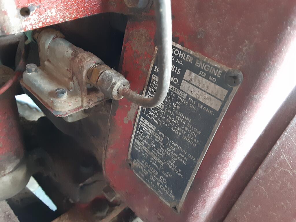

Ed Kennell 47,809 #18 Posted March 11, 2021 15 hours ago, Jason Miller said: t’s a 1/2 inch bolt metal u shaped line that connects the carb to a small bowl. Lots of black dirt in both ends. I turned the key and fuel pumped out of the bottom . This "U" shaped line connects the fuel pump to the carb. If you cleaned this line and had good fuel spurting when you cranked the engine, I would not mess with the fuel pump. Yes, the carb is bolted to the block by those two bolts. Take pictures of the choke and throttle linkage so you know how to reinstall the carb. If the machine shop is experienced in cleaning small engine carbs, then I would let them do it. 1 Share this post Link to post Share on other sites
Jason Miller 24 #19 Posted March 11, 2021 Thanks Ed I don’t have a choke cable it broke last year I need another one. What about the throttle linkage where is best to take that off? Will I need a new gasket when I put back on? Share this post Link to post Share on other sites
Ed Kennell 47,809 #20 Posted March 11, 2021 Take the throttle linkage loose at the carb. The carb gaskets usually come off without tearing, but if your machine shop works on small engines, they should have a new gasket. 1 Share this post Link to post Share on other sites
Jason Miller 24 #21 Posted March 13, 2021 Took off the carburetor today and headed it to the small engine shop. I did notice something this morning a puddle of gasoline dripping from the air cleaner? My gas tank was empty as well?? Would this be the carburetor issues? Share this post Link to post Share on other sites
Ed Kennell 47,809 #22 Posted March 13, 2021 Yes, the float is not shutting off the fuel in the bowl. The carb bowl overfills allowing fuel to flow out thru the air cleaner and drains the tank. Share this post Link to post Share on other sites
lynnmor 9,073 #23 Posted March 13, 2021 12 minutes ago, Jason Miller said: Took off the carburetor today and headed it to the small engine shop. I did notice something this morning a puddle of gasoline dripping from the air cleaner? My gas tank was empty as well?? Would this be the carburetor issues? If that gas overflow made its way into the engine, you better check the oil now. If there is any evidence like smell or higher oil level, don't take a chance. 1 Share this post Link to post Share on other sites
Jason Miller 24 #24 Posted March 14, 2021 I checked the oil looks good. I’m thinking it was drip out of the carburetor bowl. Not sure what that means. We’ll see when I get the carburetor back from the engine shop. He’s getting me a new air filter as well. Share this post Link to post Share on other sites
