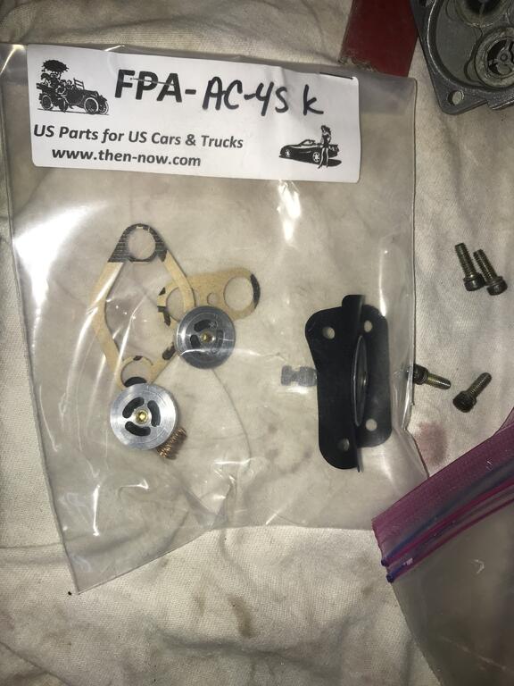

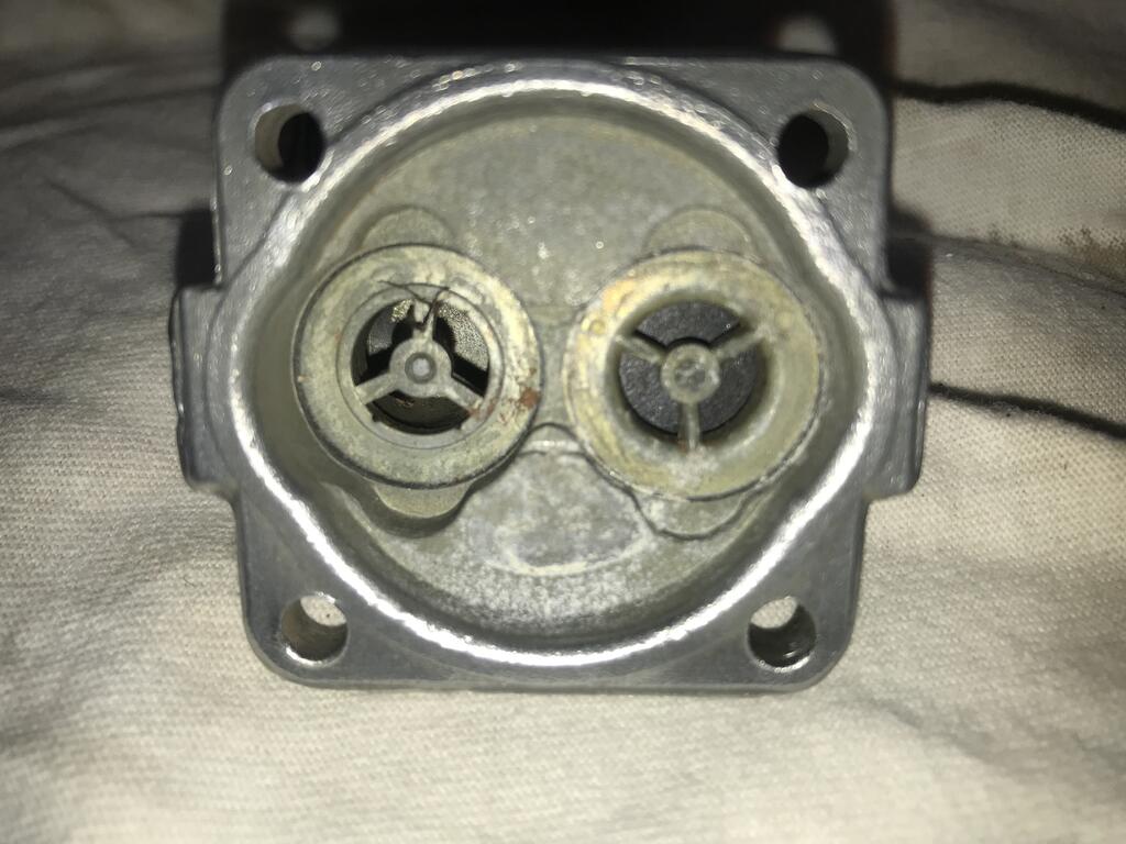

oliver2-44 11,816 #1 Posted March 9, 2021 How do I remove the round steel parts from this aluminum pump housing. If you enlarge the first picture you can see the disc inside the left side is broken or stuck at an angle. I have identical new ones from Then and Now Automotive to install 1 Share this post Link to post Share on other sites
rmaynard 17,642 #2 Posted March 9, 2021 Those are pressed in. They are made of pot-metal. If you pry them out, they will break. Does your kit include new press-in retainers to replace them? 1 Share this post Link to post Share on other sites
oliver2-44 11,816 #3 Posted March 9, 2021 @Maynard Yes the kit has new ones and I checked that they look the right size 1 Share this post Link to post Share on other sites
rmaynard 17,642 #4 Posted March 9, 2021 Looks like those will press right in where the others come out. I've done several of those. Share this post Link to post Share on other sites
953 nut 70,324 #5 Posted March 9, 2021 The one on the right should pop out if a little shot of air is applied to the threaded fitting on that side. The one on the left may need to be pried out with a small screwdriver. Probably a little corrosion holding them in place. Share this post Link to post Share on other sites
Gregor 4,848 #6 Posted March 13, 2021 (edited) Keep in mind, on each side there is an upside and a down side. An innie and an outtie so to speak. Pay attention to how they come out. At least that's the way mine was. There was also a small fiber washer under each one. They want to escape. Edited March 13, 2021 by Gregor Share this post Link to post Share on other sites
