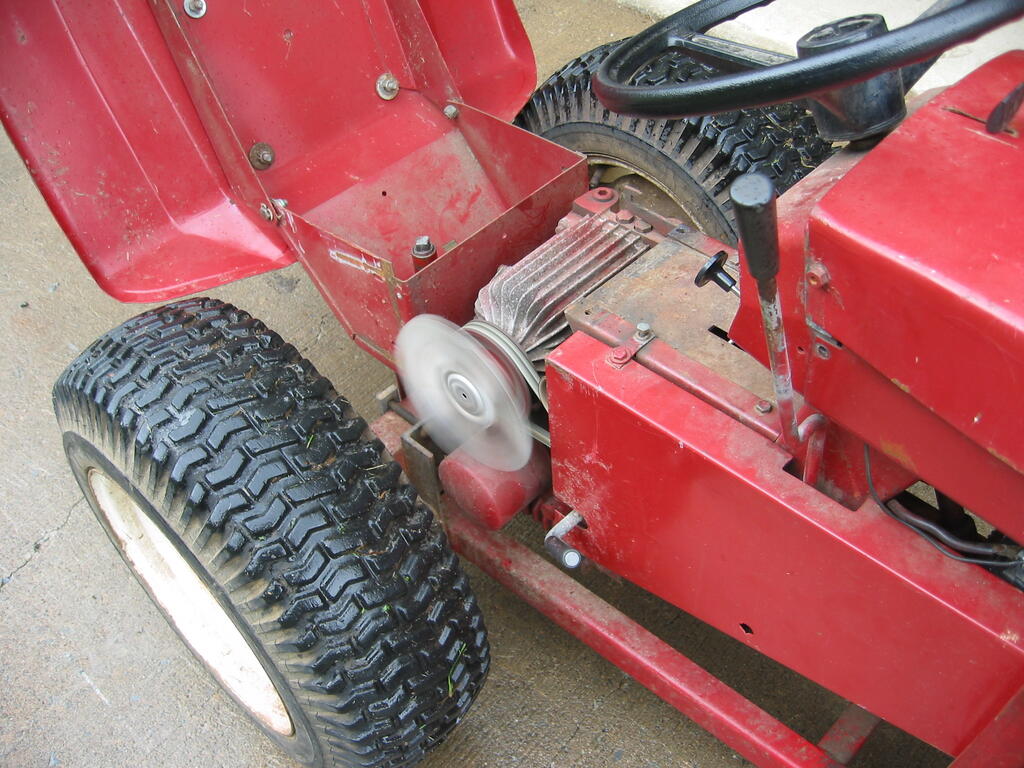

Gregor 4,848 #9 Posted March 15, 2021 Another question. On this transmission, starboard side, down low, there is a canister looking device. I have looked at the manuals, and through my book, but can't find an answer. Is this a filter, or another part of the trans? 1 Share this post Link to post Share on other sites
pfrederi 21,312 #10 Posted March 15, 2021 Is it the hydro filter? Just below the fan in this picture. Free rolling tow valve closed is not a good thing. Hope it was just too low on fluid. Wix 51410 Share this post Link to post Share on other sites
Gregor 4,848 #11 Posted March 15, 2021 Thanks I took it off hoping I would not regret it. Guess I don't ever remember seeing a cartridge filter with a Hex on top for a wrench before. I have been trying to clean it up to get the #, but to no avail. Thank You for the # Share this post Link to post Share on other sites

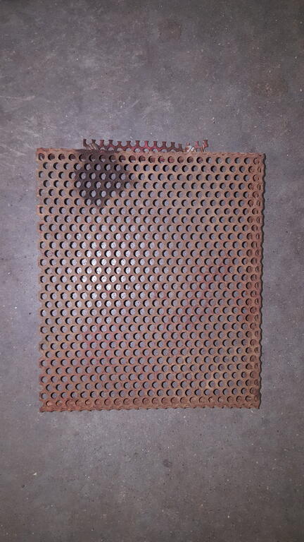

Pullstart 71,522 #14 Posted March 15, 2021 26 minutes ago, pfrederi said: Is it the hydro filter? Just below the fan in this picture. Free rolling tow valve closed is not a good thing. Hope it was just too low on fluid. Wix 51410 Let’s talk cooling. Should that fan have a shroud? Does it not get that hot if it’s kept clean? Does it still blow air across the pump regardless? Share this post Link to post Share on other sites

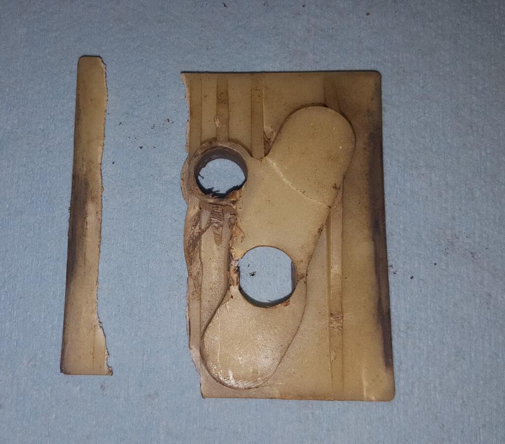

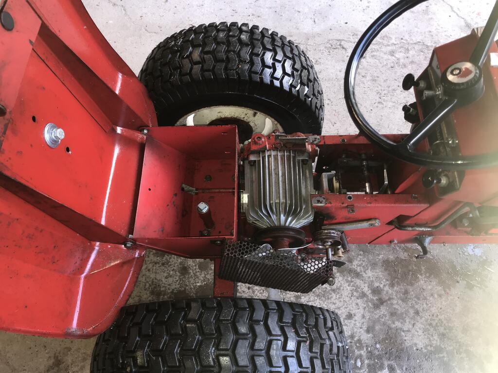

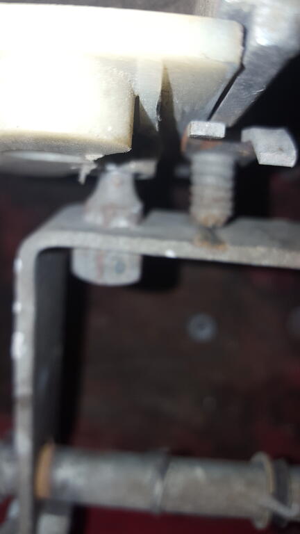

Gregor 4,848 #15 Posted March 15, 2021 I didn't want to start on this yet, as I have a project from last fall I need to finish, but the weather is suppose to be rotten all week, soooooo. It's amazing once you get a rattle gun in your hands, just how fast you can turn a complete tractor into a pile of parts. Another one of those impossible to remove steering wheels. Removed the roll pin, it came right off. Score one for me.The shift linkage looks like it needs some serious attention.I don't imagine that screw is suppose to be rubbing on that lever. The spring on it is compressed as far as it can be. Maybe it's the wrong spring, screw, or both. Don't know. I left things in tact enough to test the trans, once I get a filter and fluid. This is what my tractor has (had) for a fan shroud. I would like to take it outside for a power washing. Right now it's about 32F, windy, sleet, and miserable, so that's not gonna happen. I hate it when you smash your finger first thing in the morning. It's sore and tender all day, and you just don't want to touch anything ! 2 Share this post Link to post Share on other sites
squonk 48,339 #16 Posted March 15, 2021 Fan shroud/screen hanging loose on my 1075 Share this post Link to post Share on other sites
pfrederi 21,312 #17 Posted March 15, 2021 Shrouds...We don't need no stinking shrouds!! Share this post Link to post Share on other sites

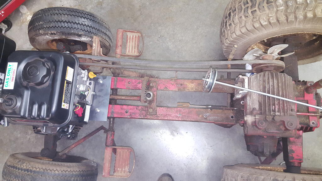

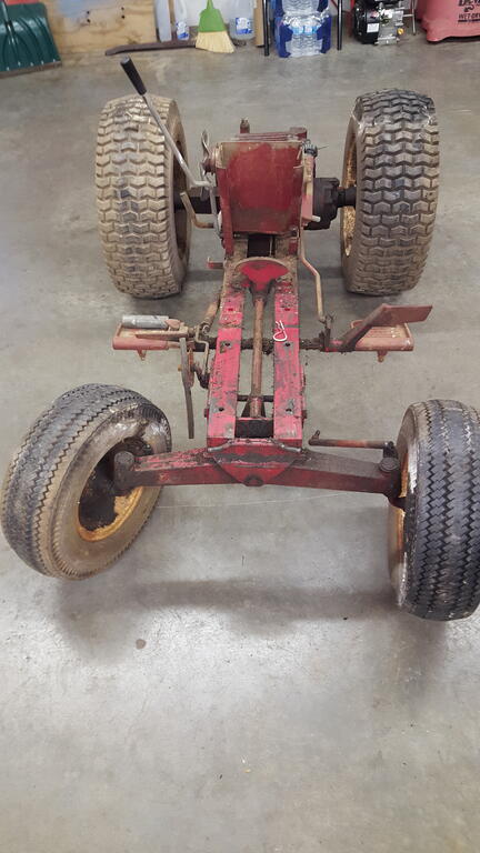

Gregor 4,848 #18 Posted March 15, 2021 After a couple of honey-do jobs, and running after supplies, I got the Predator temporarily mounted on the 876. Replaced trans filter, and filled with new fluid. 4 qts. as per book. Put the back end on jack stands. Made my self a hand held belt tensioner, which you will probably not find in Osha's book of approved tools and gadgets, but it worked. Started the motor. The wheels go forward and backward. Now, with the motor off, if you try to roll the wheels in the same direction, they do not move easily. I don't know how it will do under a real load, but I am taking all this as a good sign, and proceeding as if the trans is ok. If it's not, I will worry about that at a later date. The oil still does not register on the dipstick. Should I add more? I don't know when or how I did this, but I broke the cam. Had to shift it with a screwdriver, so I just took all that stuff off, out of my way. I will have to order a new cam. There was only one spring on the cam tension plates. It looks like someone cut down a spring and ground on it, to make it fit. I will have to figure out what it is suppose to be, and make some, or order some. So far I have not found a source for these.I have a lot of parts and pieces to take either to the media blaster, or the acid dipper. Anyone have a preference on blasting over dipping? Or vice versa? Very little deep rust, so I am not afraid of the dipping eating anything away.. Thanks Greg Share this post Link to post Share on other sites
Jeff-C175 7,211 #19 Posted March 15, 2021 (edited) 1 hour ago, Gregor said: There was only one spring on the cam tension plates. I don't think there should be ANY springs there. [edit: nope... wrong. The manual for your machine DOES show springs on there. Interesting that the 1980 that I have does NOT have springs. Wonder why they changed?] There should be a On my 175 there is a 'special washer' between the hold down and the housing to give the space for the cam actuator, then the screws should be 8-32 with a lock washer. Parts book says 1/2" long. Looks to me like someone lost the original screws, didn't have one short enough, didn't own a screw cutter, and used that spring as a 'spacer', same with the nut under the head of the other screw. The brackets appear to be all outta shape and bent up too. Edited March 15, 2021 by Jeff-C175 Share this post Link to post Share on other sites
Gregor 4,848 #20 Posted March 15, 2021 IDK I'm just going by the pictures Share this post Link to post Share on other sites

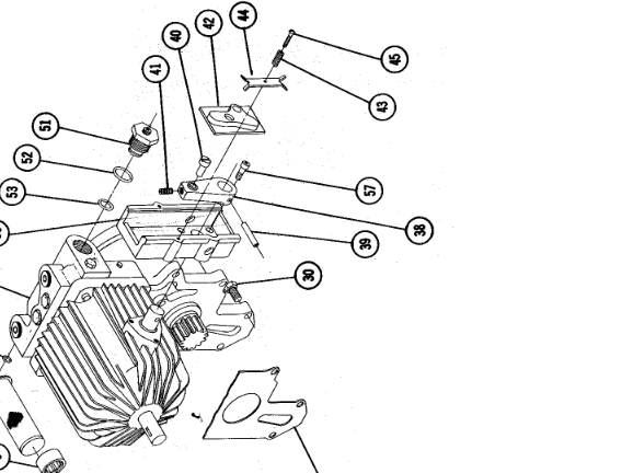

Jeff-C175 7,211 #21 Posted March 15, 2021 (edited) 8 minutes ago, Gregor said: I'm just going by the pictures I first grabbed the hard copy manual for my 1980 C175 and there are no springs. It shows the screw, a lock washer, the bracket #44 in your diagram, the 'special washer' #9 I mentioned, then that sandwiches the cam actuator plate. They changed it... don't know why... maybe the springs squashing the edge of the actuator wore it out too fast? Edited March 15, 2021 by Jeff-C175 Share this post Link to post Share on other sites
Gregor 4,848 #22 Posted March 15, 2021 Maybe I don't need no stinkin' spring! 1 Share this post Link to post Share on other sites
Jeff-C175 7,211 #23 Posted March 15, 2021 Just now, Gregor said: Maybe I don't need no stinkin' spring! Maybe not! but you would need the 'special washer', which I am presuming is just a tad thicker than the flange of the actuator plate. Share this post Link to post Share on other sites
Jeff-C175 7,211 #24 Posted March 15, 2021 1 hour ago, Gregor said: I don't know when or how I did this I don't think you did it. Probably that way when you got it. Share this post Link to post Share on other sites
Gregor 4,848 #25 Posted March 15, 2021 6 minutes ago, Jeff-C175 said: I don't think you did it. Probably that way when you got it. I wish I could say it was, but it wasn't. I just looked at your diagram on line. Maybe all I need is a fiber, or cupped washer. I could not find a description of it Share this post Link to post Share on other sites
