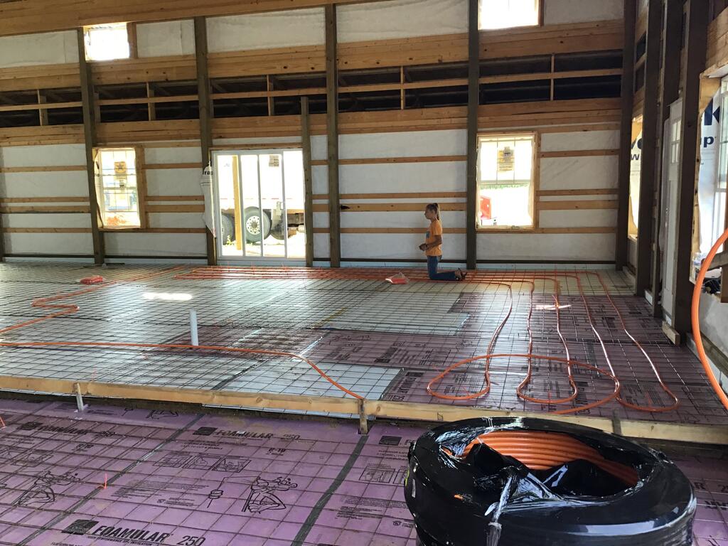

Pullstart 71,325 #38 Posted March 8, 2021 5 hours ago, Shed said: Just got price quate back from diy company 3000 bucks for a two zone 3 loop system from heat exchanger to pex that's really pushing budget for the few times I'm in the garage during winter. That's not including 1000 for foam board or line from stove and another pump I'd be almost 4500 to 5000 if I went to radiant. Or do I just buy another modine and have two modine heaters the other thing is like someone said I will need to run an antifreeze in the system or leave it run 24/7 or run the stove water 24/7 to heat exchanger and then run antifreeze in the modines to many choices never enough money. Leave no room to finish my 1960 suburban which is why we all are here to start Can you do any of the work yourself? We did it in my In-law’s barndominium project last year. It works great! 1 1 Share this post Link to post Share on other sites
