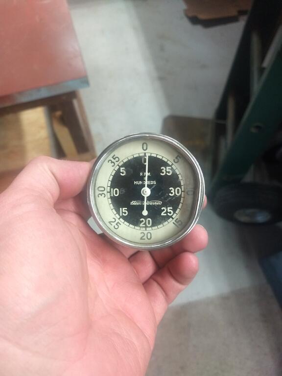

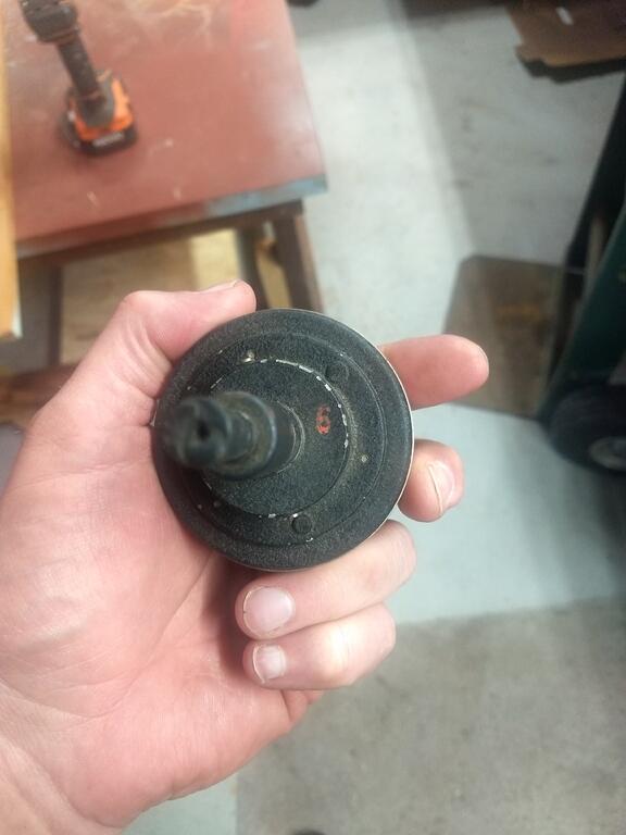

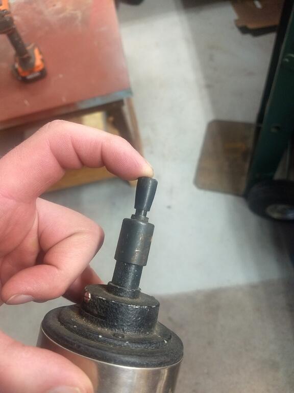

ebinmaine 74,572 #1 Posted March 7, 2021 Bought this off the fleabay with a couple other things because I was curious to see how it works. The part at the back where my finger is touching does turn. Any thoughts? Share this post Link to post Share on other sites
gwest_ca-(File Mod) 11,741 #2 Posted March 7, 2021 It comes with rubber tips that are concave, flat and pointed to suit the end of a shaft. Electric motors usually have a drilled center point that the pointed tip fits in. Bought one new in the 70's and very accurate when compared with a digital tach. https://www.google.ca/search?ei=xWNFYPO6CNvj5NoPx42ToAc&q=stewart+warner+tachometer+757-w&oq=stewart+warner+tachometer+&gs_lcp=Cgdnd3Mtd2l6EAEYAzICCAAyAggAMgIIADICCAAyBggAEBYQHjIGCAAQFhAeMgYIABAWEB4yBggAEBYQHjIGCAAQFhAeMgYIABAWEB46BwgAELADEEM6BQgAELADOgkIABCwAxAHEB5QnCpYnCpgolFoAXAAeACAAckBiAHBApIBBTAuMS4xmAEAoAEBqgEHZ3dzLXdpesgBCsABAQ&sclient=gws-wiz Garry 1 1 Share this post Link to post Share on other sites
DennisThornton 4,771 #3 Posted March 7, 2021 Really handy if you can get to the center of a rotating shaft on anything. 1 Share this post Link to post Share on other sites
WHX?? 52,899 #4 Posted March 8, 2021 (edited) Be real handy for setting idle & 3600 rpms . Better than those pos digital ones I keep gettin. Edited March 8, 2021 by WHX24 1 Share this post Link to post Share on other sites

JoeM 8,899 #8 Posted March 8, 2021 Fitts a wheel horse of course. take off the flywheel screen and hold it against the center of the rotating crank shaft. May want to widdle that rubber a little to kind of a point with a chamfer. 1 Share this post Link to post Share on other sites
