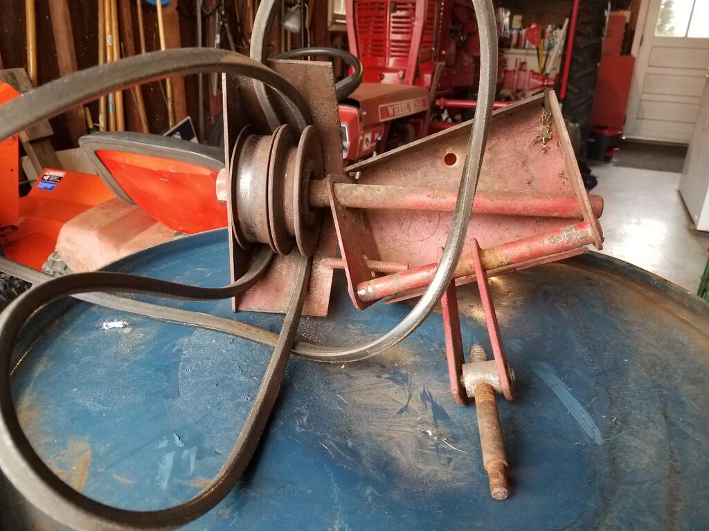

Inspectorjoe 473 #30 Posted March 18, 2021 8 hours ago, DennisThornton said: Snug fit but I've done that too! Had to let some air out of the rears though. Details on the front weight? I'm picking up a 314 H soon. I'm going to have to let some air out of the tires for its steering wheel to clear the hatch opening. That does look like a front weight. It's actually the mule drive for that '73 14HP no name. 1 Share this post Link to post Share on other sites

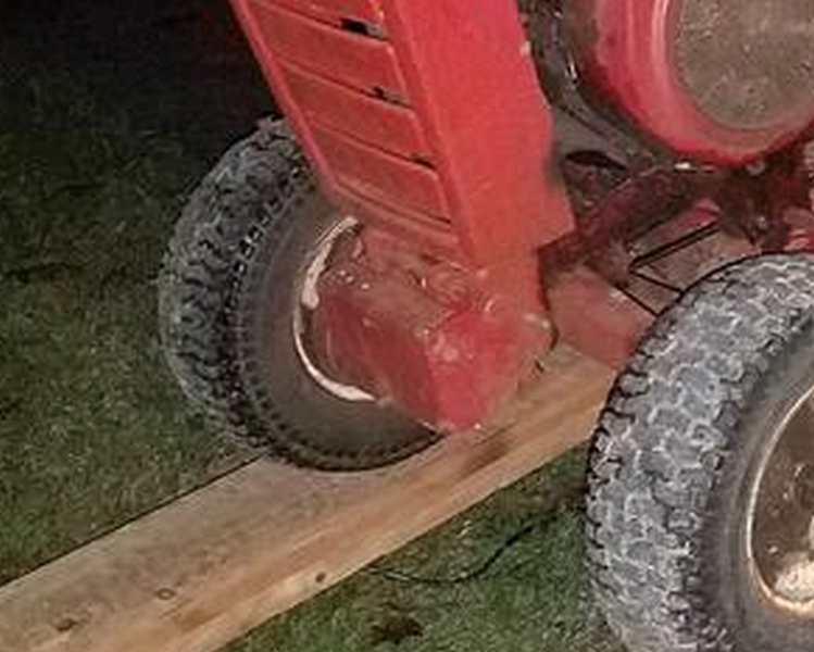

Inspectorjoe 473 #33 Posted March 18, 2021 2 hours ago, Gregor said: If I wanted to die, I couldn't think of a faster way to do it, than telling my wife, I am putting a tractor in the back of your van. Did you see the picture of the one being unloaded in the dark? I waited until around midnight to take it out. There was a reason for that! 2 3 Share this post Link to post Share on other sites

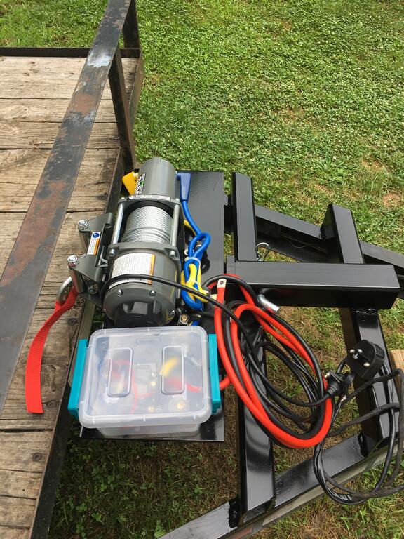

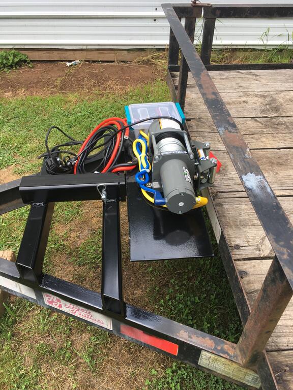

Mike in NC 342 #34 Posted March 19, 2021 I have hauled a couple in the back of my minivan, but the height is too short for most. Here is my winch set-up. 7 Share this post Link to post Share on other sites
Inspectorjoe 473 #35 Posted March 19, 2021 1 hour ago, Mike in NC said: I have hauled a couple in the back of my minivan, but the height is too short for most. Here is my winch set-up. I have 39" of clearance at the hatch opening. Most older WH's fit. If not, letting the air out of the tires gives me a few more inches. Nice winch setup! Mine isn't a permanent installation, but it works pretty well. The last time I used it, I wished I could also winch the tractor out of the van. Last December 30, I drove about 75 miles to pick up a 1968 Case 150 that I had bought sight unseen at an online auction. I wasn't feeling too well that day. The tractor had been sitting in a semi-open shed for a good 10 years. All the tires were flat. The winch pulled it up into the van beautifully. The problem came when it was time to unload. By the time I got home, I was feeling awful, but I had to get it out of the van and hidden before my wife got home from work at 11:50 pm. The tractor weighed 705 pounds, and with the flat tires, I couldn't budge it. I decided to drive the van up onto the ramps I use to change the oil, figuring that the incline it would provide would give me a little gravity boost. I've driven up those ramps more than a dozen times, but that night, I went up and drove right off of the right one. Ouch. Did I mention I was felling crappy? I tried it again (successfully) and it was enough to allow me to push it out the back. I walked it down the ramp and got it hidden. When I didn't get better in a few days, I got a covid-19 test and it came back positive. Of course, I wouldn't have gone to pick up the tractor if I had known I was covid-19 positive. I only had the Case for about two months, then I decided to sell it. It's ride out was definitely done in more style than the ride in. I never met the buyer, who also bought it sight unseen He lived about 90 miles away. He said he'd send a truck to pick it up. I can't imagine what it cost him to have this rig make a 180 mile round trip. It was fun loading it, and a heck of a lot easier than when I put it in the van. The driver slid the bed back and tilted it. I drove it up and he returned the bed back to horizontal. 3 Share this post Link to post Share on other sites

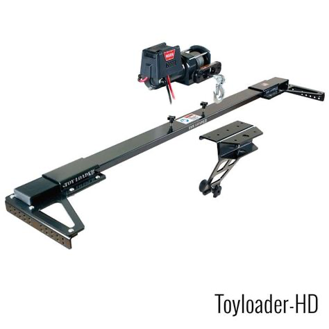

SylvanLakeWH 31,723 #37 Posted March 19, 2021 Don't have one, but this is the concept... Share this post Link to post Share on other sites

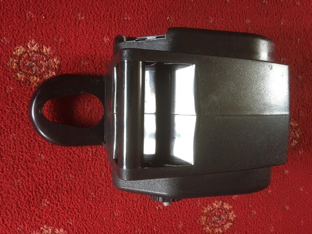

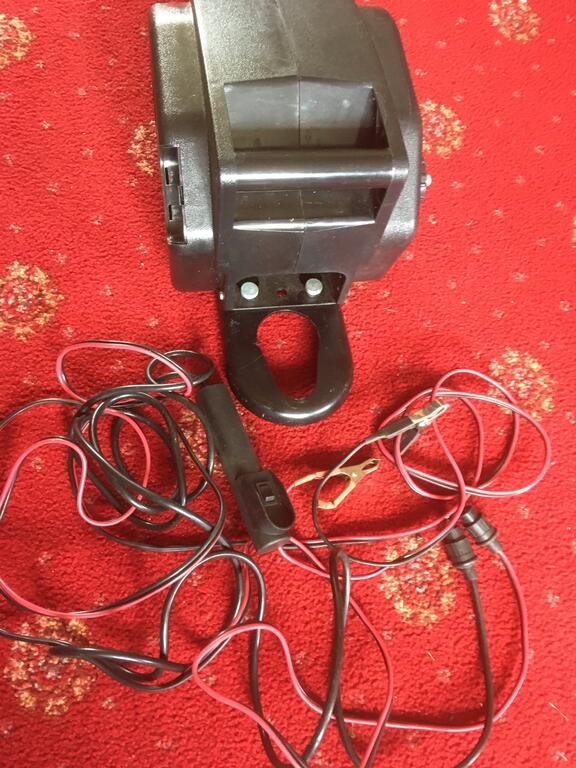

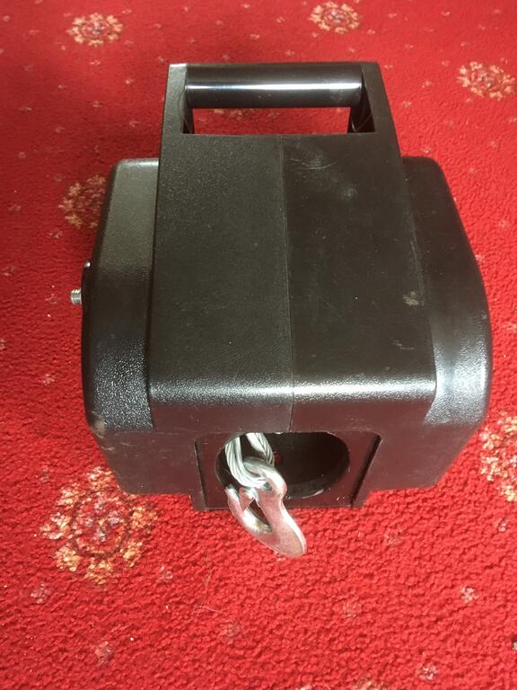

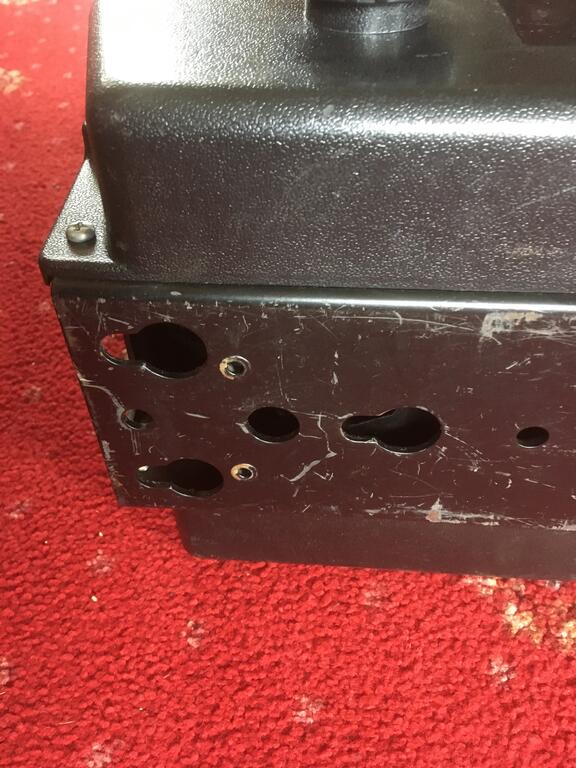

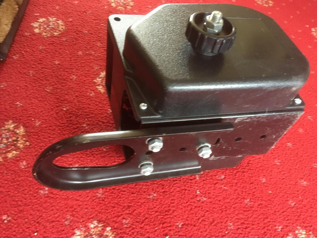

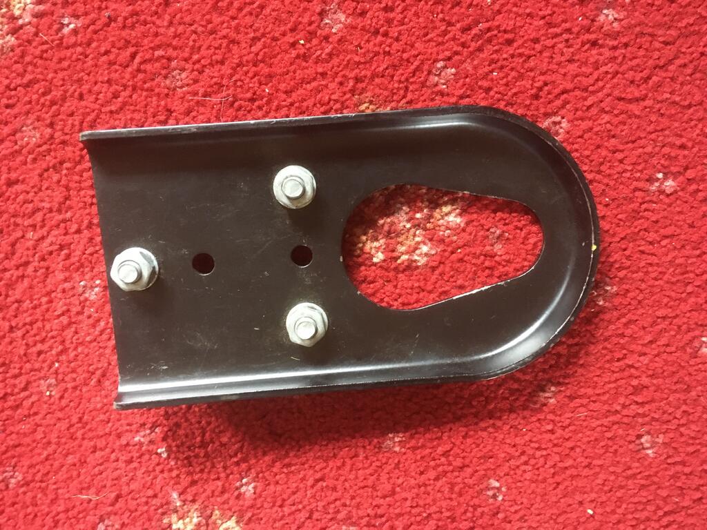

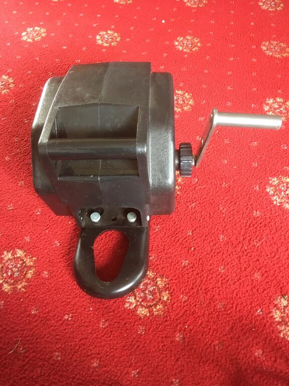

ranger 1,855 #38 Posted March 19, 2021 (edited) On 3/19/2021 at 2:31 AM, haydendavid380 said: Do you guys have any ideas for a non permanent way to have a winch in the front of the truck bed? I have a 12v winch which has a plate that ‘clips’ onto the winch casing and has a ‘teardrop’ shape hole that allows it to fit over a tow ball. (Photos to follow). It makes for a quick detachable winch unit that fits wherever you have a towball fitted, rear of truck, front of truck, or on the front of your truck bed or trailer. I’ve seen them on recovery truck beds for securing the couplings of caravans/trailers for recovery/delivery purposes. Photos of winch as promised. As you can see, the plate clips onto the winch, then the whole lot hooks onto the towball. Edited March 25, 2021 by ranger 1 Share this post Link to post Share on other sites
Mike in NC 342 #39 Posted March 19, 2021 10 hours ago, Inspectorjoe said: Nice winch setup! Mine isn't a permanent installation, but it works pretty well. Mine is not permanent either. It is removable, pull the pin and slide it out. It is setup to be used with a 2" receiver. The electronics are inside the plastic box to keep it watertight. I have used it during hunting season to recover deer. 1 Share this post Link to post Share on other sites

Mike in NC 342 #41 Posted March 19, 2021 3 hours ago, haydendavid380 said: What do you do for power? Throw a batter on the trailer tongue or did you run it back from the vehicle? I mounted a battery box on the cross bars on the trailer tongue, and use a spare battery to power it. If I use it not on the trailer, I take a battery with me to power it. Share this post Link to post Share on other sites
ranger 1,855 #42 Posted March 25, 2021 On 3/19/2021 at 9:17 AM, ranger said: I have a 12v winch which has a plate that ‘clips’ onto the winch casing and has a ‘teardrop’ shape hole that allows it to fit over a tow ball. (Photos to follow). It makes for a quick detachable winch unit that fits wherever you have a towball fitted, rear of truck, front of truck, or on the front of your truck bed or trailer. I’ve seen them on recovery truck beds for securing the couplings of caravans/trailers for recovery/delivery purposes. Photos of winch as promised. As you can see, the plate clips onto the winch, then the whole lot hooks onto the towball. Share this post Link to post Share on other sites
