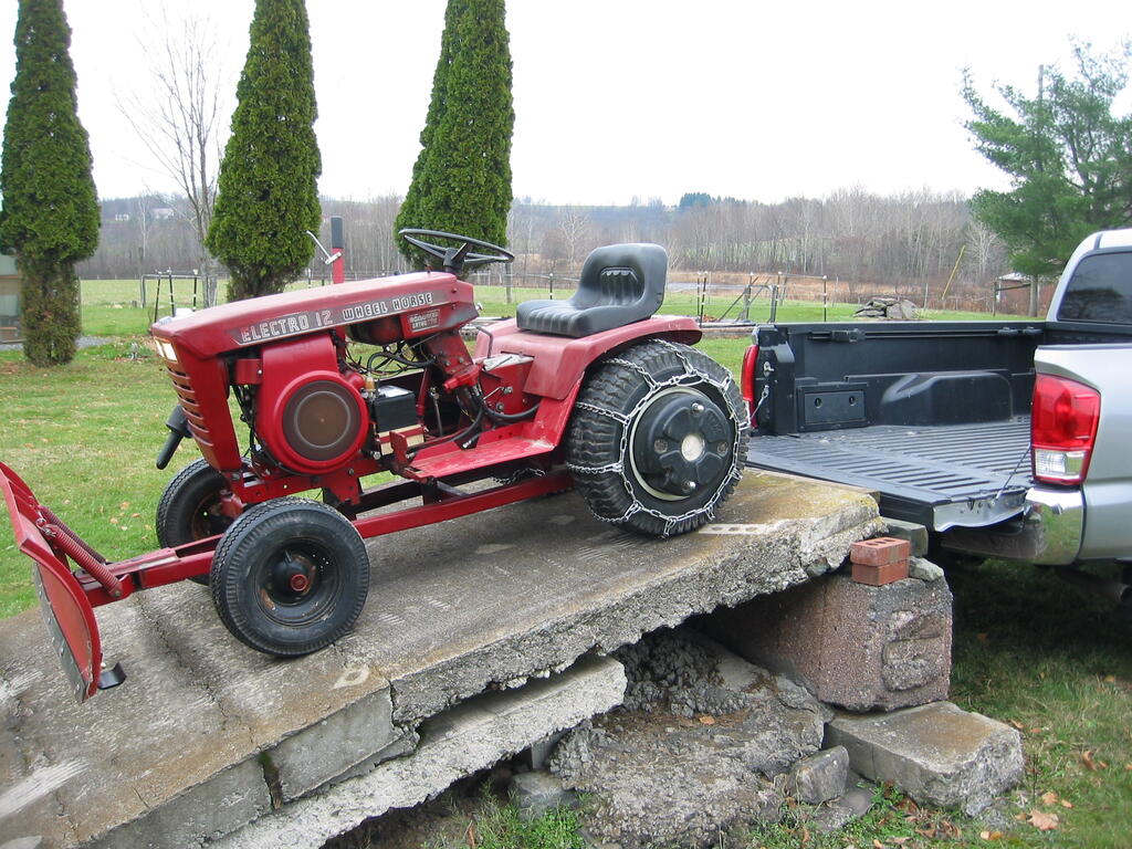

Lee1977 7,809 #12 Posted March 8, 2021 (edited) Here is what you need. Here is what I have. It's only up about 18". Got it setting in a low place. Edited March 8, 2021 by Lee1977 2 1 Share this post Link to post Share on other sites

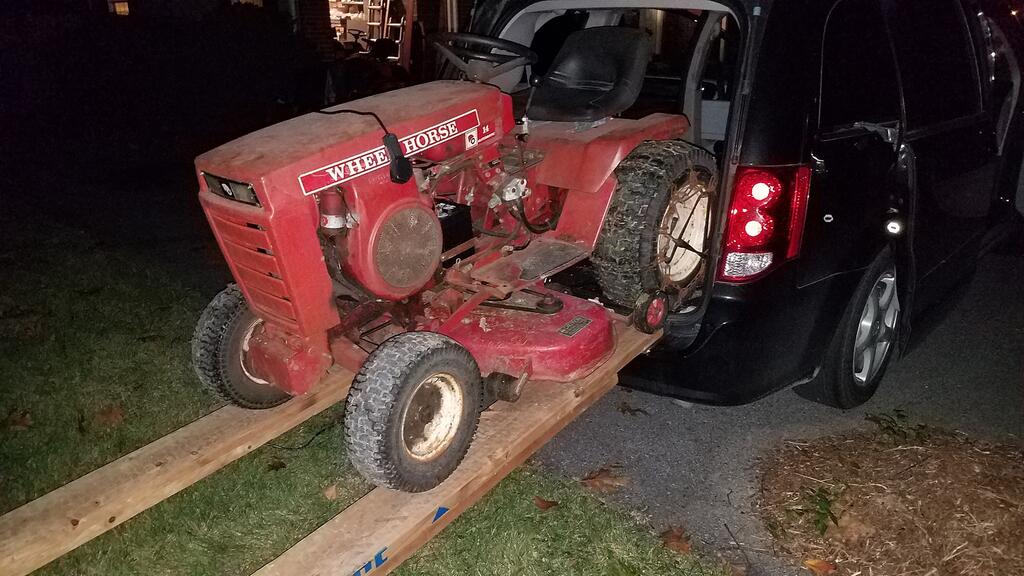

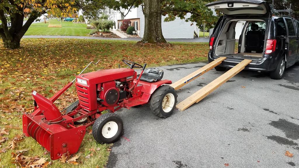

Inspectorjoe 473 #22 Posted March 18, 2021 I move tractors with my minivan (don't laugh), so I have the advantage of a bed height that's lower than that of a pickup's. Another advantage I have is my homemade ramps are 10 feet long. Most tractors I can push up myself. With heavier tractors, I anchors an electric winch in front of the door pillars. 4 3 Share this post Link to post Share on other sites
rjg854 13,422 #23 Posted March 18, 2021 That looks like trying to put 10 lbs in a 5 lb bag. 1 3 Share this post Link to post Share on other sites
DennisThornton 4,773 #24 Posted March 18, 2021 5 hours ago, Inspectorjoe said: I move tractors with my minivan (don't laugh), so I have the advantage of a bed height that's lower than that of a pickup's. Another advantage I have is my homemade ramps are 10 feet long. Most tractors I can push up myself. With heavier tractors, I anchors an electric winch in front of the door pillars. Snug fit but I've done that too! Had to let some air out of the rears though. Details on the front weight? 1 Share this post Link to post Share on other sites
haydendavid380 759 #25 Posted March 18, 2021 1 hour ago, rjg854 said: That looks like trying to put 10 lbs in a 5 lb bag. If it fits, it ships 1 Share this post Link to post Share on other sites
