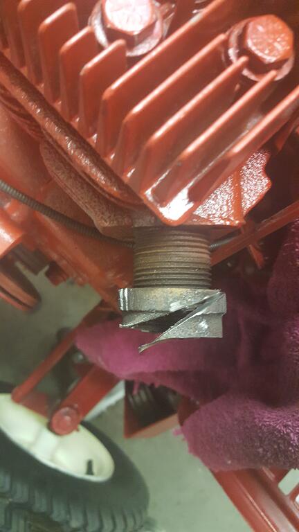

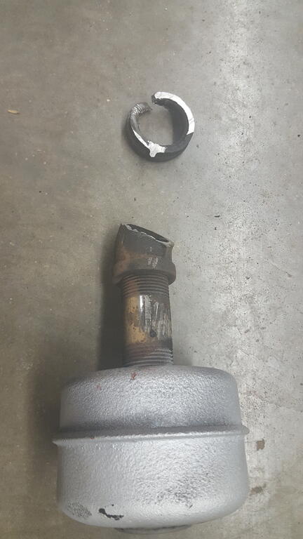

Gregor 4,848 #40 Posted March 8, 2021 A cut off wheel on my small side grinder made pretty short work of those stuck on pipe fittings. Only on by a few threads, but they were very determined threads. 1 Share this post Link to post Share on other sites
