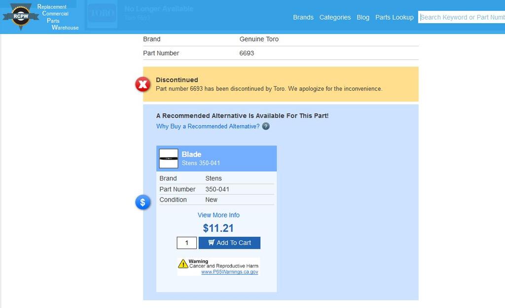

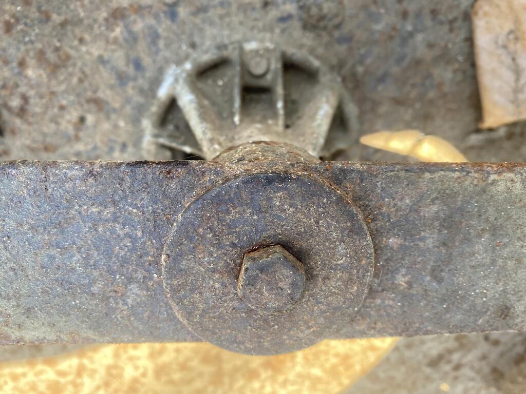

55reasons 171 #1 Posted March 6, 2021 So my center blade decided to take a trip by itself. Went to TORO and this dealer has actually been really good with me thus far. Some of the guys there were there when this thing was brand new on their showroom floor. Anyway, everything is discontinued and the superseded parts require updated washers etc., that are also unavailable. Specifically, the bottom washer with the “teeth” the top washer, the bolts, and the blades are all unavailable. I walked out with a set of blades, but they don’t have the dimples, etc like the originals. What’s the magic fix for this? Share this post Link to post Share on other sites

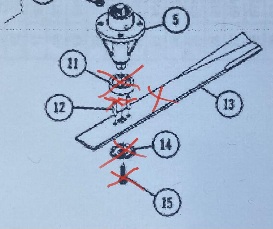

55reasons 171 #4 Posted March 6, 2021 Everything with a red “X” is unavailable. What’s the common fix here? Share this post Link to post Share on other sites

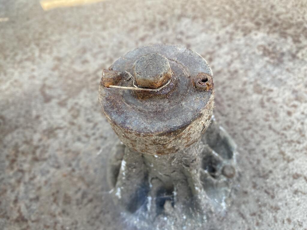

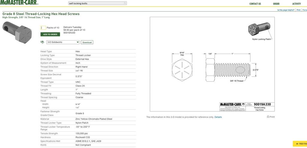

pfrederi 21,222 #5 Posted March 6, 2021 (edited) You can drive the broken pins out of the spindle hub and put in new roll pins. There is an after market blade Bolt you could use one of the self locking ones from McMasters (or use locktite) Check this link for some renovations Edited March 6, 2021 by pfrederi 1 Share this post Link to post Share on other sites

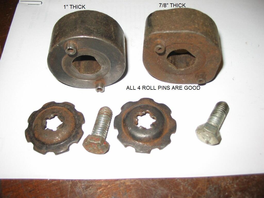

daveoman1966 3,884 #9 Posted March 6, 2021 (edited) I have some useable parts...11 (with dowels #12) dome washer 14 and bolt 15. Probably have the blade 13 as well....what is it's length??? my direct email is: daveoman@windstream.net Edited March 7, 2021 by daveoman1966 3 1 Share this post Link to post Share on other sites
